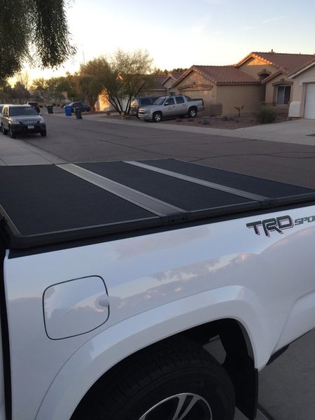

    Extang 2.0 solid trifold cover.

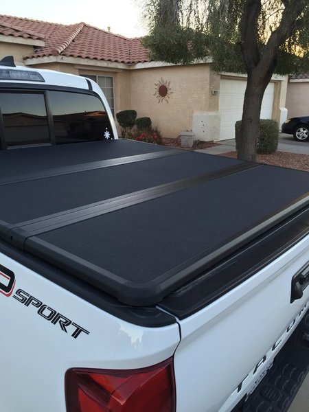

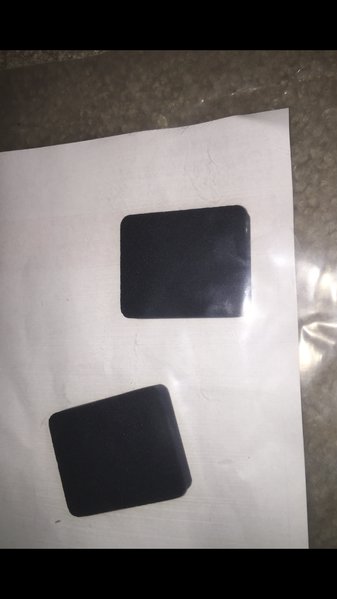

    Is this it? That and the metal bracket/screws is all i got with the Tonneau.
    Nothin else needed?

    That's it. #30 torx for the cab rail (careful, they're proud of how they installed it - it's tight), install the brackets, and get the cover carefully aligned before turning the screws. You'll find that you gotta get it juuuust right to keep the water out. Don't tighten too much or you create gaps at the joints.
    I did clean everything with a soap/alcohol mixture first before putting on the seals.
    If I remember, the brackets even came with an Allen wrench.

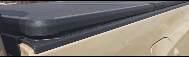

    Installed the tonneau yesterday, along with the seals. Thought it was for tail side but it was for the bar near cab and bed.
    Looks great, my only q's is how much to tighten, it does say 2 turns after making contacts, otherwise may deform the panel.

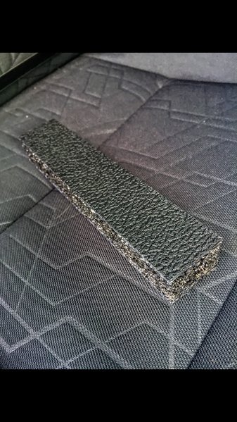

    So they included 2 of these cut outs, i take it its just to show us the insides?

    I got the same pieces of foam. I agree and guess they want to show is what its constructed of. I like the contruction of this cover. It looks like it can stand the heat because of the foam insulation. and the hard plastic looks like it can take a nice beating from weather like snow and hail without cracking.

    Pics of the tonneau near the cab.
    Its on there tight, cant lift it up with my fingers but visually it doesnt look level.
    Should i tighten it more?

    Something wrong with that install... should NOT look like that..

    It looks like that because the bed rail on the cab is higher than the side bed rails.
