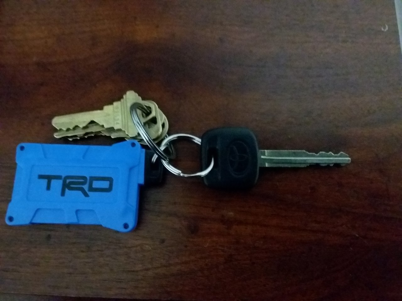

    This is what my tailgate key looks like. I also called Extang because I had concerns about it not coding. Guy walked me thru the process right there on the phone. But since I don't know what the key for 2018 Pro looks like, you may have to just get another key cut to use. Or install a pop n lock that will unlock with the keyfob just like the doors do. Sorry if I was not much help.

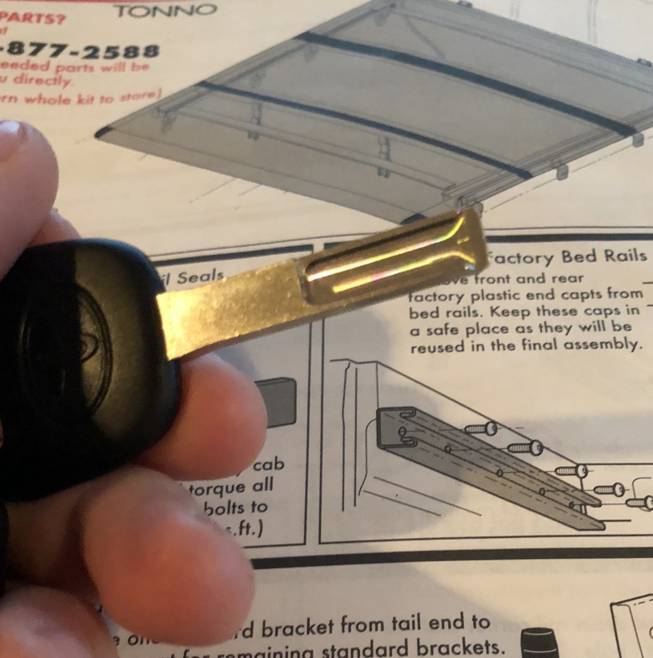

    Ah, yes, it's different. Here's what mine looks like.. that explains it. Thanks guys

    Yes that seperate tailgate key should be keyed the same as the one inside your fob which is a funky key to say the least. I would just go to a lock and safe place ask the guy to make you a random hillman #35 key(toyota) and that will work in your cover. The hillman 35 is the same as the 2016 tacoma key and older ignition keys. Get a couple copies...
