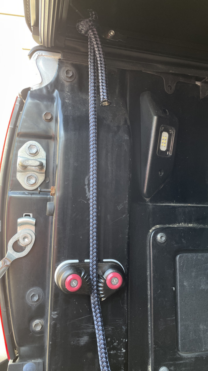

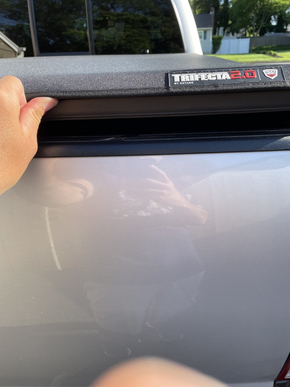

    Hey TW I just wanted to share my experience with the Extang trifecta 2.0 signature series. So first off the cover is great the canvas top is really nice and classy looking. But this cover has a design flaw at the tailgate.when closed you can lift the cover up about a half inch or so and peek in to the bed. So after adjusting the clamps and trying to minimize the gap i cam up with an idea and it works pretty well and it’s very simple and easy to use. So I bought some cam cleats for a single rope and I tied the rope to the back corners of frame and the pull down on corners and hold the rope with the cam cleat. Got the cleats of Amazon and some rope from the depot. After tightening down now the cover cannot be lifted to look it.29CE8FDC-80B1-4B28-B22F-23B9C8C8CAC7.jpgFE6AD16A-5143-45A7-B555-BFD2E5011520.jpg5A61A4FE-309C-4027-A662-63B2B6823881.jpg
