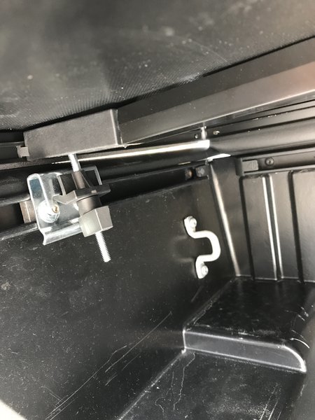

    First post. I'm installing a Extang trifecta on my 2013 Tacoma and having some issues with the clamp straps interfering with brackets before they can tighten down. I've called the tech line at Extang and sent photos and an explanation of the problem. They have replaced the straps with a different style but still don't work. Anyone else have a problem with these? Am I just being stupid? I wanted just a simple install, now it looks like I'll be designing my own brackets at work on Monday. Here's a photo also. Thanks for any help IMG_1089.jpg

    The t-handle unit where it slides in the channel should be slid as far to the outside as possible. This will allow just the outer most lip to catch the bracket.
    The T-handle will point down but towards the middle of the truck bed.

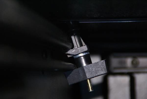

    These pics are a little different but should give an idea.

    Thanks for the answer. I was trying to install them perpendicularly to the cover. Did you crank them down and did the front seal seal?

    Yes the front sealed well. They crank down quite far.

    wow! I am currently waiting for a credit from gatorcovers from a trifold I am returning to them because it fit horribly and the front clamp stripped out on installation (cheap plastic). The front of the gatorcover couldnt be tightened enough to seal the front corners and the "T" bar hit the rail bracket when tightening, even worse than your pic (mine had no spacer).
    I was going to upgrade to the Extang trifecta but it looks like extang manufactures the gatorcovers (the return label they sent says extang) and based on this pic they use that same bracket.
