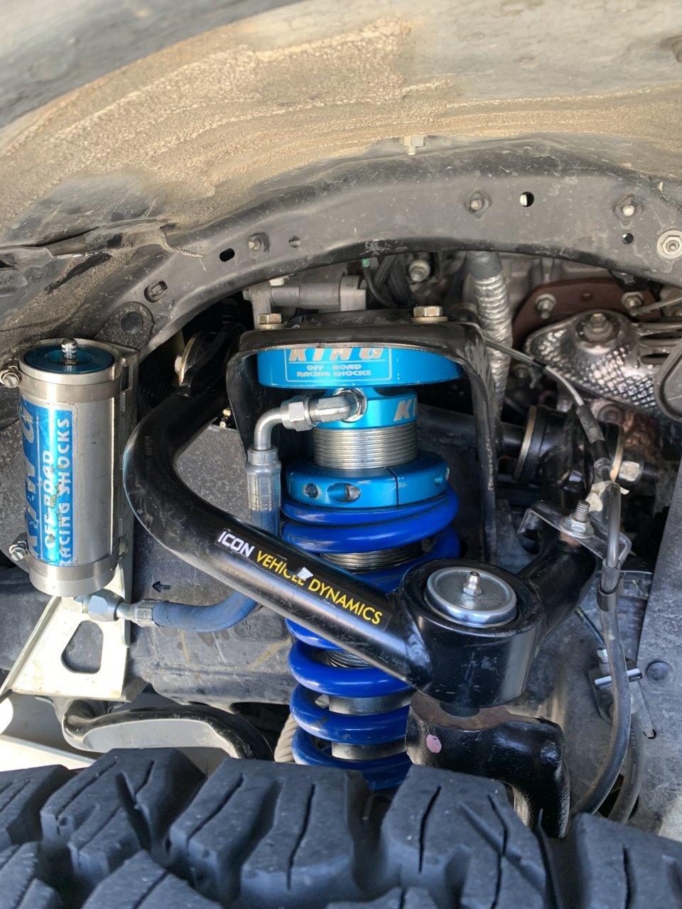

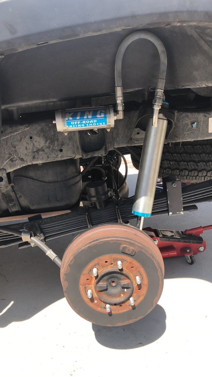

    Hey fam, wanted to know how bad do I need extended brake lines. I have extended kings with icon tubular with deltas and the rears are 1.5 inch longer Kings with medium Dakars. F36D0988-226F-4983-B7D9-3CC9A4C37C1E.jpg8910F970-F7A6-49CA-9DA7-7E7C4092E9D5.jpg

    Don’t need them at all.

    If at full droop (truck jacked up) your brake lines aren't pulled tight, you're fine with stock length.

    Extended rod

    If you do get extended brake lines, I'd recommend picking up speed bleeders. They are awesome
