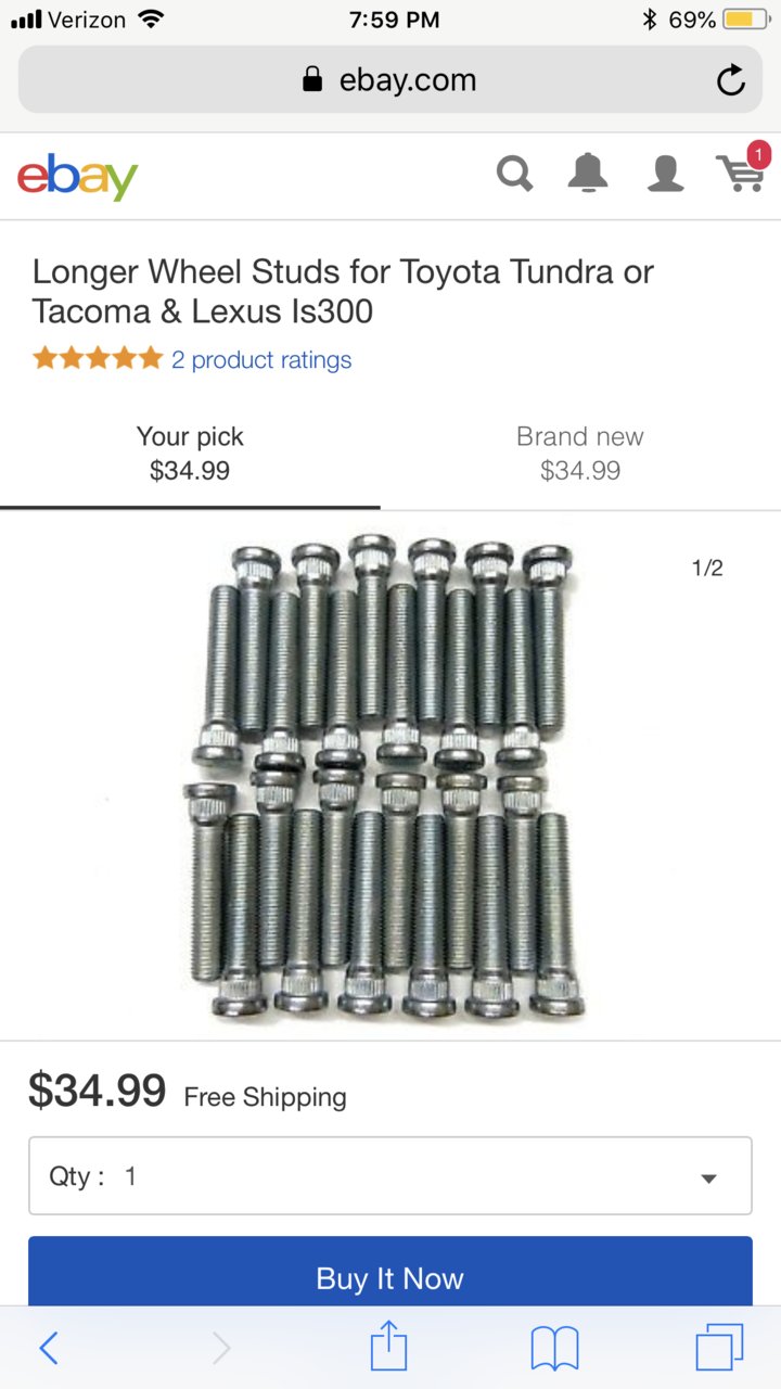

    Here you go

    are these the 44mm studs or do you need to cut them to fit ?

    They are the same studs I posted a screenshot off that eBay page

    thanks to all yawl,ive ordered a set from fearless freds out in CA.it was 63.99$ and free shipping...ill be sure to let yuns know how these work out and ill even try to post some pics if i learn more about using the site ! hehe
