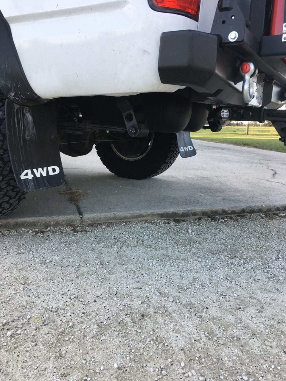

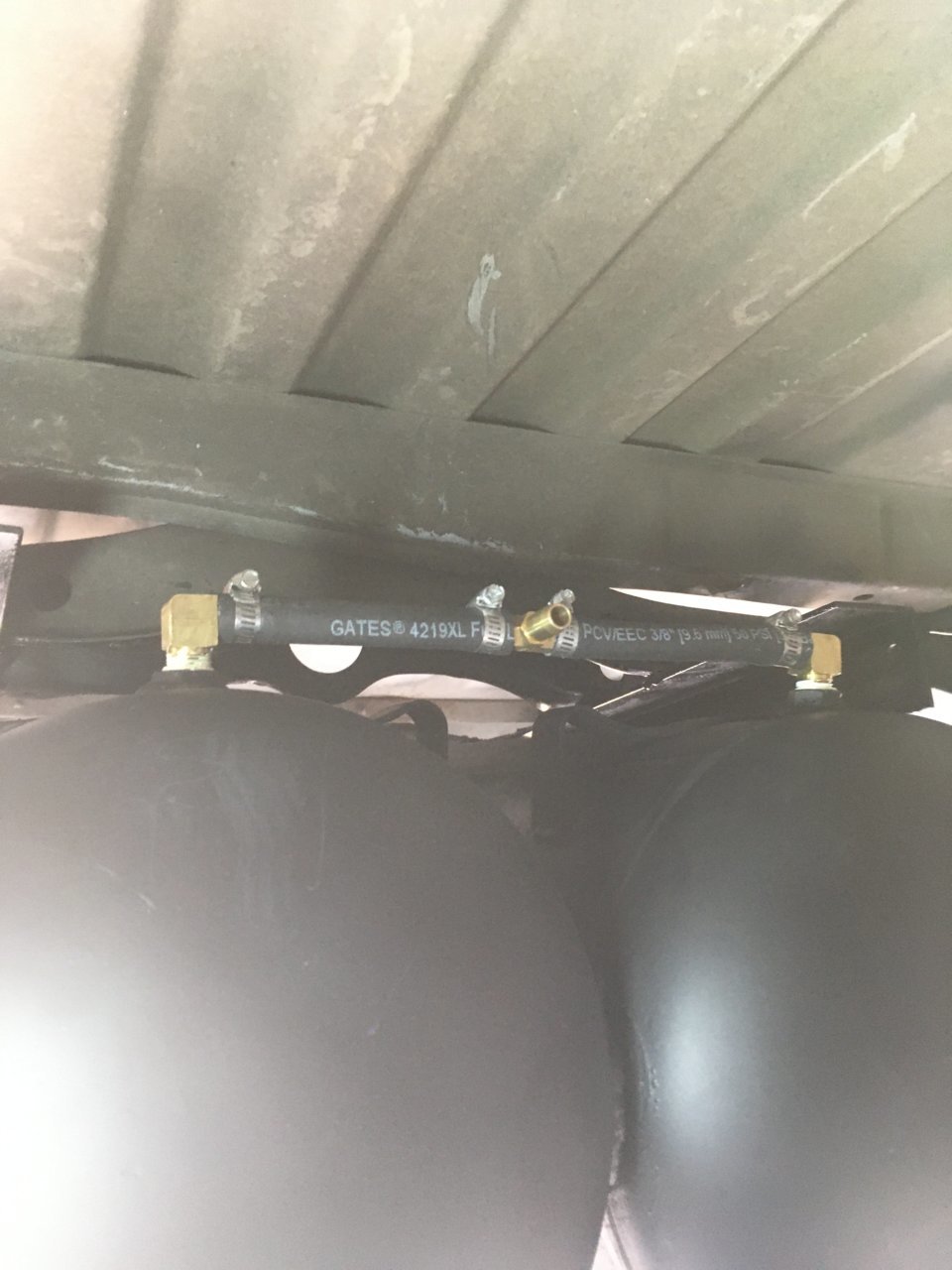

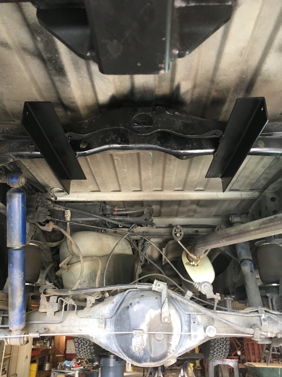

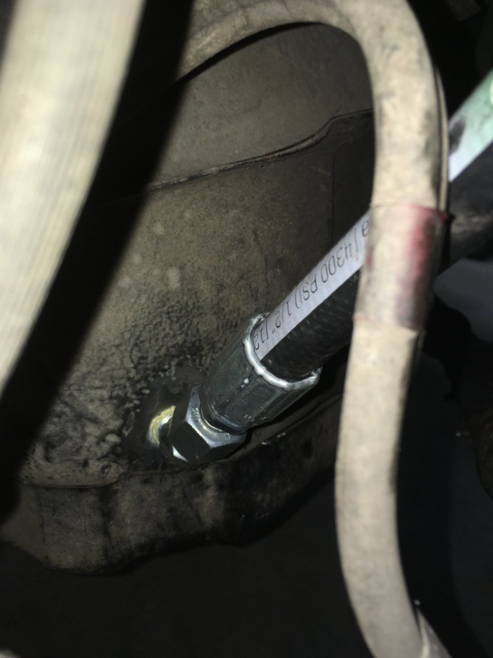

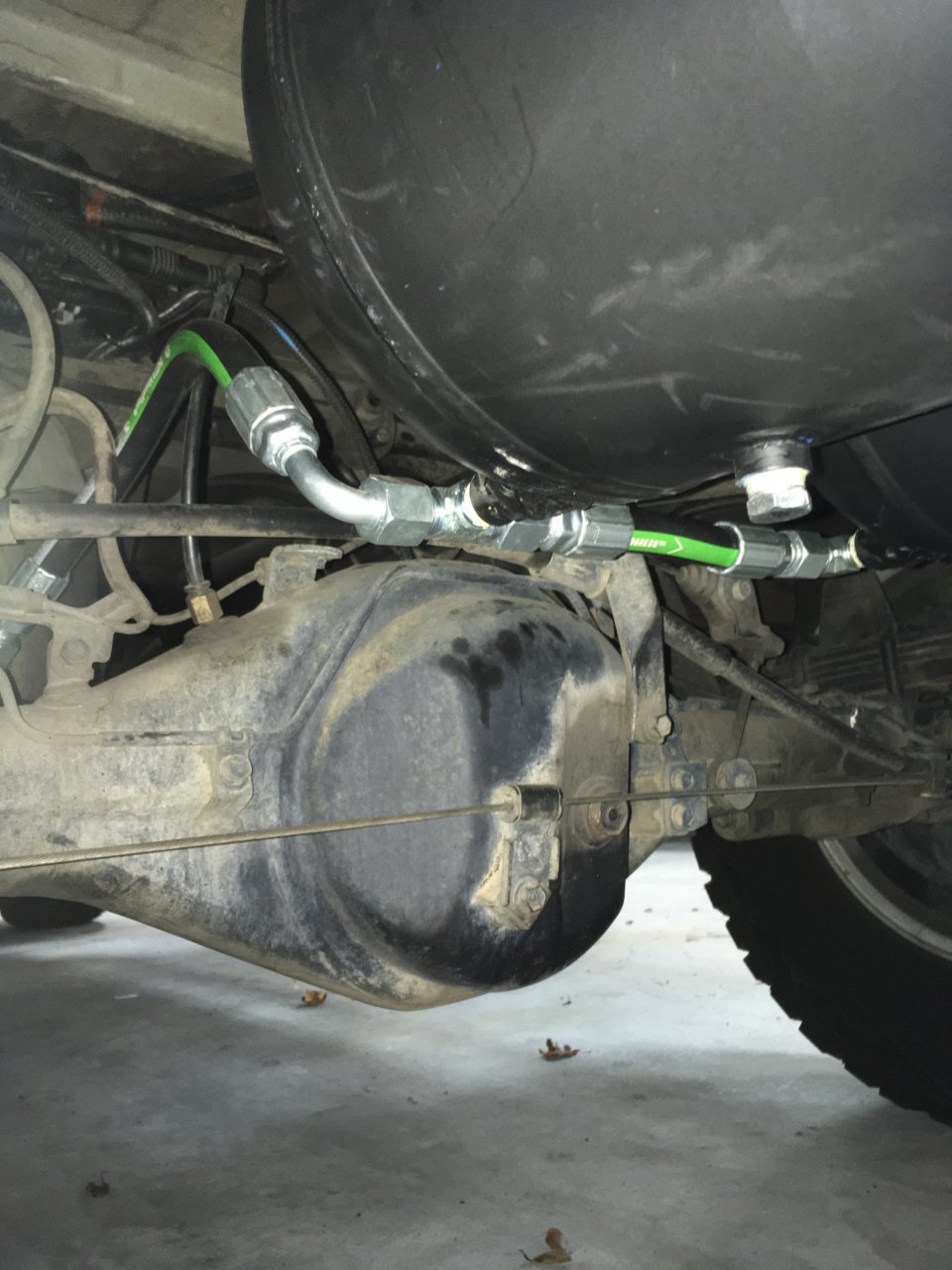

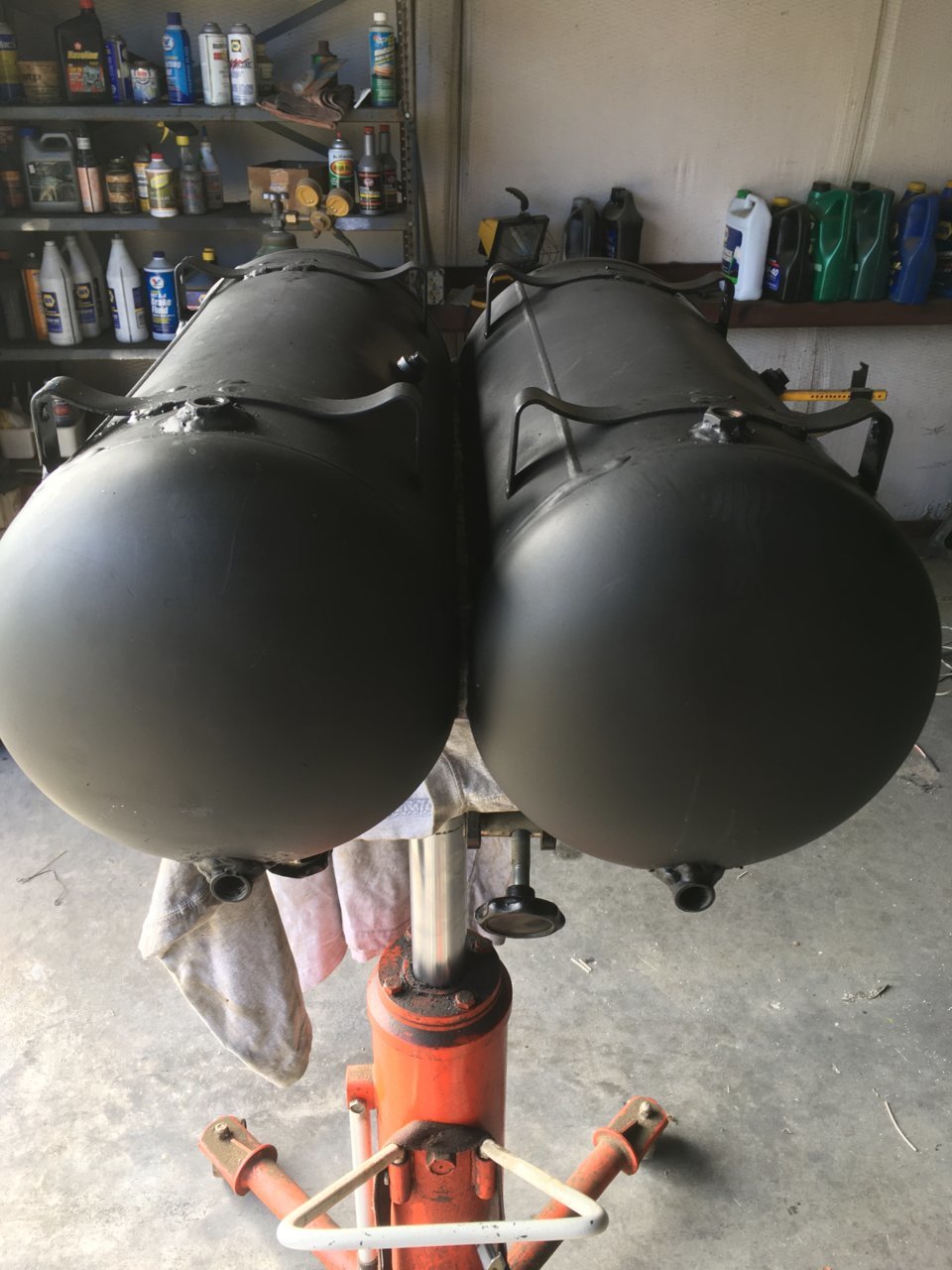

    So this is what I came up with. It works, and is fairly cheap. The only drawback is extended filling times as the setup is currently. Took 15 minutes to fill. I started with two 7 gallon kobalt air tanks from Lowe’s. Welded them together, plumbed them together. Welded bungs on the bottom front of the tank so nothing will hang down. Flipped the tanks upside down, reinforced the feet that were welded to the bottom of the tank, attached 2” angle iron with bolts then welded to the angle iron to the old spare tire crossmember. I then knocked a hole in my truck main tank and threaded to 3/8” npt. I used 1/2” hydraulic lines for strength. Plumbed the vent of the auxiliary tank to the fill spout vent of the main tank. Done deal, just over 32 gallons of gasoline, plus my jerrycan. No pump, no mess, no problem. Just a simple siphon fill and siphon use. 0440DE4F-9F1C-48A7-A45D-0F94CEEA499E.jpg 677B4739-211F-412E-8822-0D02CE0C164A.jpg BA3B468D-1F63-4A5A-96B6-E606FD1CF806.jpg F0B6AAD7-0271-400A-BCD6-8F5C0C2F4B88.jpg 0C632223-771B-4C76-BD10-53DD98136381.jpg DEA73E11-9A96-43F3-A4E1-FDC21A57FE13.jpg D52B30AC-F568-4F73-B44D-9D5E8FF1B77F.jpg

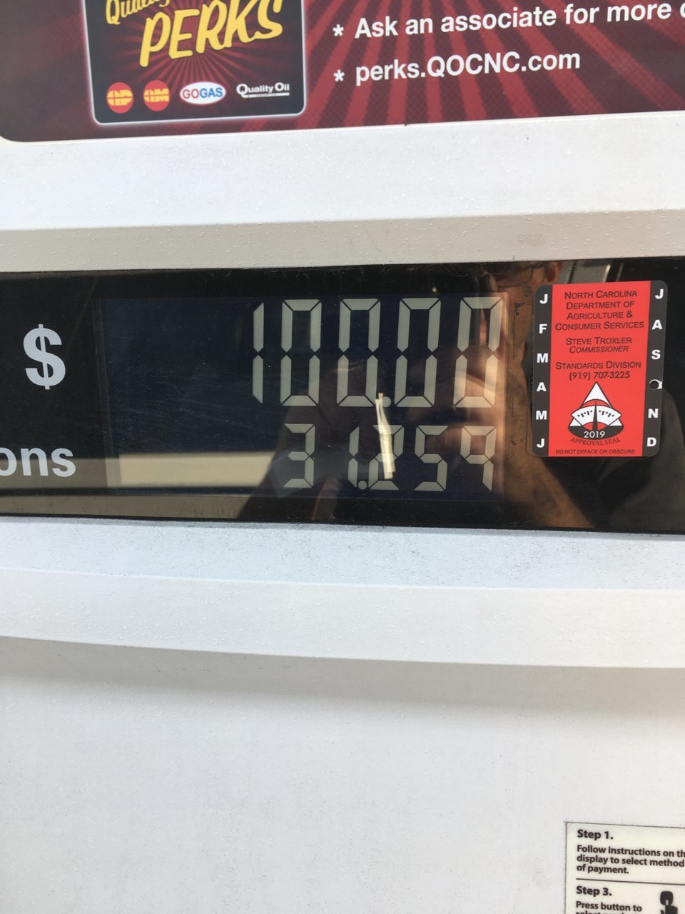

    The pump stopped at $100.00, but I restarted it and got a little more than another gallon in. It was running on fumes, as I had the tank empty to knock the hole in the bottom of it.
    Hamer95USA, CS_AR and cruiserguy like this.

    2000 ext cab, 2.7L, auto, 4x4
    Air tanks are okay for gas? You'd know better than I would, i guess it just surprised me was all

    Yeah ..cool. but...not sure that's a good idea or not.

    2000 reg cab 4x4 flatbed MT
    Yeah me too... First thought is that they should be vented, once they heat up that could get messy.
    And I'm not certain hydraulic hose is good for gasoline?
