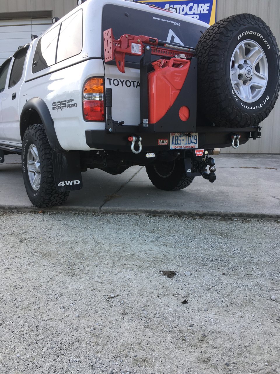

    What rear bumper is that?

    I put an ARB logo on it to match my front bumper. I love this bumper, it has a fold down cook/work table on the inside as well. Very well built item.

    Hadn't seen that you got it built man. Looks freaking great. And made sense about the tanks what you wrote. Love that rear bumper/carrier by the way. 4x innovations makes some sweeeeet stuff

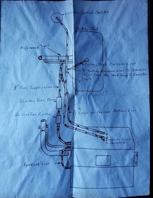

    2004 Tacoma TRD offroad aka Squeaky TuRD 3.4l TRD Supercharger w/ URD 7th injector Icon front coilovers and upper A arms Bilstien 5100's in rear Ramsey Patriot 8000lb Winch Dual Odyssey batteries with National Luna controller ARB air compressor 4xinnovations slider and rear tube bumper Badlands Bumpers front tube bumper
    For folks wanting to add an aux tank. This is how mine is connected. It retains all of the factory venting which makes it the only legal way to add an aux tank in CA.
