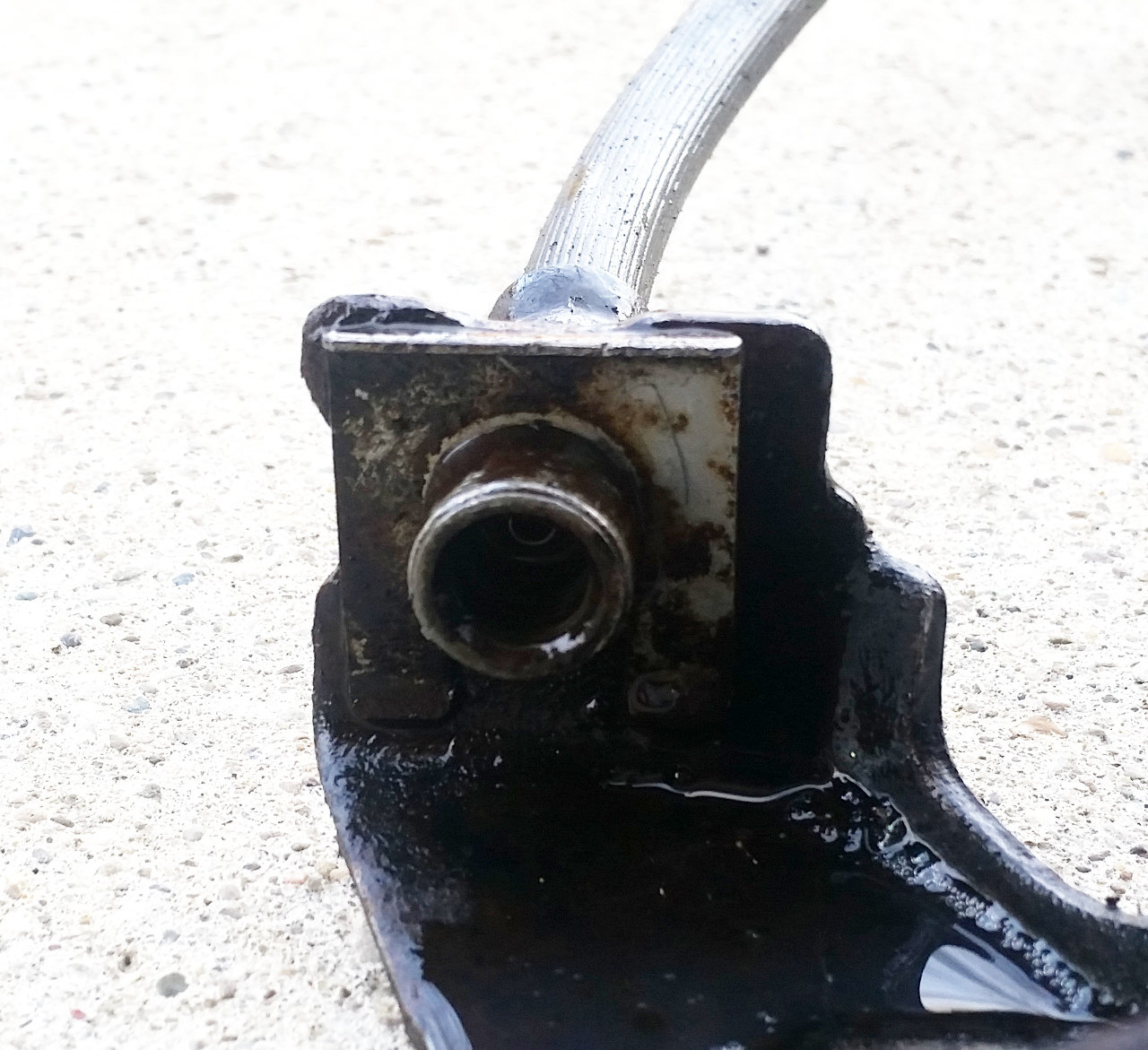

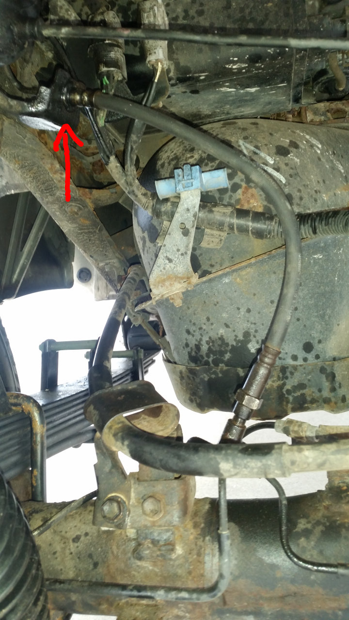

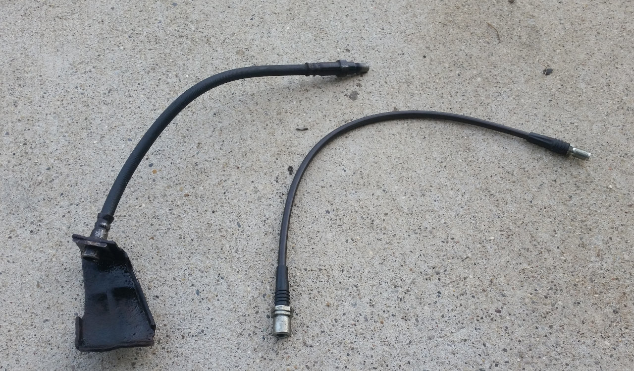

    Thanks for the advice everybody. I got a set of flare wrenches from Home Depot and was able to finish the job in an hour or so. In my first crack at it, I got the upper flare connection undone, but I couldn't get the retaining clip to move up to free the brake line from the bracket. In the original location, you don't have a great angle to push the retaining clip up, and of course everything is rusted together on my truck.
    I ended up removing the whole bracket from the frame by removing the two 12mm bolts that secure the bracket. Once the bracket was free I could unscrew the lower connection and remove the retaining clip on the ground. If I had to do the job again, I would start by removing the bracket. With the bracket free you have easier access to loosen the upper flare fitting.
    Here are a few pics I snapped, might help someone in the future.
    Before / After
    Retaining clip closeup
