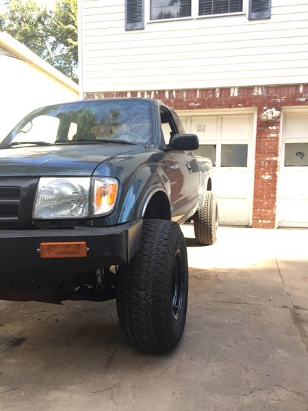

    dont like the idea of having 1" spacers up front to clear calipers and did some searching found out stud from 03 matrix rear will fit,got them from NAPA and took of my caliper and rotor,hammer the old stud out and try to fit new stud and but didnt fit!! I tried with ball joint puller or put back oem wheel and tightening it with my snap-on mg725 impact but still wont fit
    Is there any other stud that fit for 95 taco 4x4? Or what i did wrong

    Currently running 1" spacer and my wheels stick out way too much so im trying to change 1/4" spacers so less stick out

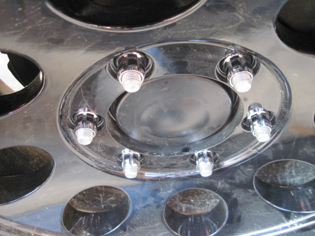

    I utilized the same stud length as the IS 300...
    but it's because my alloy wheel's center chunk was thicker then stock
    and I wanted to utilize 6mm spacers up front
    to clear my 295 tires increased width at full steering lock (L/R).
    I believe the rears will be shorter studs then the are the fronts
    And are likely about the same length as are on the Matrix.
    But I have not swapped out the rear lug studs as of yet...
    because I use open end, extended length lug nuts for more threading.
    And so the rears currently have a sufficient thread bite
    and there is little - no real reason to change those out currently.
    btw... I purchased my extended studs on ebay...
    and tho' they were designated to fit the IS300
    they will also fit many other Toyota needing extension.
    The IS300 studs will be too long for thinner wheel
    center chunk thicknesses mounted to the front
    of the 1st gen Tacoma.
    easy stud swap btw
    IMO they could be a little shorter...
    but is not an issue when using open end lug nuts.
    I think this picture is without the 6mm spacers installed.
    But I would need go look currently to make that confirmation.

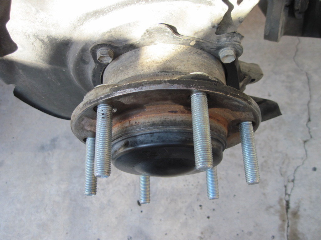

    here's how the rear's look
    using the original factory studs... but with extended, open end lug nuts.
    Tho' it wouldn't hurt if the Rr studs were slightly longer...
    It's not enough to worry about or do
    because the financial cost isn't worthy or necessary.
