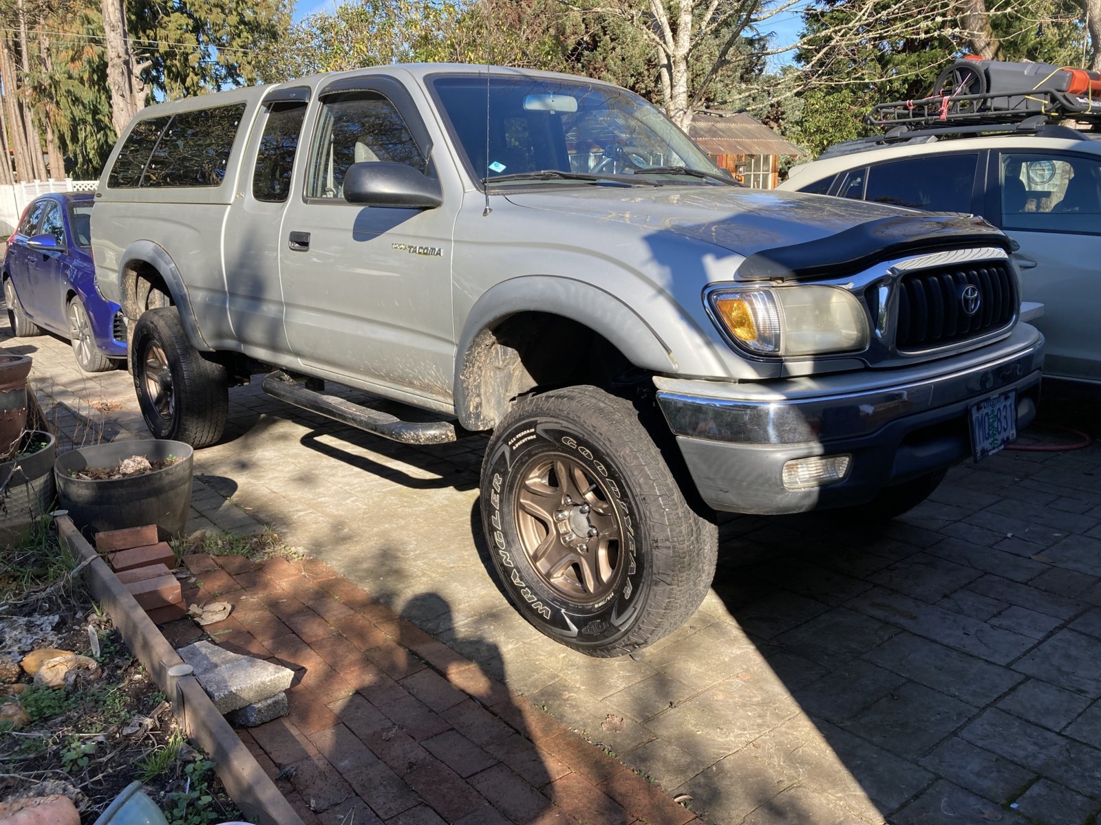

    Hi there,
    Recently exploded my driver side CV after lifting my 01 taco 2.7L 3" inches with 882 springs and 5100 on lowest setting, they were old and couldn't take it. I do have the toyota reboot kit but was thinking of going with longer travel CV jobs. I see autozone makes them but also CVJ. What are other doing?
    Thanks!

    That looks like a little too much lift o_O
    I will only run OEM. It’s not a hard job to re boot. Only suggestion would be to use hose clamps and not the factory CV straps.
    It’s messy. These are off my 1st Gen Tundra, Tacoma’s are coming soon.
    Get a quote from Toyota. It’s a $1,000 job.

    Your issue is your lift, lower it
    And it ain't long travel, it's extended
    Won't matter though cause you're lifted too high

    Shoot, I didn’t think those springs would push it up that high and then to think I could just deal with the fallout later. This thing only sees a gravel road every now and then too! I have a M8000 winch I haven’t installed. Would that push it down a bit ?

    Defiantly sitting too high, not an axle length issue, its an angle and over extension issue. longer shafts are going to cause differential damage under full compression if you went that route.

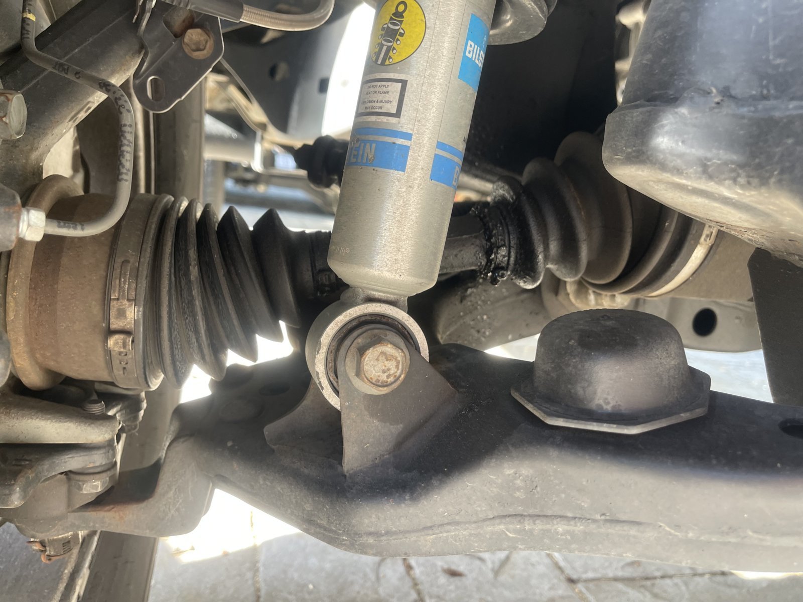

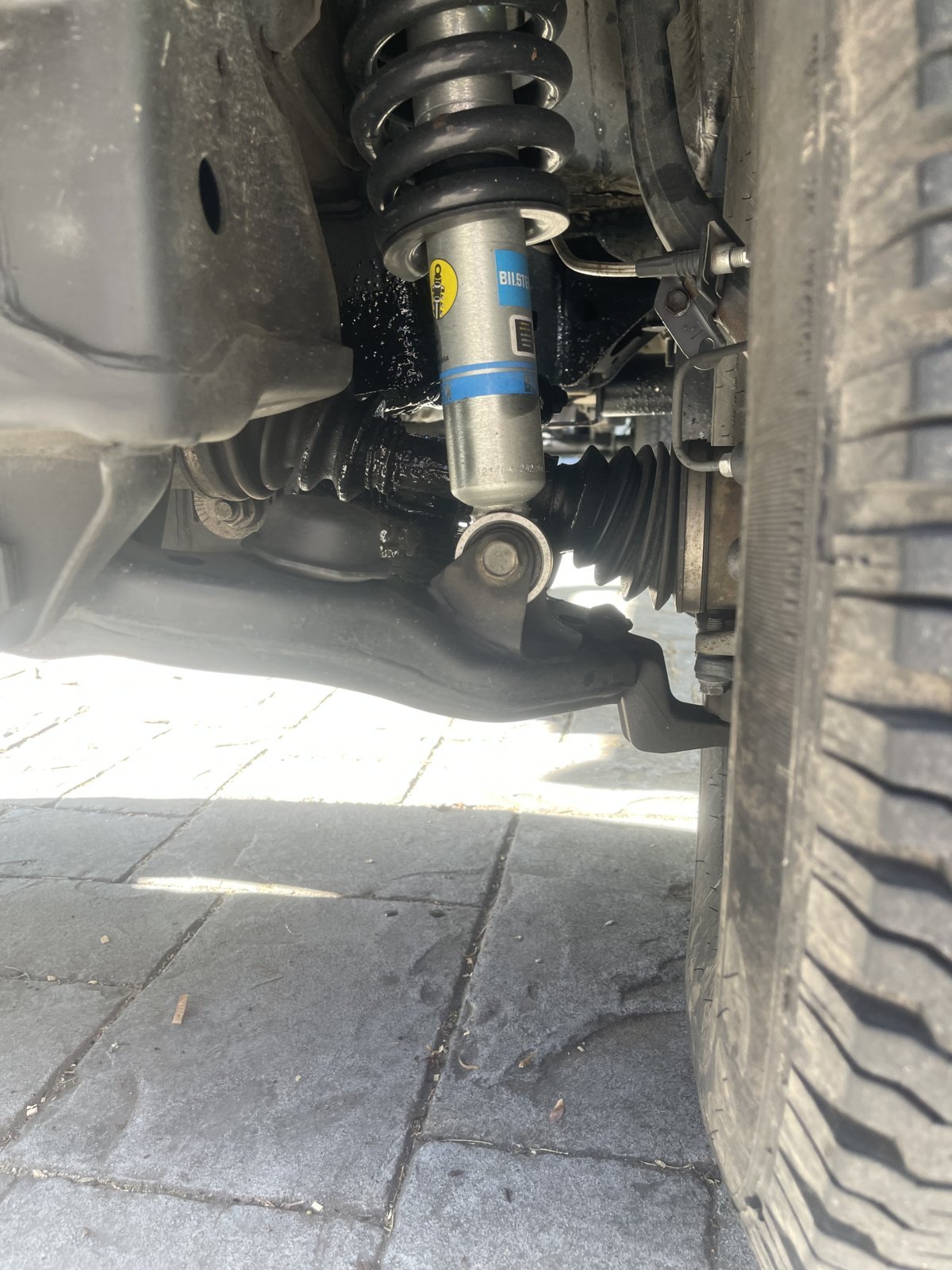

    Post pictures of your CV angles.

    Pretty ugly I know. Do I need new axle seals as well?
