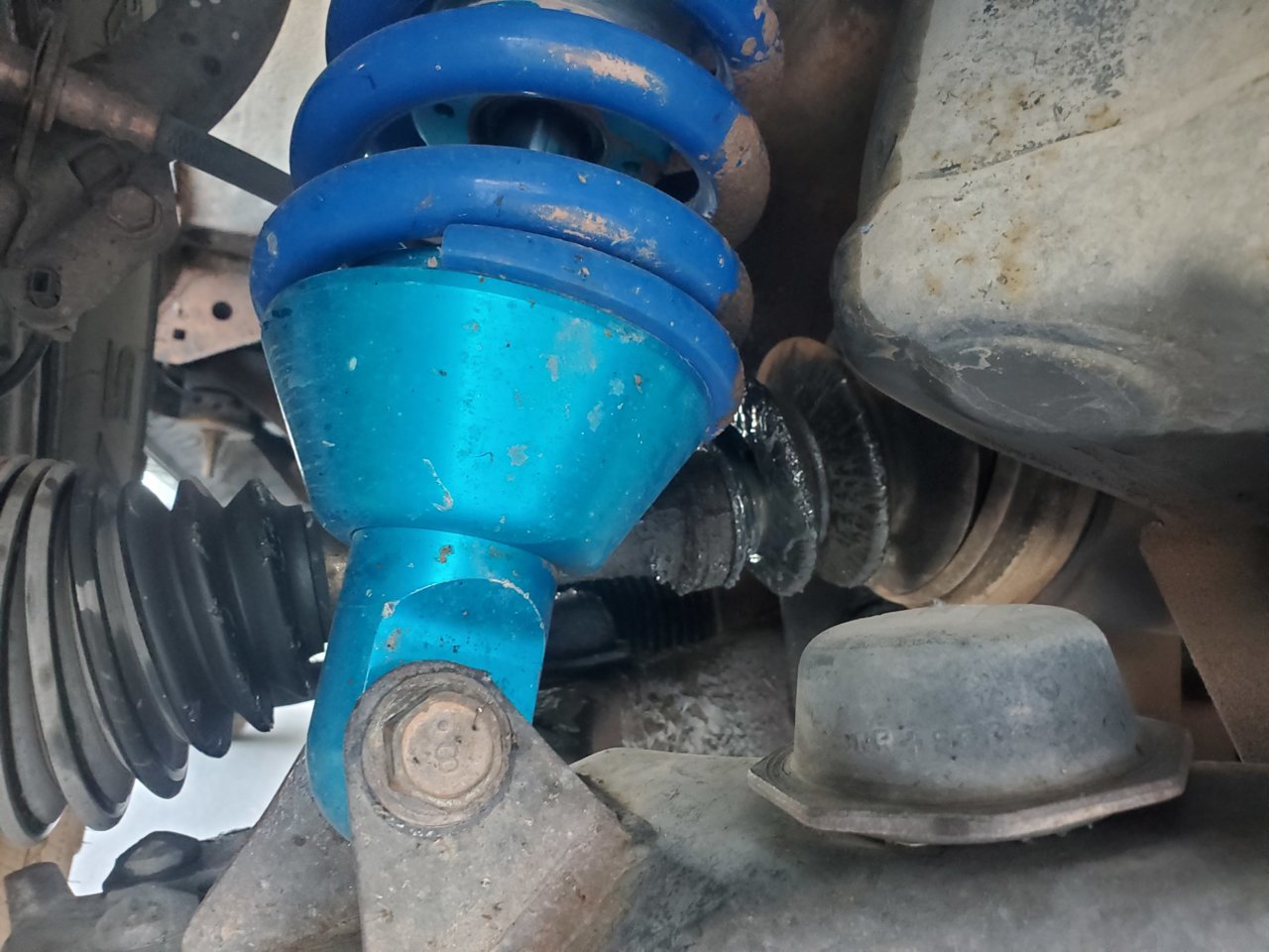

    Replaced the old CV axle with the new one.
    Will be replacing the other side as well, just short on time with holidays coming up and all.
    Don't plan on going off road really until the other side is done in which I'll post updates over the long term.

    Does the larger diameter shaft not hit the coilover body??
    My manual hub CV shafts have barely grazed my 2.5 coilovers so I would think that you wouldn't even be able to cycle the suspension with that kinda change

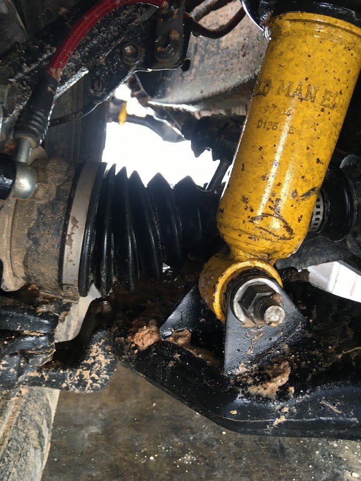

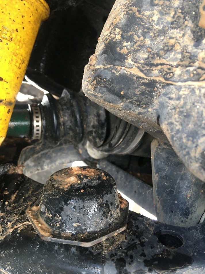

    Replaced mine last night. They don't interfere with OME shocks. There aren't many rocks around here but I do wheel fairly often through rutted and root filled trails. If they fail, this page will be the first to know.

    They don't interfere with my 2.5 coilovers either.
    The only surprise was the jump from a 35mm socket to a 40mm socket...

    @Malek any way you can get some pics flexing each end of your old axle?
    Mine had a torn boot and came apart so I couldn't.

    I'm not quite sure what you are asking. Like axle on the ground flexed to one side or the other? Both of my old axles have torn boots as well, though. They ripped right at the smallest part of the boot where it clamps.

    Hopefully these fit sort of what you are requesting!

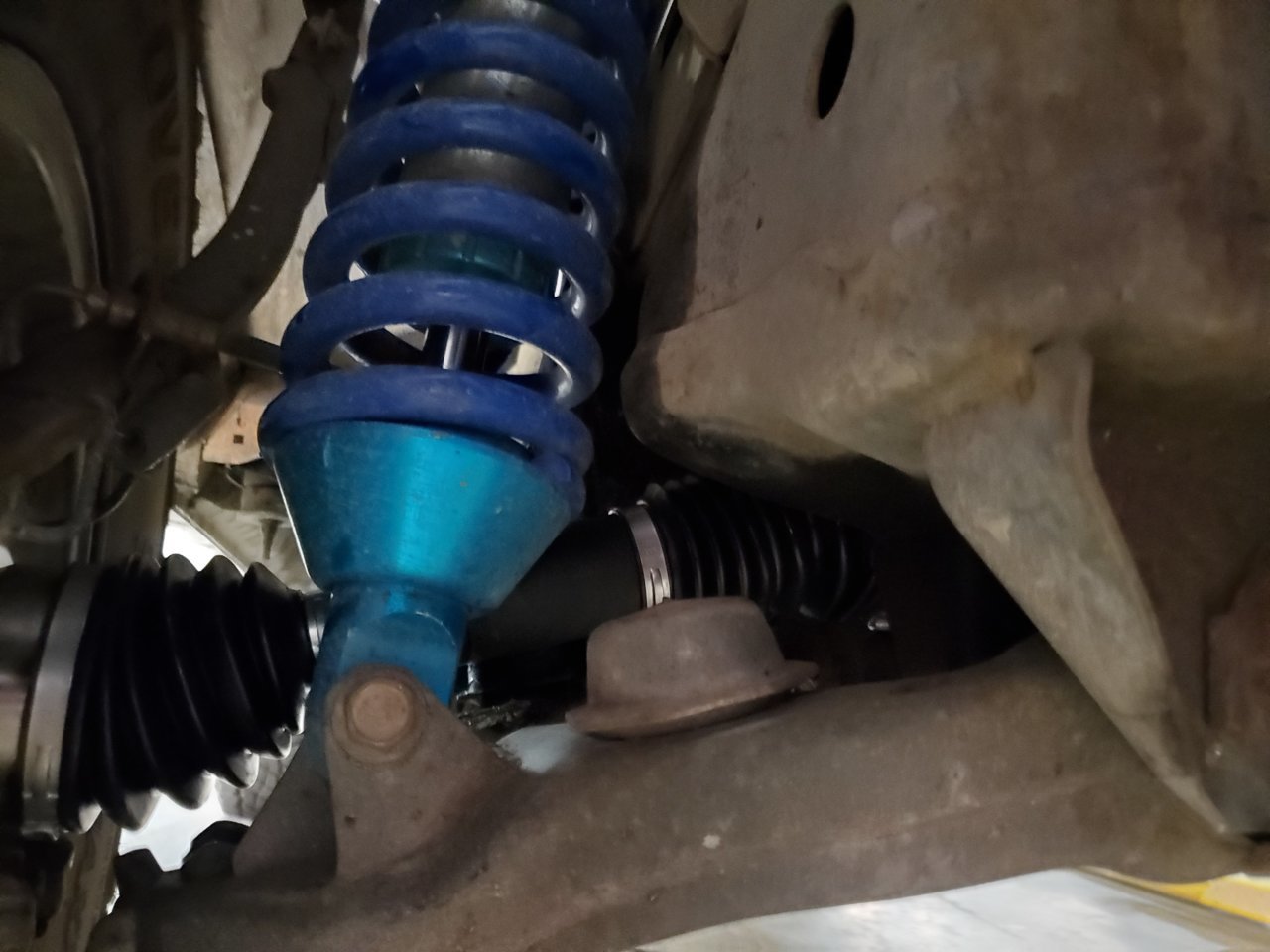

    Finally got some wheeling in during some snowfall. I rebooted my CVs in February with the boot slide mod. Had a trip back in March with 100+ miles of 4WD. Checked the CVs after today with some 50 mph speeds and about 25-30 miles of 4WD. Already have a wear mark on the inner boot but thankfully they aren't spinning full time due to my manual hubs.
    I'm wondering if it would be worth it to swap to these high articulation CVs and use a manual locking hub outer shaft/tulip housing. I will be adding a winch to my ARB at some point but I doubt that would drop my OME 882/nitrochargers down enough to change that inner boot angle.

    Yeah it's the inner boots on our 1st gens thats usually what rubs and tears. I lowered mine to wear the outer fins weren't touching and figured I was good but those inners still rubbed and continued to tear until I got it down to the point they no longer rubbed.
