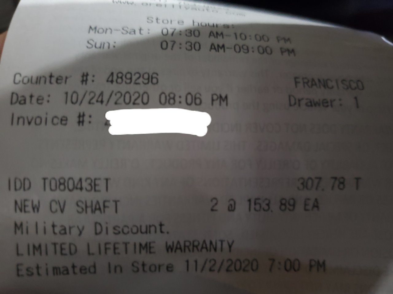

    Great topic, and great reading. My OEM CV's, inner boots are both about to need rebuilding. I was going to buy a Boot Kit, then do the Bootslide Mod, until I found this thread. Now I'm rethinking.
    In my neck of the woods, the TO8043ET's are $204.99 ea +$15/ea shipping.
    I asked why the difference in price, given this is an O'Reilly related price.
    He said, location.
    Is there anywhere else these CV can be obtained, cheaper?
  17. Mar 22, 2021 at 6:31 PM
    #77
    Kwikvette
    Feb 27, 2019
    #284735
    82,038
    Fresno County
    4 run, 2 don't
    Military discount helped.
    Taco2021LB likes this.
  18. Mar 22, 2021 at 6:33 PM
    #78
    Taco2021LB
    Taco2021LB Well-Known Member
    Jan 3, 2021
    #351657
    903
    Don
    WA
    2004 DblCab 4x4
    OME 882 Dakars Falken 235/85R16s
    Hell, man, I always forget about inquiring about that.
    Thanks for the reminder!
  19. Mar 22, 2021 at 6:35 PM
    #79
    Kwikvette
    Feb 27, 2019
    #284735
    82,038
    Fresno County
    4 run, 2 don't
    They asked for my VA card or current military ID though.
  20. Mar 22, 2021 at 6:39 PM
    #80
    Taco2021LB
    Jan 3, 2021
    #351657
    903
    Don
    WA
    2004 DblCab 4x4
    I called back and inquired about the military discount.
    That brings the total to $402.58 OTD.
    That helps take off the edge a little.
