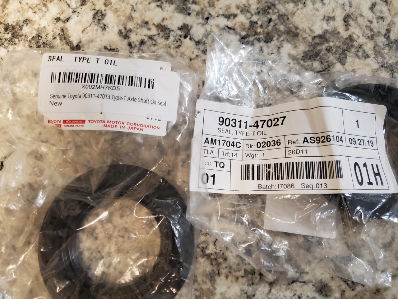

    I need some assistance, please.
    I bought a pair of the TO8043ET CV's through O'Rielly's.
    Now I need to know, what the part numbers are for the inner (Left and Right side) seals.
    I'll speak mildy. O'Reilly's help, they don't know WTF they're doing. At least, the one in my area.

    These are it -
    You know you can find any part number on Toyota parts online right.

    BTW, THANKS for the seal numbers!!

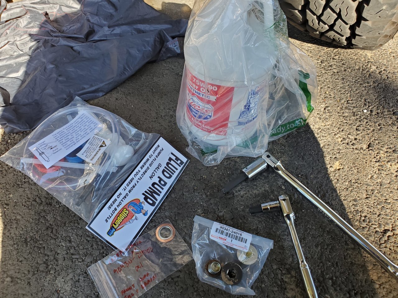

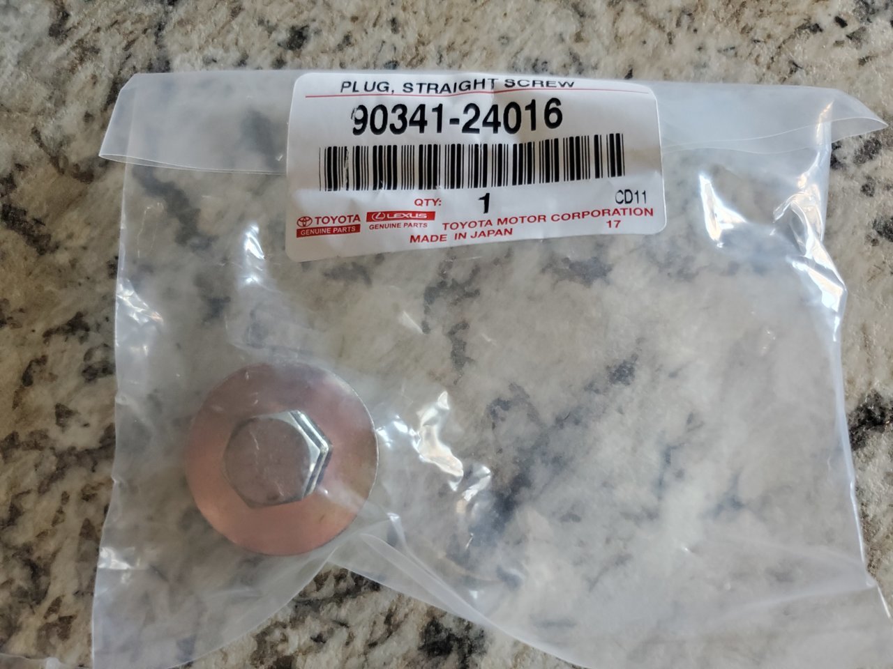

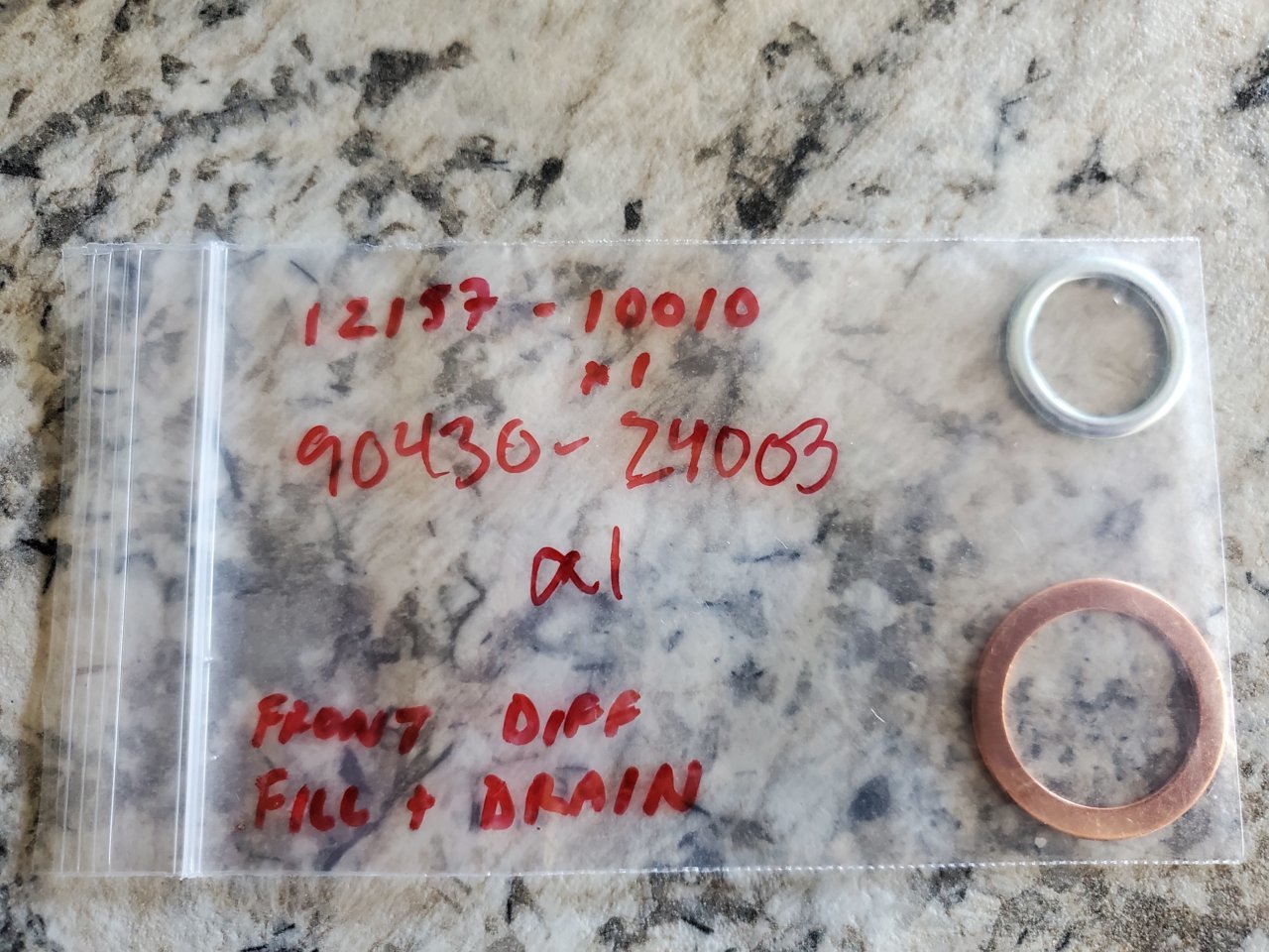

    Since you'll be replacing your seals and cv axles, do yourself a favor and get some diff fluid to replace yours with, as well as washers/crush washers and a Lexus plug.

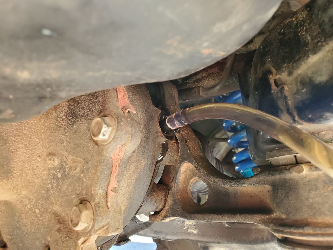

    Just make sure you undo the fill plug first.
    It isn't torqued on tight, but its a hex so unless you clean out any and all dirt and debris, you can easily strip it.
    I had no issue with mine at all but I did clean it out completely. Then I insert just the hex tool, and gave it a few whacks with a sledge. Think that was it to make sure it came off easily.
    3/8 drive on the fill, 1/2 drive on the drain.

    Now I need to get the drain plug and washers.

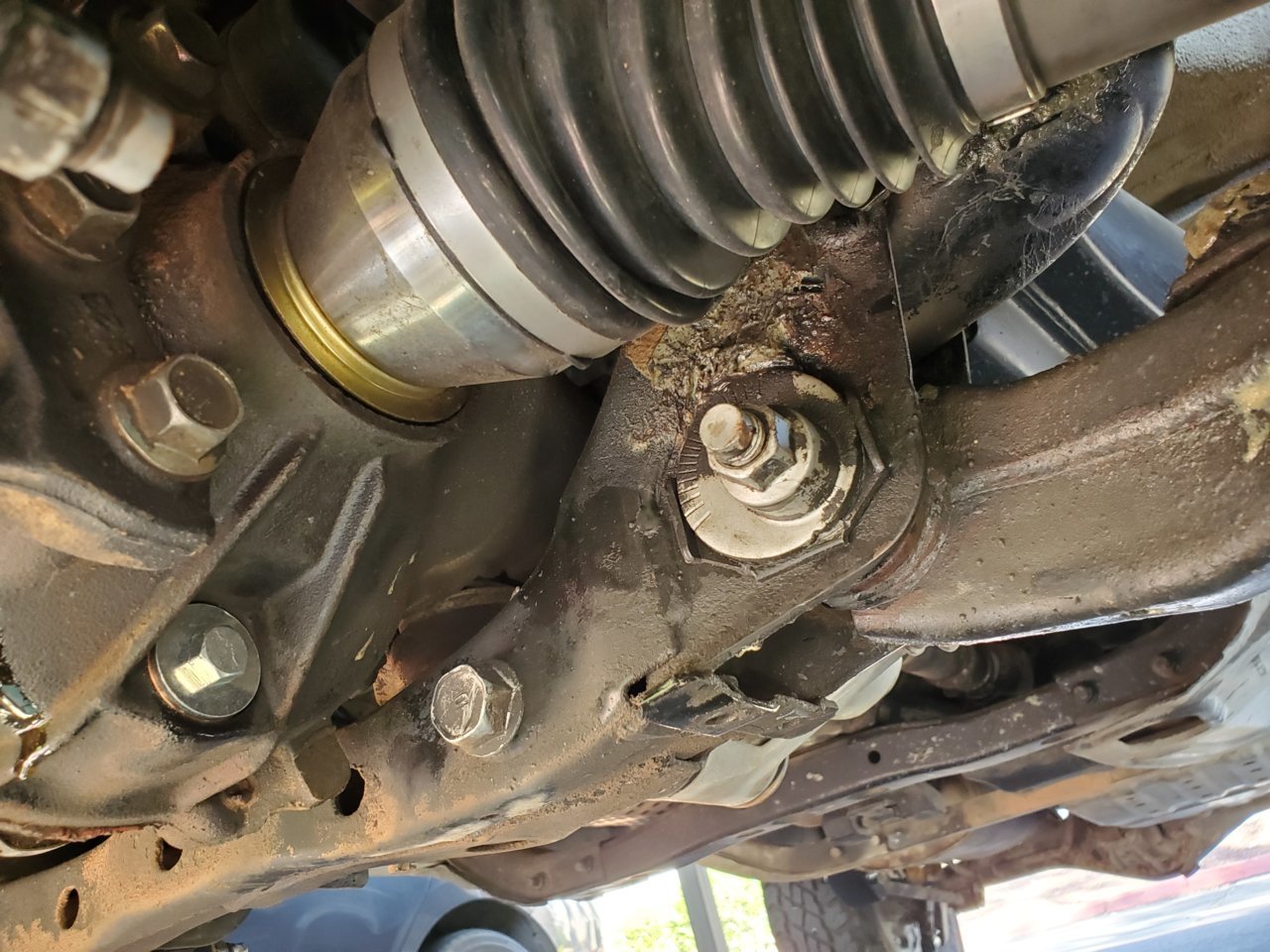

    I've got both CV axles installed.
    Think I posted pics of both sides in this thread.
