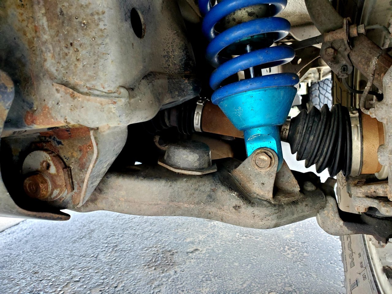

    So the update -
    I'm not a rock crawler by any means, but I do frequent the road less traveled often whether it's rock, snow, mud, etc.
    With that being said, since getting these axles on I've driven 1200 miles per month as I leave town 4 times a month. That's been going on since installing these months ago...
    Well, my boots have been torn for god knows how long -
    As you can see, there is no grease of any type anywhere. I know when the boots on my old cv axles tore, I had grease absolutely everywhere -
    I don't know if it's the unique design, or it's just sealed up much higher, but these cv axles are performing as they have brand new with no ill effects.
    I have no strange noise, and they don't act any differently than when I first installed them.
