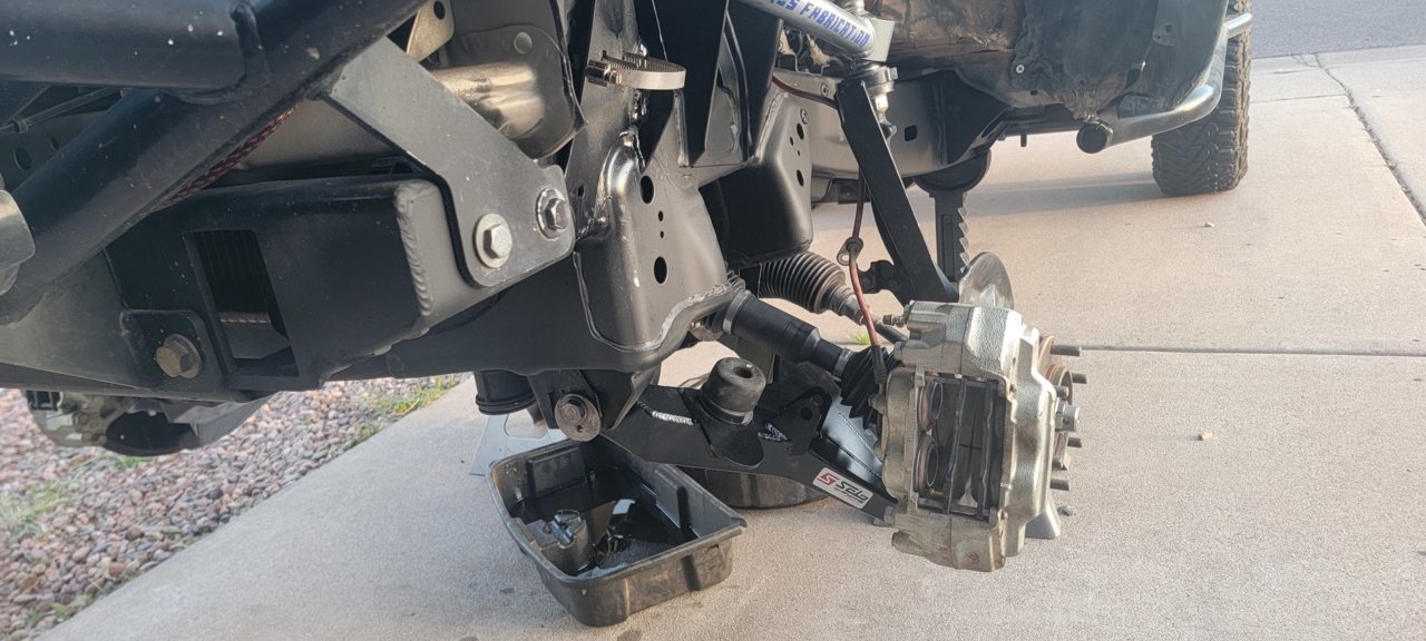

    Bringing back an old tread !
    So my shafts are rubbing the coilover cups. I remember reading about a t4r who was having an
    similar issues and I was wondering what their fix was. I'm going to have my aliment guy pull a little bit of caster out and see if that helps. Anyone else running into this issue?
  20. Apr 7, 2023 at 10:19 AM
    #160
    Kwikvette
    Feb 27, 2019
    #284735
    82,033
    Fresno County
    4 run, 2 don't
    I owned that T4R.
    No fix, I just sent it as is.
    They have a lifetime warranty so ideally you should just replace it under warranty; doesn't take long to replace a CV axle at all.
