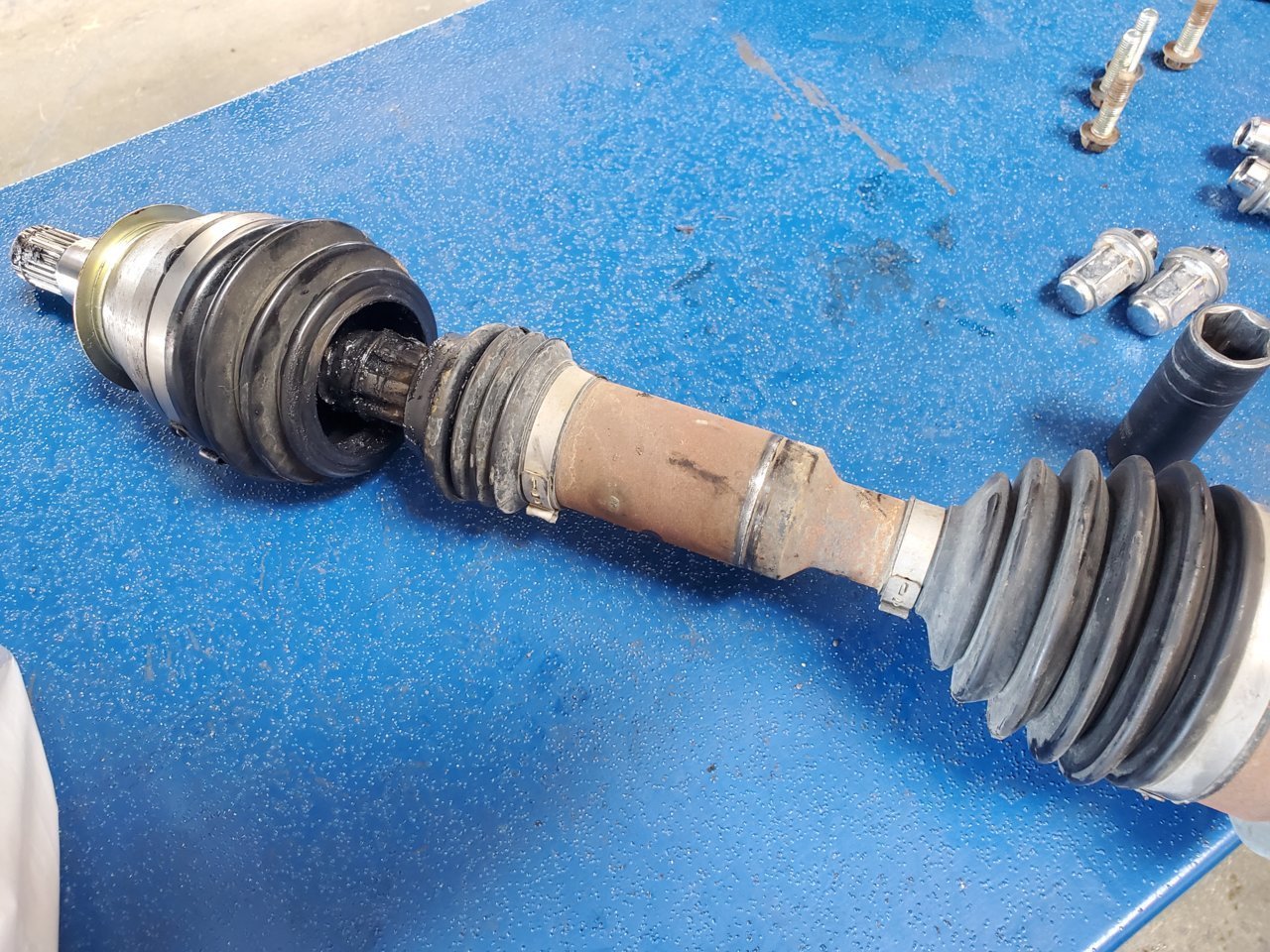

    Here's a pic I snapped of mine when I pulled to check it out; something "locks" it into place to prevent it from being pulled apart. Take it I'd have to cut the boots completely off and get in there to find a lock ring or something.
    They can physically compress and extend as it "rides" along that shaft you see there.

    Well, I am back after 2 and half years to report one had failed me. Both of the boots tore within the first three months but I decided to roll with them for as long as they would last. (not very long). The one pictured exploded on a fairly mild trail. I don't know the exact moment it happened but I assume the combination of slipping on snow and sudden traction on rock may have done it.
    I did take them both back to O'Reilly's and they warrantied them for me. The new part number has an extra T at the end I don't remember seeing on the first set. I'm going back out this weekend on the new axles, hoping for smooth sailing this time.
