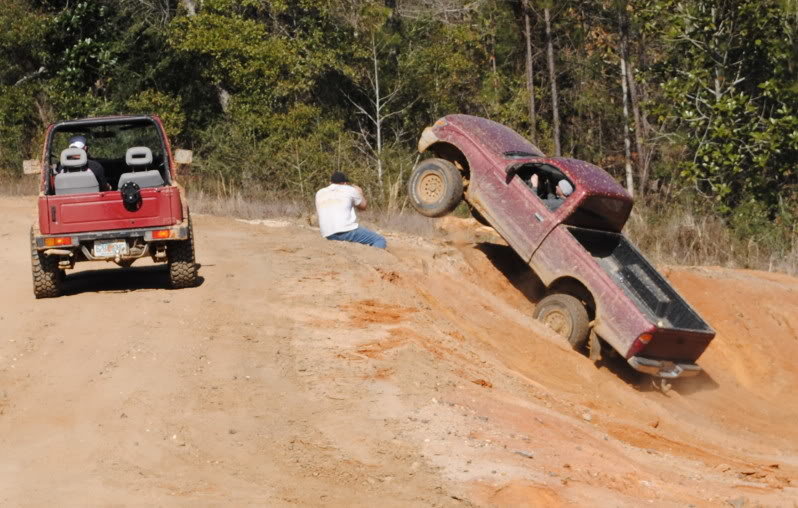

    I do wheel...I probably wont beat my 07 as bad as this one:
