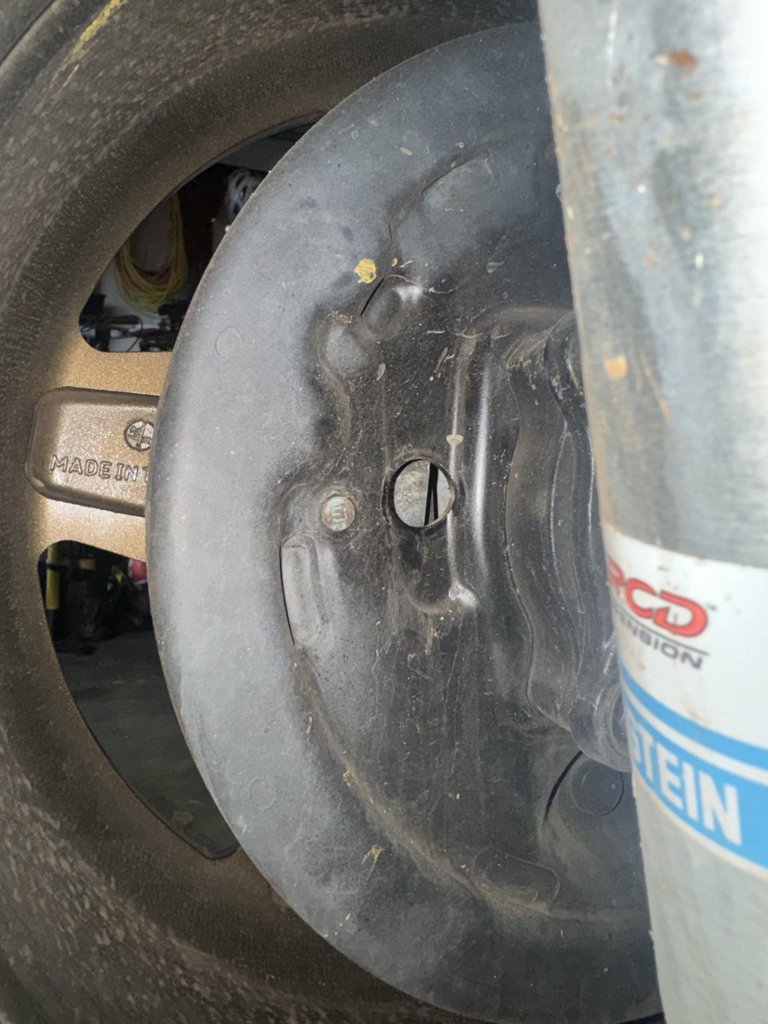

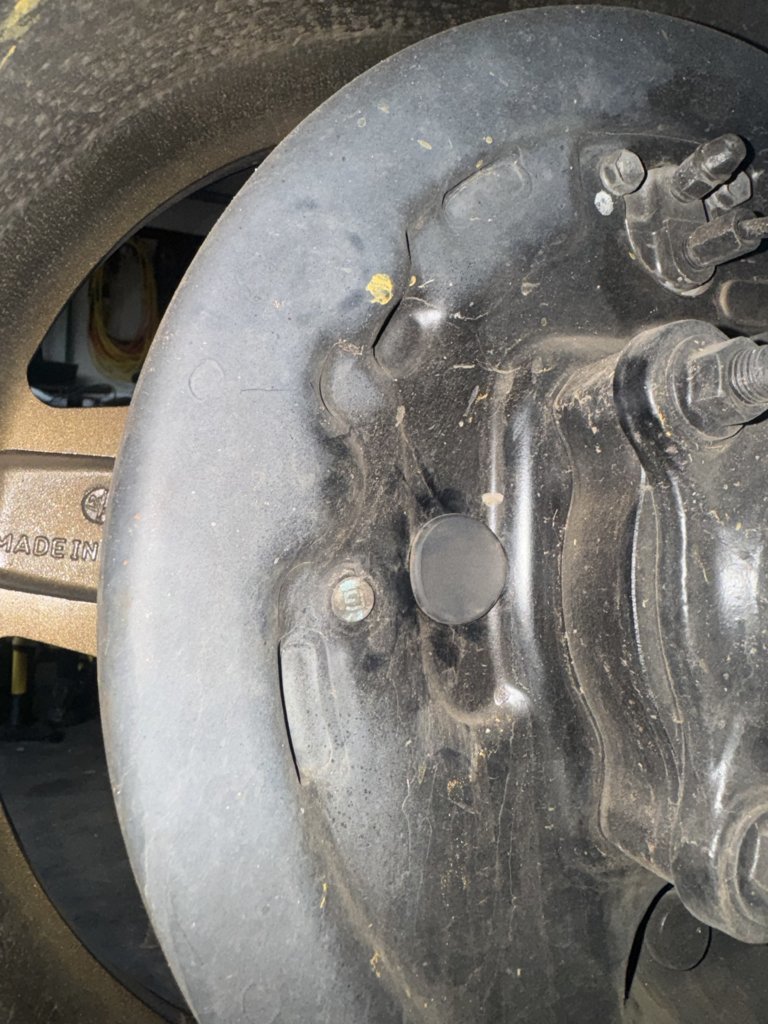

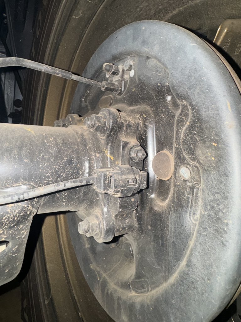

    Bent the dust shield for the front and drilled the back plate on the rear and plugged with rubber grommet plug.
    ivanjo3l[QUOTED] likes this.

    Have pics of where you drilled the rear back plate? Installing mines this weekend and kinda wanting to have an idea

    You don't have to drill holes in the plate, check the video I posted above your reply, you can get them in the hole by removing the drum brake tension springs and bracket holding the pads, you could probably do it without removing those if you wiggle them in-between the springs.

    I took the shoes completely out and tried coming in thru the hole where the piston sits.. no dice.

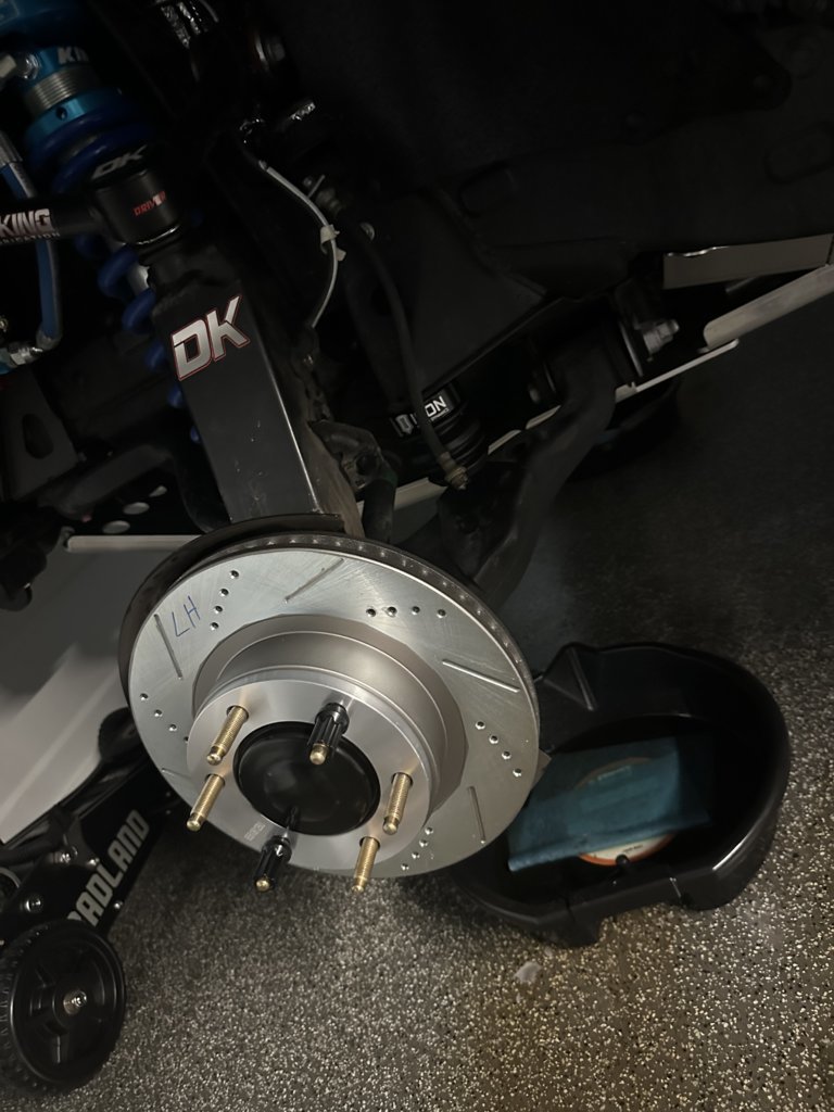

    Front ones are in :thumbsup:

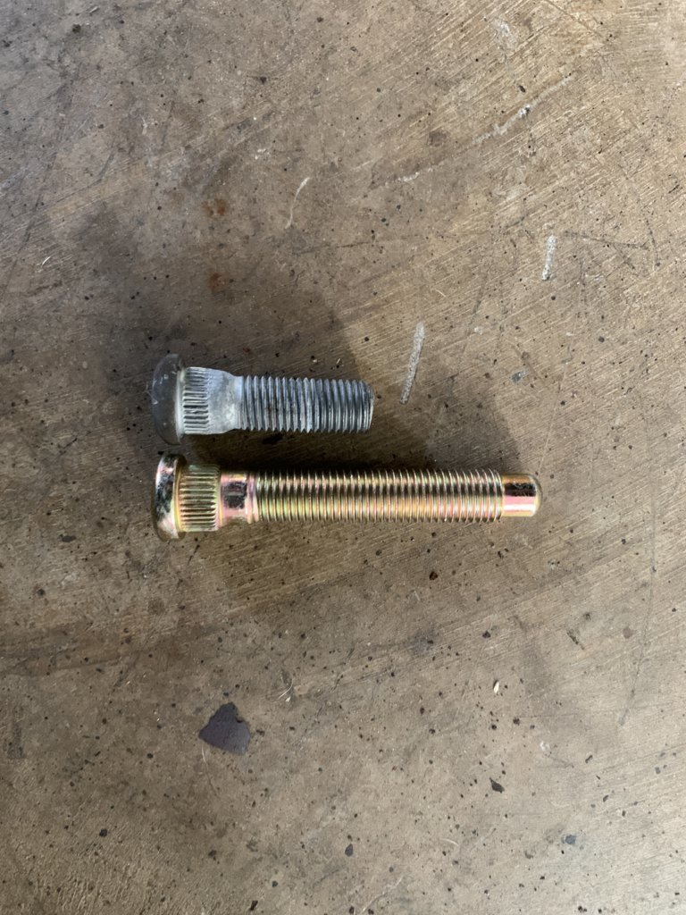

    Wish I would have since this video a few weeks ago since I took a wrong turn....twice.
    First I ordered 60mm studs that are too long.
    Then shortened them by 15mm, which is too much. :annoyed:
    Ended up with a 45mm studs, which is better then OEM, but I think it is still too short.
    I'm debating on whether to buy new 55mm studs or use what I have.

    50mm is the optimum length unless you're running some ultra fat spacers.
