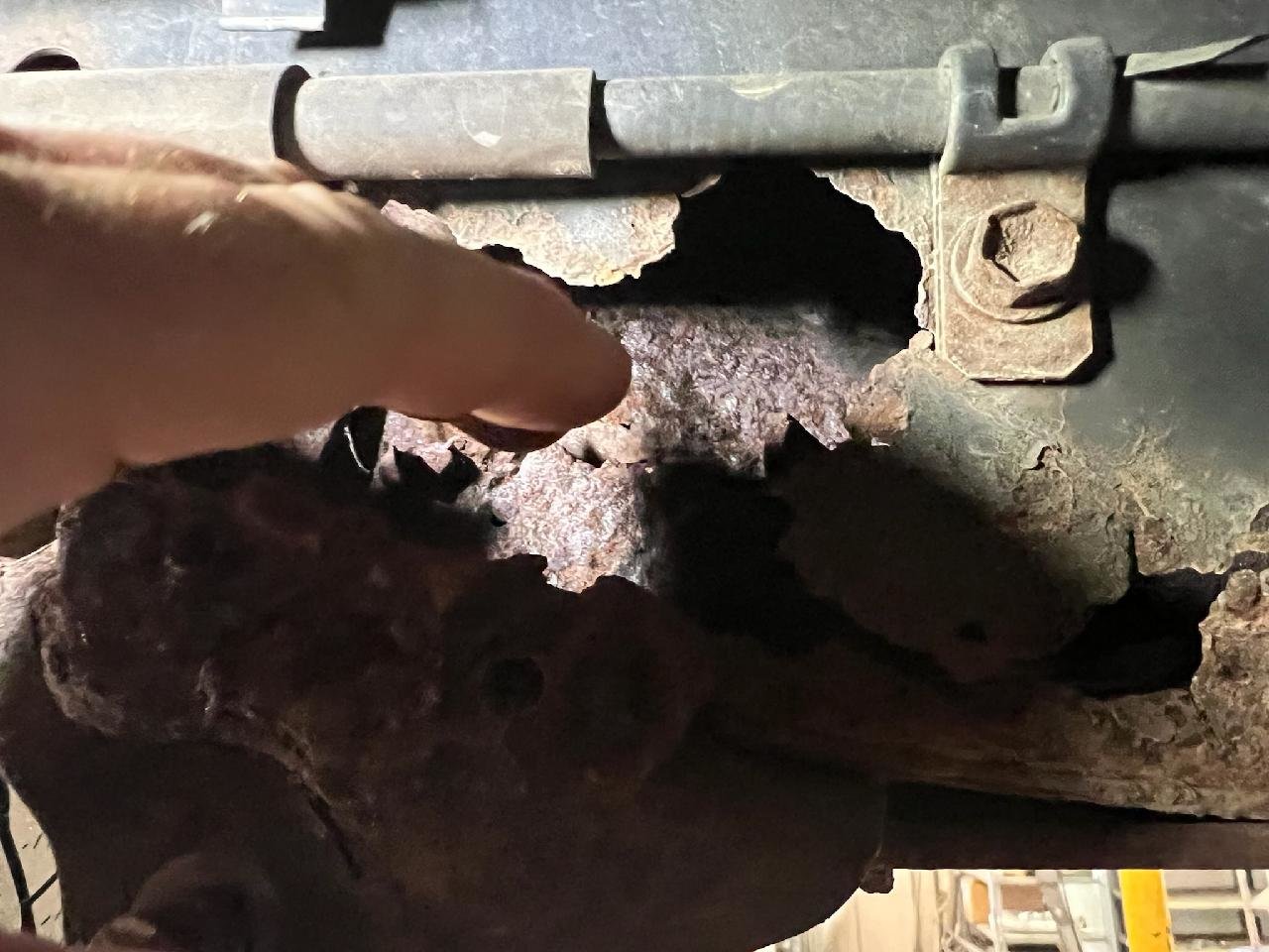

    Hey Ryan yeah I got the frame fixed this is what it looked like when the gas tank got dropped. I have no idea how it didnt just snap in half the only thing holding it even remotely close together was the leaf spring mount. 290292.jpg
