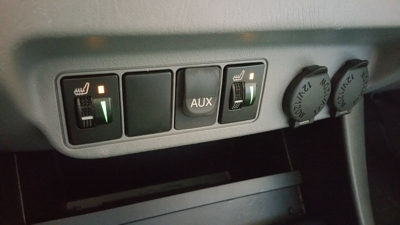

    I did it. I unplugged the factory plug and put it behind the radio. Plugged in a 4 port data and power USB hub. Just run an extension off of that to your center console. Then I used a panel mount aux kit and mounted it into a blank that I bought off eBay. I then reused the factory cover for the aux input. If you go this route just don't plug more than one data device into the hub as it will interfere with the data connection as the radio can only handle one. To avoid this only use one data capable USB plug(for the iPod), and use power only for all other accessories.
    I just put a piece of electrical tape over the USB lettering.
    I plan on switching to the older model aux only plug soon.
    Edit: This is the USB mount I used in my glove box, but would look pretty clean in the center console. Just drill a hole and pop it in.
    Edit again: this is the hub I used.
    If you have any questions let me know.

    No problem and I sure don't. I did this mod before I started really doing write ups or anything. It's pretty simple though.
    First remove the AC panel and radio. Here's a good write up for that.
    Then remove the factory usb/aux plug. You can do this by carefully pulling on the cover that says usb/aux or try to reach behind it and push it out from behind.
    Then unplug the USB plug.
    Reroute the wire up and behind the radio the best you can. It can just sit out of the way back there.
    Then plug back in the factory USB input behind the radio. If you want to run the aux plug to a factory blank like I did, you'll need something like this. Then you'll need a factory blank for that location. I may have a spare. I'll check but if not I it's only about $5 from the dealership.
    Then you mount the aux blank into the panel and you can reuse the factory usb/aux cover. Then run your data and power capable USB extension to the center console. You can either just run it into the console or use something like the mount I linked before to clean it up.
