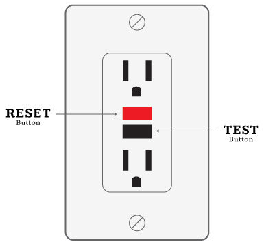

    One of the outlets, on the exterior circuit, should have a gfci reset button.
