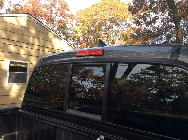

    IMG_0596.jpg Last night my neighbor came over and said my light was on. Sure enough, I went in and got my keys came out open the door, everything is off, I pushed on the brake pedal, closed the door and it was still on. Started it up, turn it off, got out locked the door and then it went out.
    What's going on? It's off in the pic, just showing what light it is.

    turn your dome light off...

    I checked that and it was off. But thanks.

    Your brake switch is sticking.
