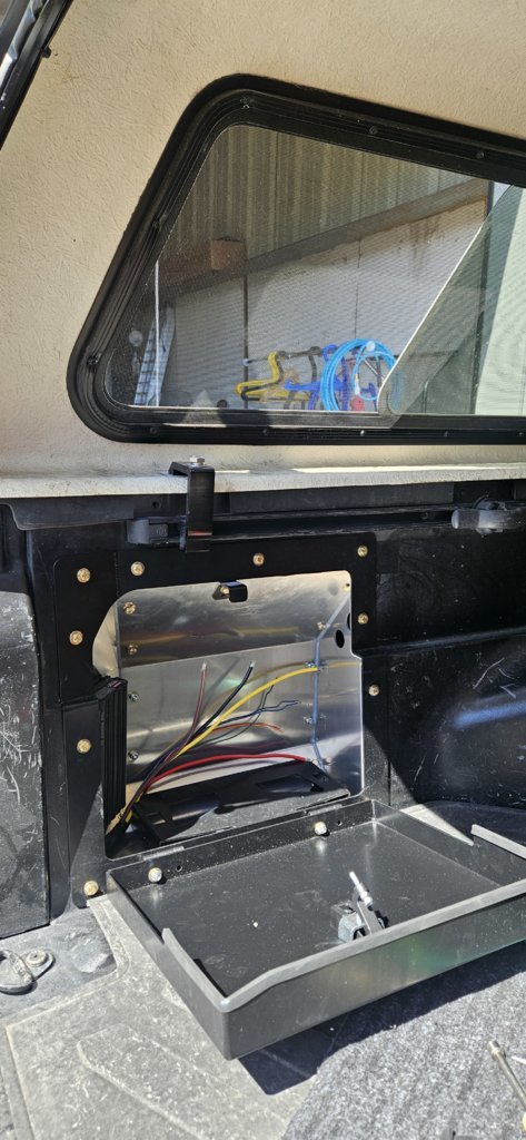

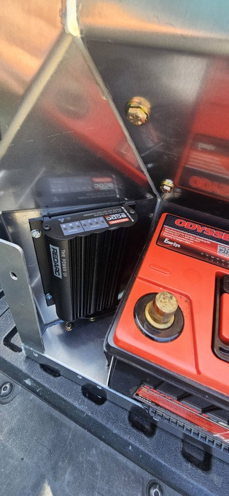

    I run an Odyssey Extreme AMG battery and a RedArc 40amp DC-DC charger. I also run a battery isolator under the hood so that I can jumpstart myself. The charger works great and can charge the battery from 70% to 100% in about 30 min. I found a couple of bulkhead passthrough terminals on Amazon since I run 4/0 cable for my RedArc 2000w inverter and winching. On top of the battery on the left is a RedArc bluetooth battery monitor and next to it is a 500amp fuse. I chose this fuse for winching. The charger will also accept solar (yellow wire) and you don't need a solar regulator with it.

    @Sierra_Taco
    Very nice job- where did you get the shelf mount for it? That’s a really secure looking shelf. One safety recommendation, I would cover all the exposed positive battery cable connectors and the + battery post with a sturdy wrap or cover of some sort in case you ever get rear ended or T-boned in that back quarter panel. If it gets deformed, the shelf surrounding it, or a broken loose battery, could contact the sides with the exposed battery connectors. Just a suggestion. Maybe it’ll help keep water and dust off of it inside the cubby too, but yours looks really clean like it’s doing that already.
    I really like the way you set your extra battery up. I have a compressor mounted on a shelf in my driver’s side cubby, but it’s not enclosed like yours, so I’m considering doing what you did and replacing it with my spare battery. Thanks for posting!
    EDIT: Oh, I found it, and great craftsmanship, but ouch!! :spending: So maybe I’ll just modify mine, but thanks for the idea!

    That's fair. I'm all ears if anyone knows of some low profile covers that would fit.

    You can wrap the ends of the cable using self sealing silicone tape (available at most auto and hardware stores), and get battery terminal covers at auto parts stores also. I really like self-sealing tape, it sticks to itself and looks like shrink wrap when done. Very secure and a lot thicker than shrink wrap also. You’d only really need to worry about the positive terminals, but for looks, you could do both.
