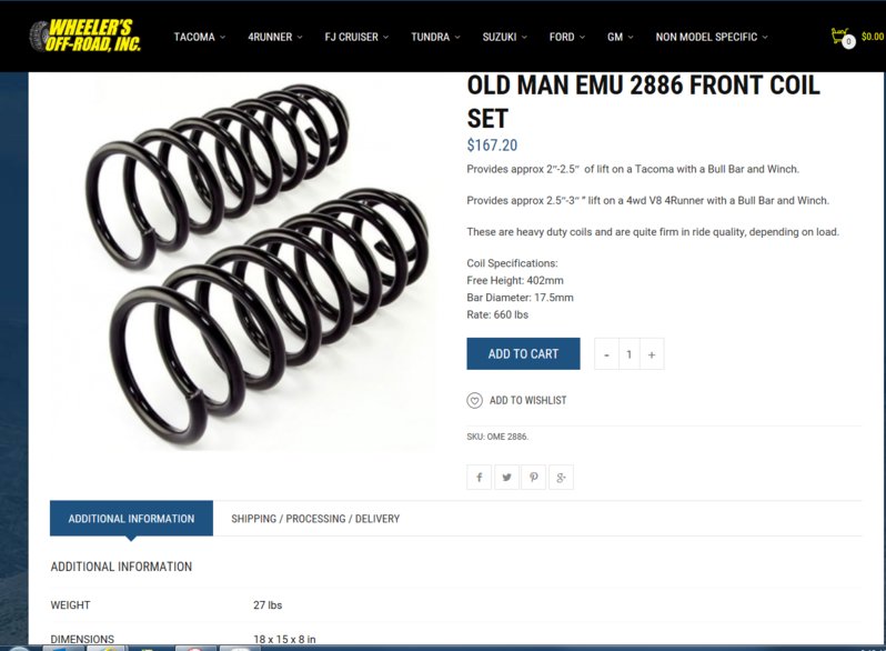

    I looked at both those options just now and what is currently throwing me off is the dimensions. The ICON's are 14x5x5 and the 886 are 18x15x8.
    Could someone please explain the difference? I don't want to get into this project wheels off and have something not fit. This is my DD and ONLY vehicle available.

    18x15x8? That sounds like the dimensions of the box two 886s ship in.
    Where did you get those numbers?

    Off Wheelers Offroad
