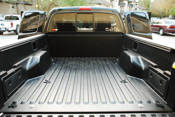

    Well just got finished with this today. It was actually easier than i thought and alittle different than all the other how-to's that are on here. I got the cheap D-rings from army supply and they work great. You have to make the hole on the D-ring bigger for the bed bolt. I used a T-55 TorX socket that i got from Advanced auto parts for like $3. On the bed bolt the washer is held in place by a set of ribs on the neck of the bolt so you have to grind those down to slide the washer off. And there was no thread lock or anything on these bolts they just torque down so it was pretty easy to break them free. So once you do all that everything just slides together and tighten everything back.

    i did the same thing using the bed bolts. nice job.

    nice, very simple.
