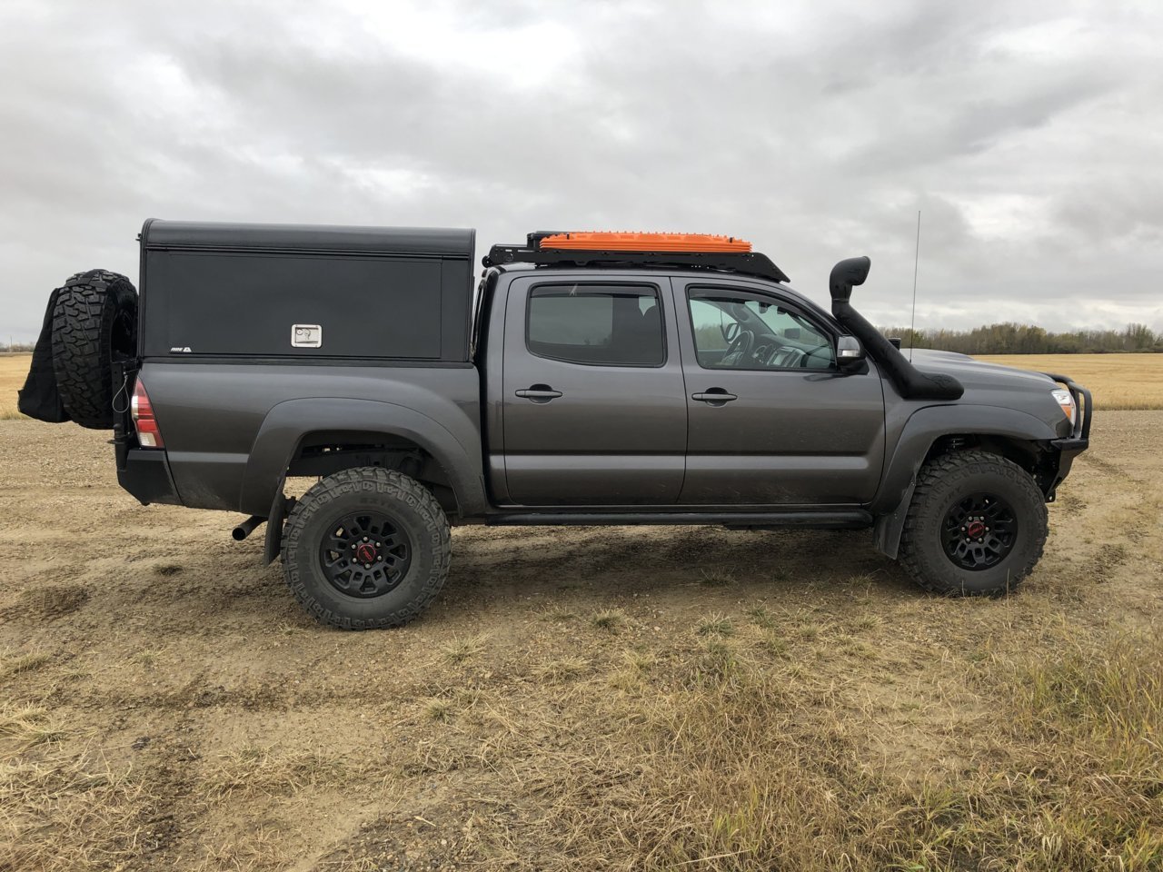

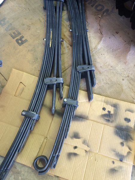

    I have the old CS047R (equivalent to EL96R) leaf pack with the the D29XL AAL. The AAL is the same as the 3rd leaf in the pack and it can go on top or underneath. I have been happy with my set up but it does sit level when I’m fully loaded for camping. Also, next spring I’ll have my drawer system and fridge installed which may make things worse. I’m going to weigh my truck to confirm weights and then decide whether I’m going to step up to the Deaver U402 stage 3 Expedition pack or maybe get them to build a custom pack.
    Springs when they were new and waiting to be installed.
    Truck unloaded.

    Dang that’s a good bit of rake unloaded
