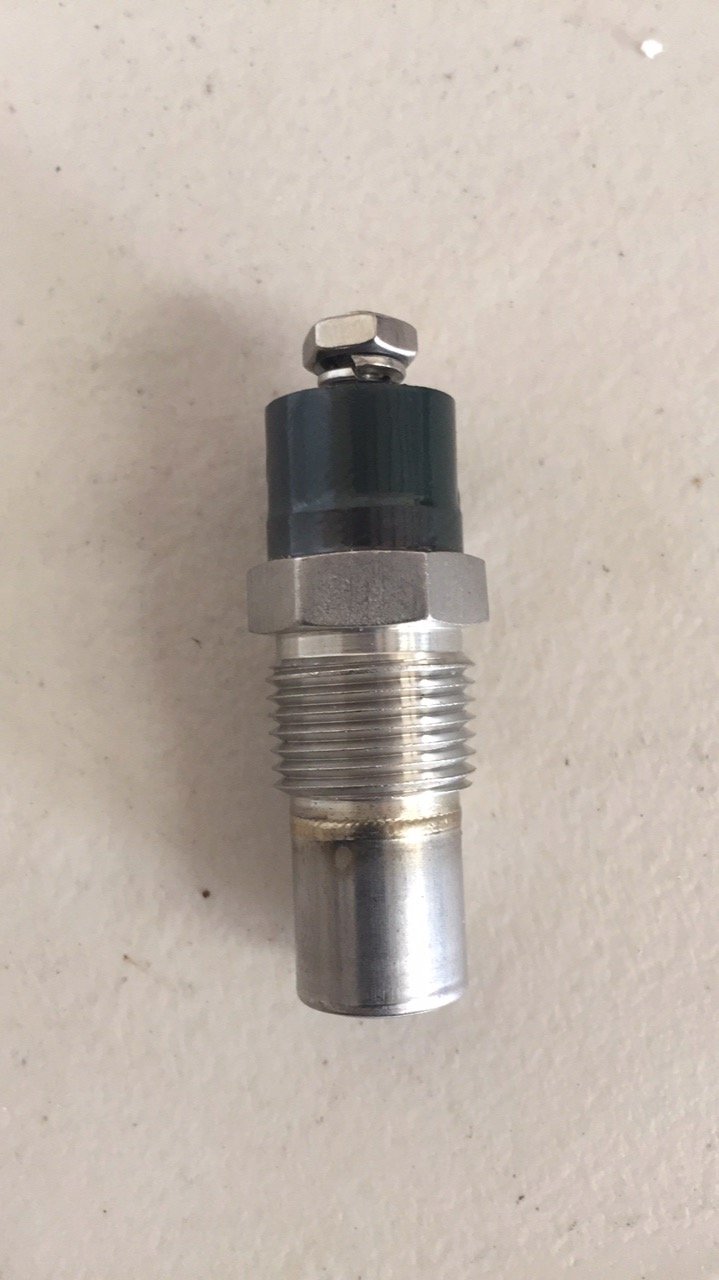

    Looking to see if there are any extra threaded ports to run an aftermarket fan sensor switch to the engine? I have a SPAL fan kit for a 2006 Tacoma V6.

    Here's a pic of the thermostat switch we need to find an extra port for.

    Find a piece of Stainless tube the ID of the lower Radiator Hose weld the proper size bung in the stainless tube .
    Put it all together .
    Good luck
