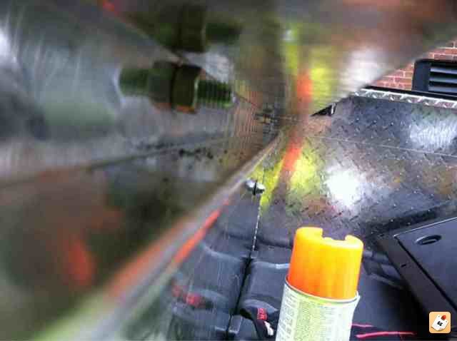

  5. Oct 31, 2013 at 6:32 PM

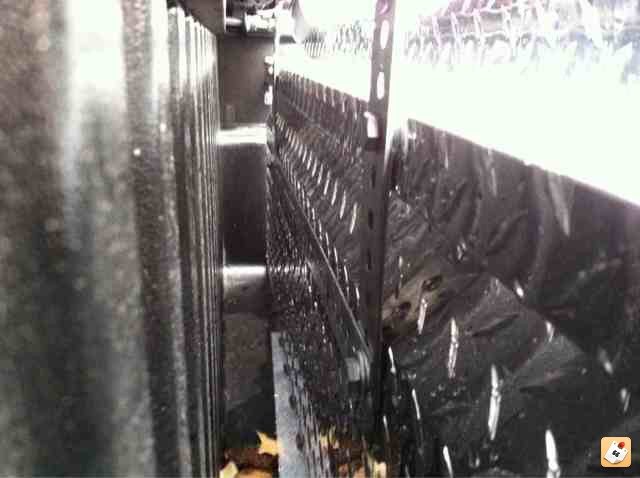

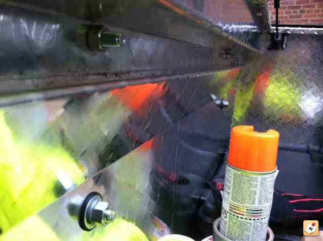

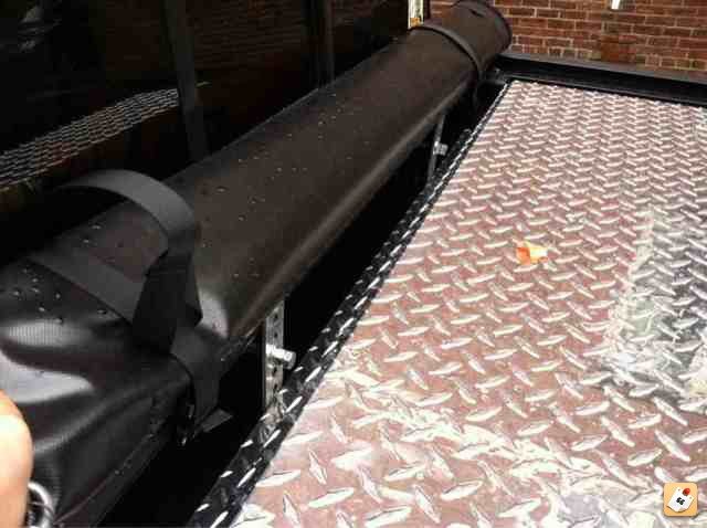

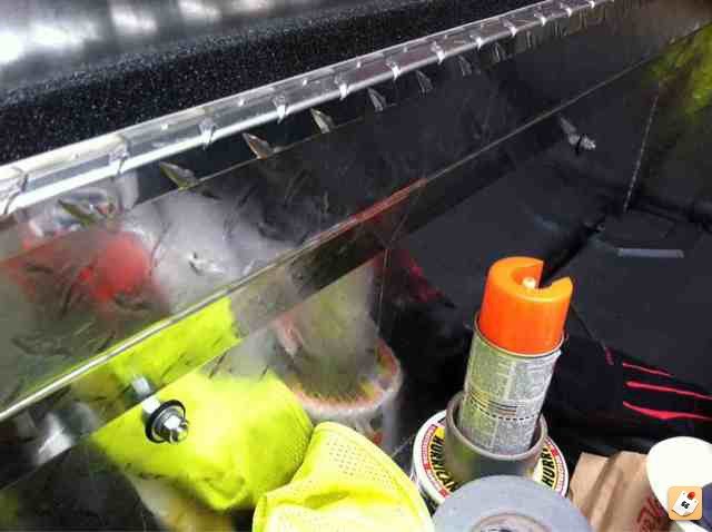

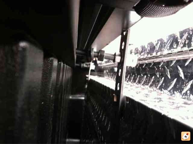

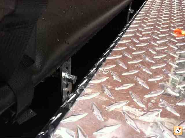

    Hope this helps some. I used 1/8" flat steel bar and 3/8" bolts, neoprene washers, lock washers, and nuts. I always use one size smaller on steel washers so they aren't as loose, so the ones I used are 5/16". The drilling into the box part was more or less easy.. I measured an found the height of the rails from the bed and then used the length of my steel to figure out where I needed to bolt it.
    The warranty for the box says more than 2 holes MAY void the warranty, and with two bolts it just didn't seem secure so I went ahead and put four. If it voids the one year warranty then oh well lol
    Attaching it to the rail was the hardest part. I found some 3/8" speed nuts that fit perfectly into the rails and catch the lip when tightened down. I had to use multiple washers and nuts along with a 3.5" long bolt to tighten against the steel bar an then tighten against the bed rail. I essentially used the bolt as a threaded rod. It's been on for almost two weeks and I have had no problems what so ever. Taken it off a few times and it's quick and easy by myself.
    Hope that helps! Let me know if you have questions. I can try to link a picture of the exact speed nut I used later.. On my phone right now and don't feel like dealing with it.

    Awesome photos, thank you!
