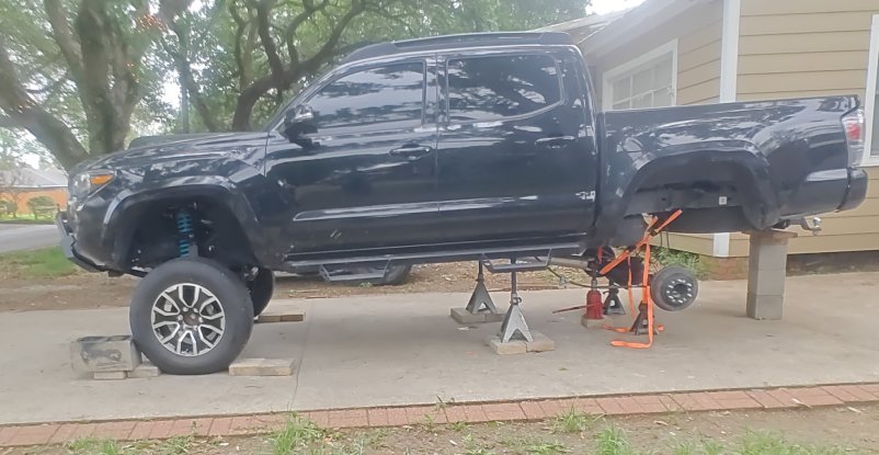

    Once I get the front height settled I'll order another custom set from Alcan, but in the mean time I need to figure out what height I need.

    Thats the plan. Front measures 44" ground to front fender right now. I tried putting 4.5" blocks and the rear was still about 2 inches too low. So want to try 4,5" blocks and 2" AAL to see what it looks like right now it looks like this... while waiting to figure out the rear height it's giving me time to put the extended brake lines and ABS sensor wires, etc..
    i do have some 3" blocks, I might try stacking the blocks and setting it down to see where that stands.

    it would just be to see what height the springs need to be, i wouldn't drive it like that

    oh, and before anyone says anything, the bricks under the draw tie and there for safety in case the jack stands fail, lol! surprised no one mentioned that :)
