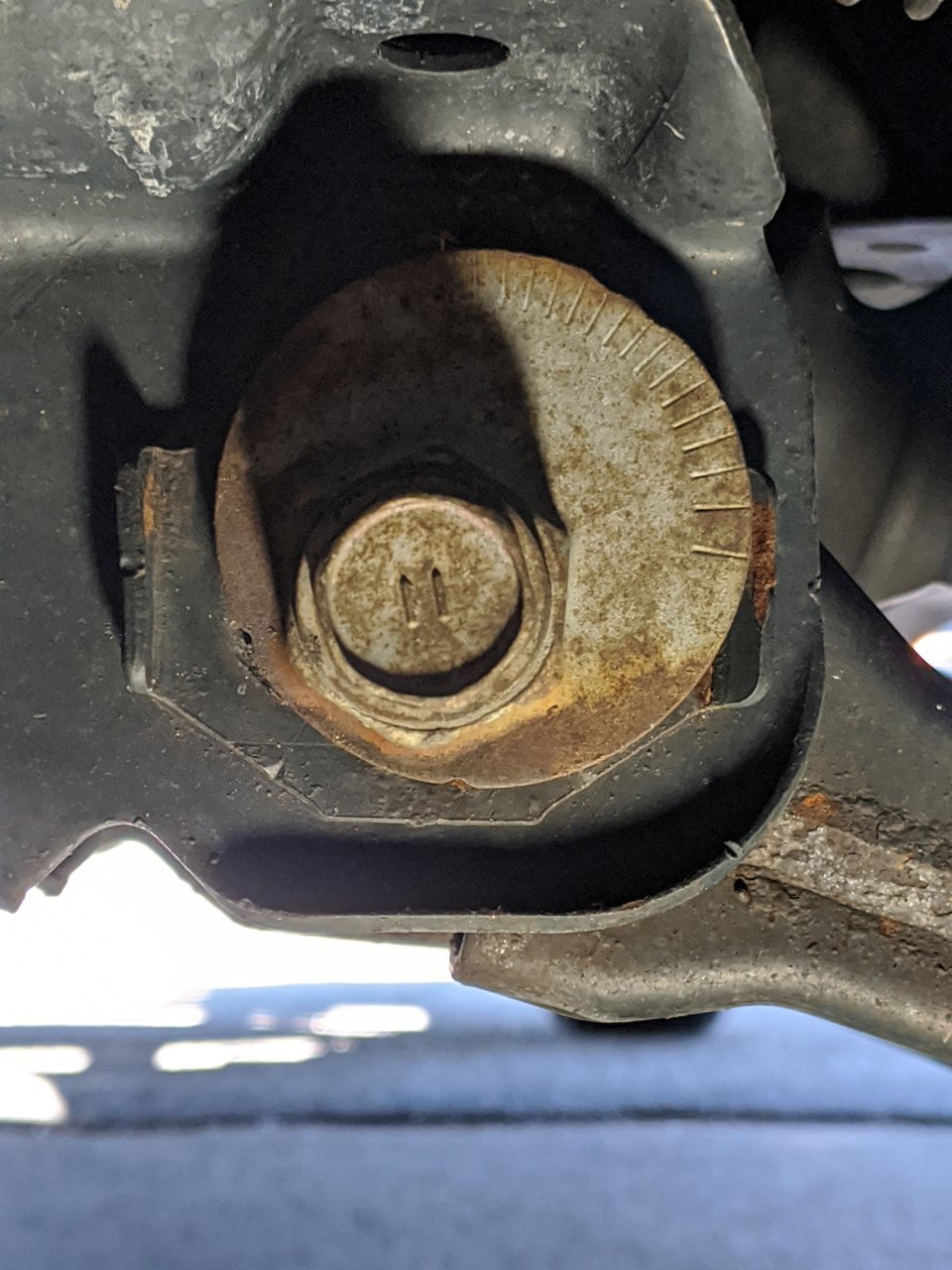

    How are the alignment cams? Did you mark them after the alignment?

    The alignment cams are the lower control arm bolts- they are eccentric and allow the lower arm to be adjusted into alignment (camber and caster). The tie rods, as you mentioned, are adjusted to set the toe.
    Sometimes when you get an alignment, the tech sucks and doesn't torque down the alignment cams, and they end up moving around.

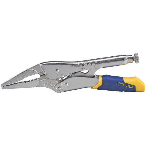

    A lot of people run without the sway bar but you should probably sort out the other issues before making that decision. One thing you will need to remove the links without damaging the boots is a set of these, there's not a lot of space to get behind the link to lock them in when removing the nut.
