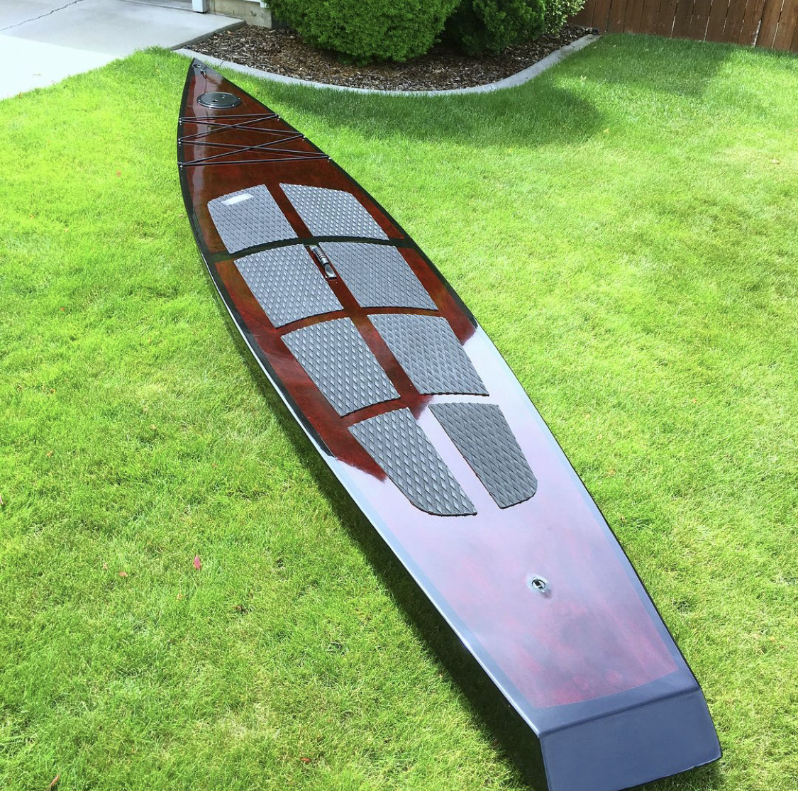

    Okume is a great choice. Made this paddle board for my wife. 30lbs.total weight. 3 and 4 mm Okume covered with one layer of fiberglass and epoxy. Quite waterproof. 14 ft long

    Wow that looks great, nice job

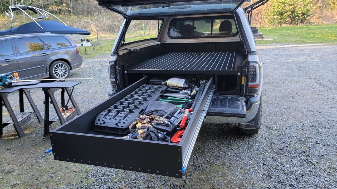

    Mine wasn’t that expensive but I didn’t use that material. I went with 1/2” finished plywood and OSB on top. I can tell you my set up is much lighter than the Deckd system. Plus they sit 3/4” hire than they wheel Wells.
    I just got back from a 3 day trip through south central UT and it’s the best thing for camp organization I had put on my truck. I highly recommend them if you are currently running something like Tubs.

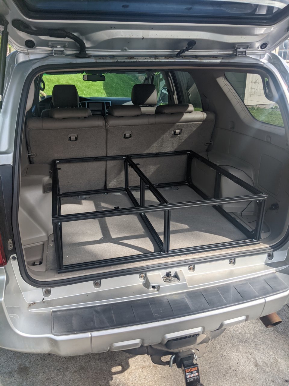

    Well phase one is done, everything fit just like I hoped.
    I ordered everything cut to length from Tnutz, kinda wished I'd used those cube connectors for the corners as it took a bit of planning to get all the captive nuts in the tracks ahead of assembly.
    Overall pretty happy, next stop is to find some drawer sliders and start working on a top.
