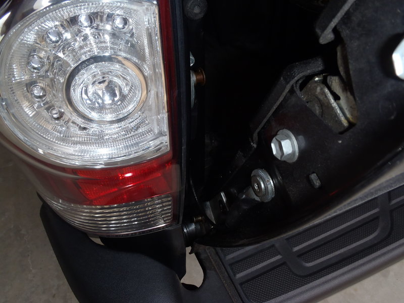

    I did the same thing, but utilized the factory clips (took time to do) and heat shrunk the thin cable. Never had a prob in 3+ years.
    I'll post a pic or two.

    File looks like the cable is pinched

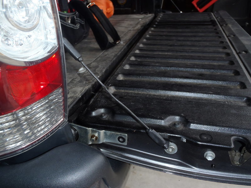

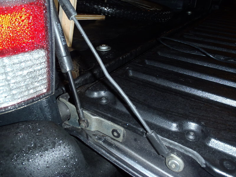

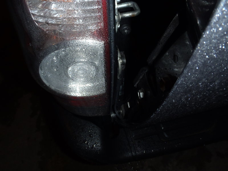

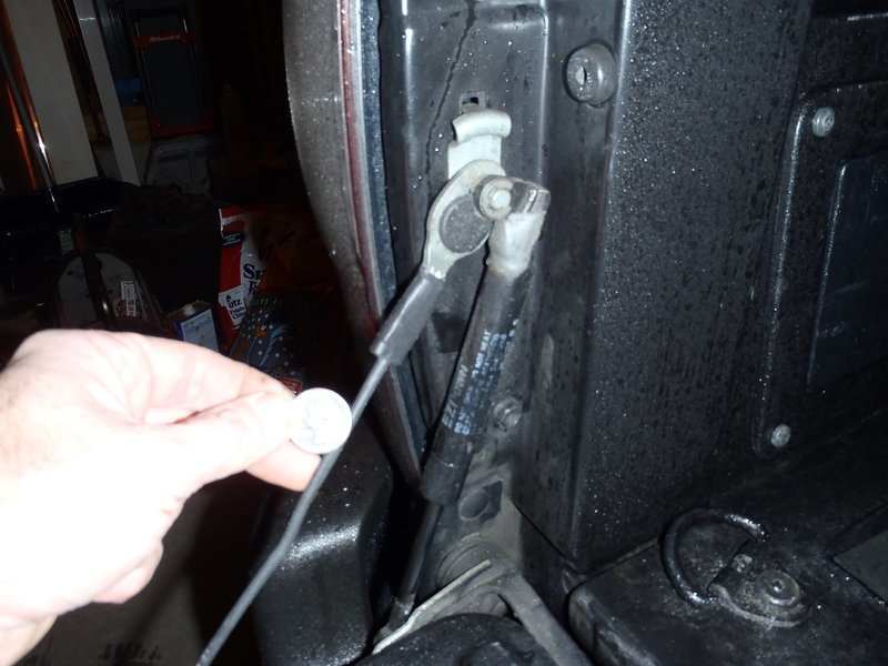

    The rubber was accidentally cut when I made it. For the fear or corrosion, I redid the coating a week after I made it.
    There are the latest pics from 10 minutes ago :)

    Danny, your cable was much easier to do, I'm sure. I think mine took over a fkg hour to split open the factory ends and re-press it :mad:.
    Your way is just as fine.... and quicker too :thumbsup:
    BTW, I used heavy duty garage door cable (not the thinner stuff).... It is flexible enough to bend when closed.
