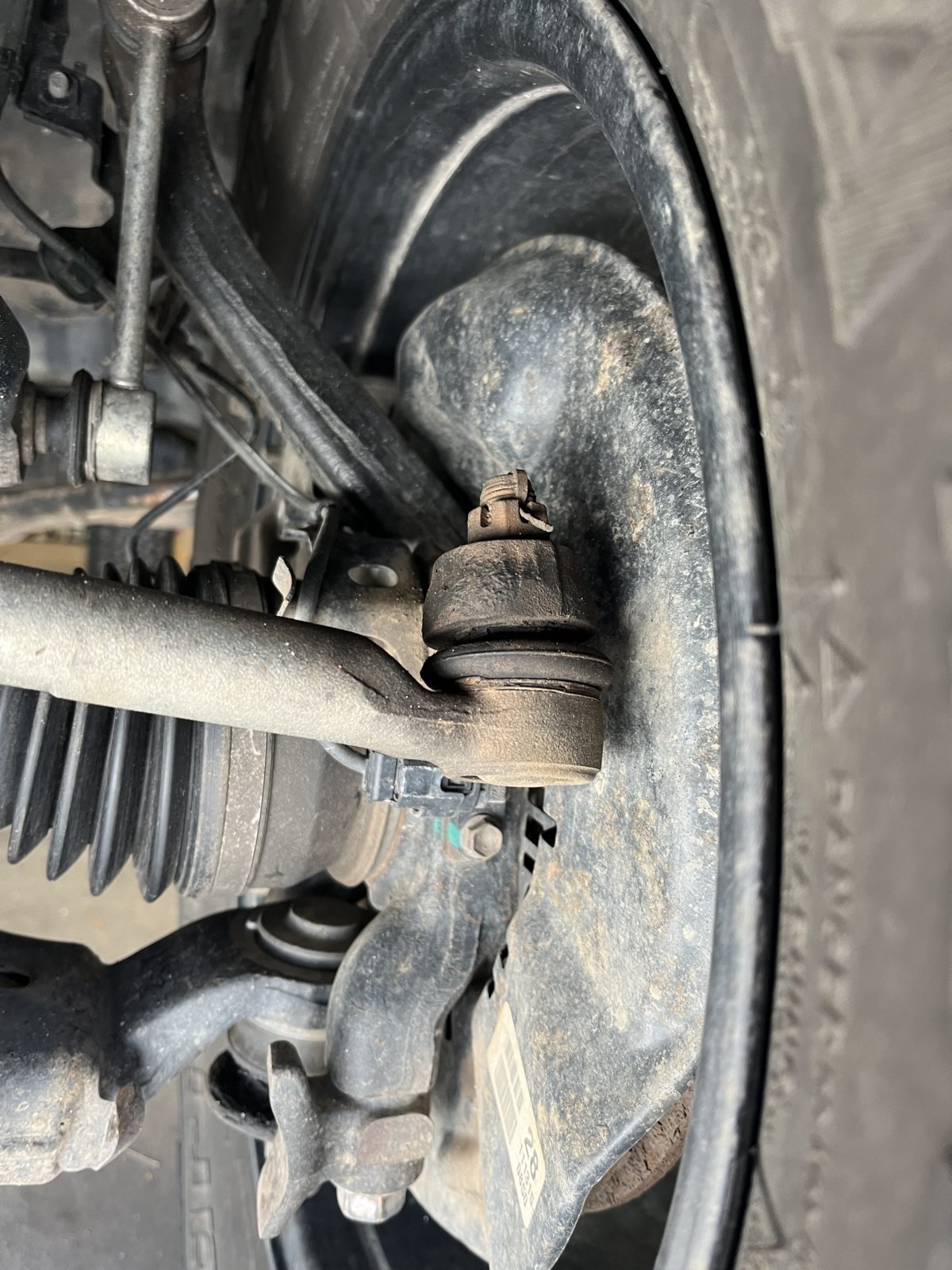

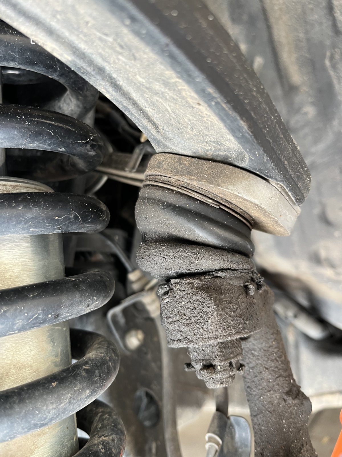

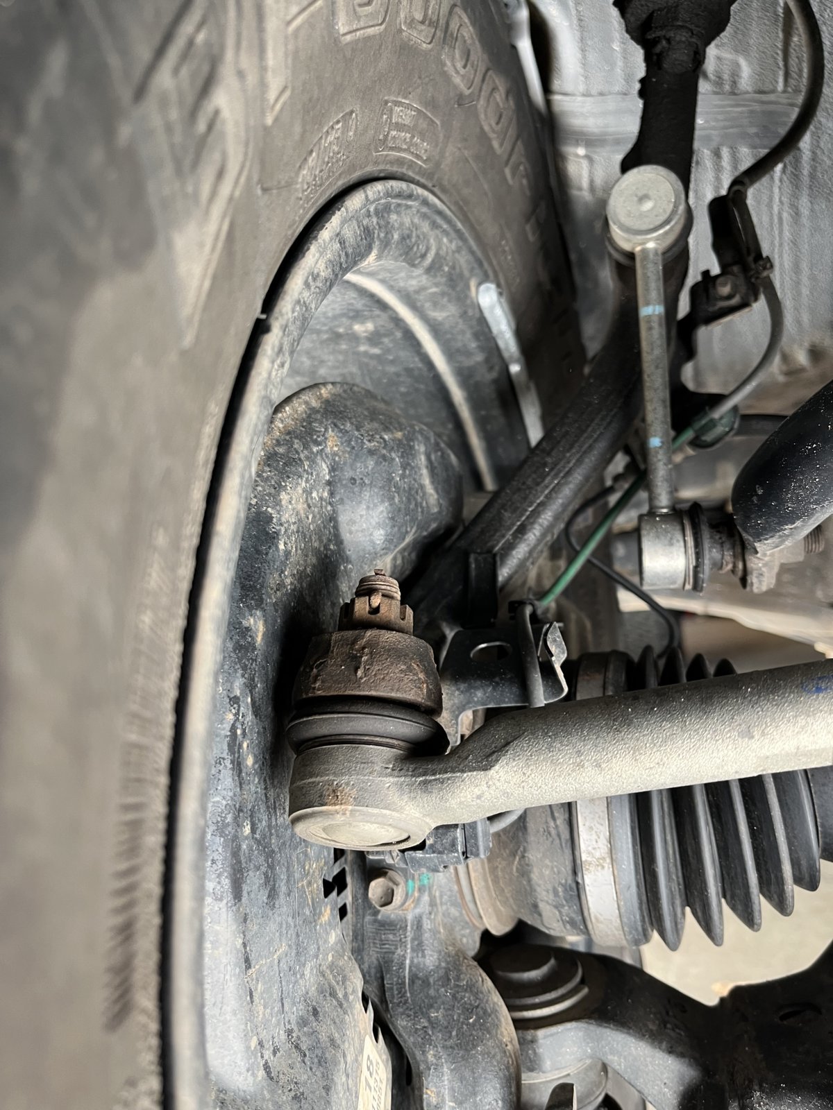

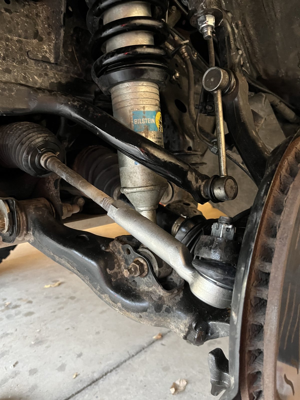

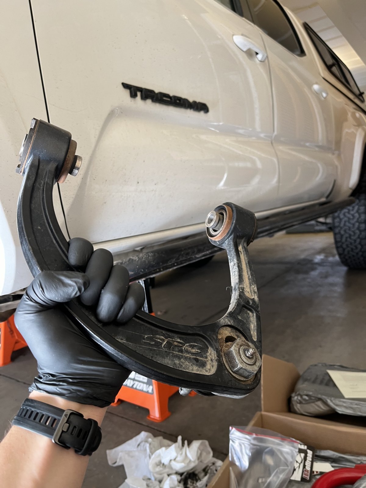

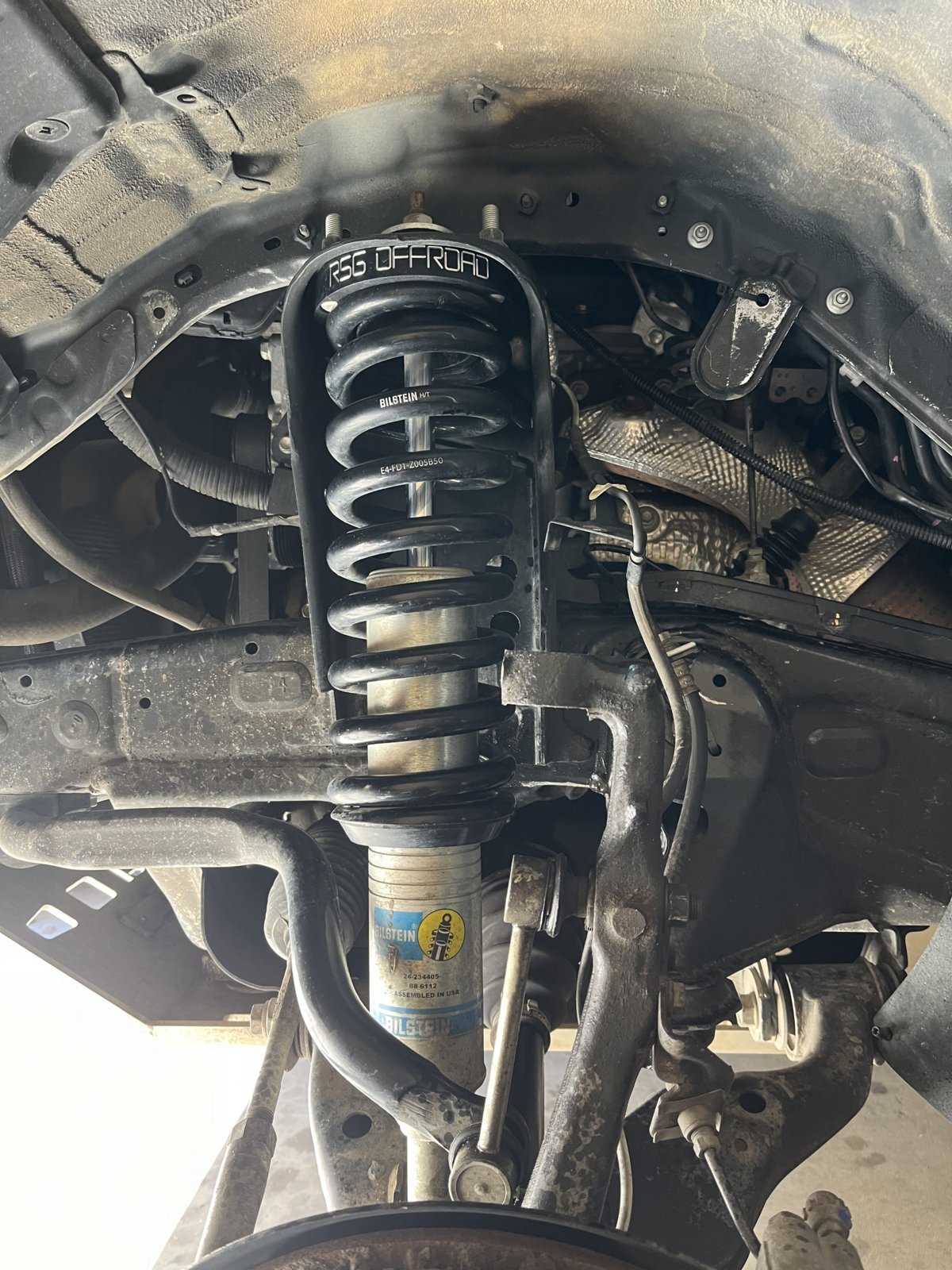

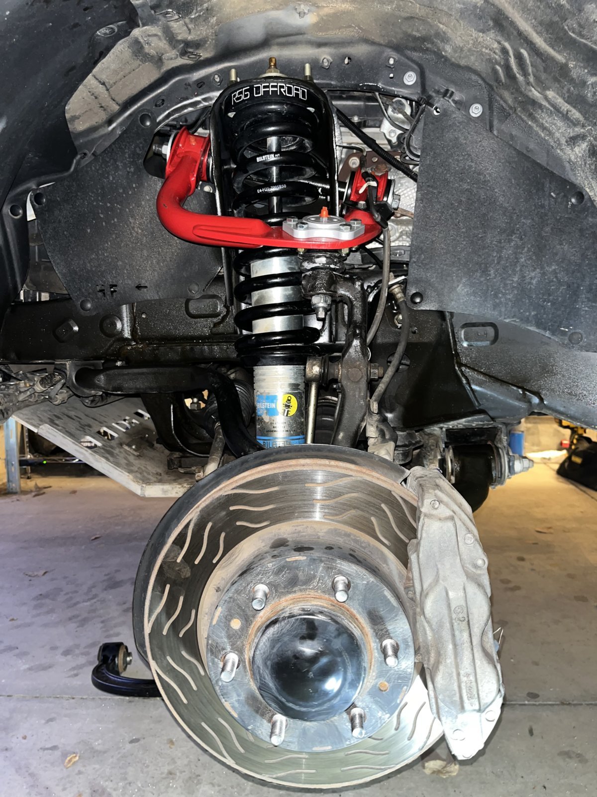

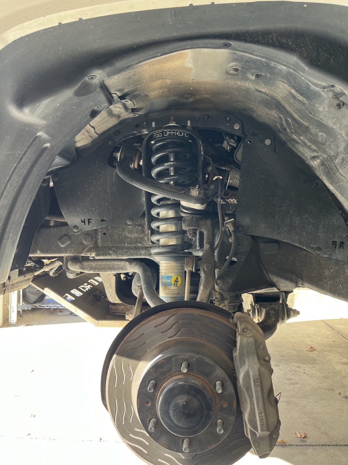

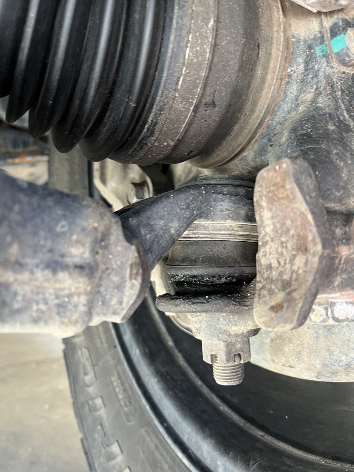

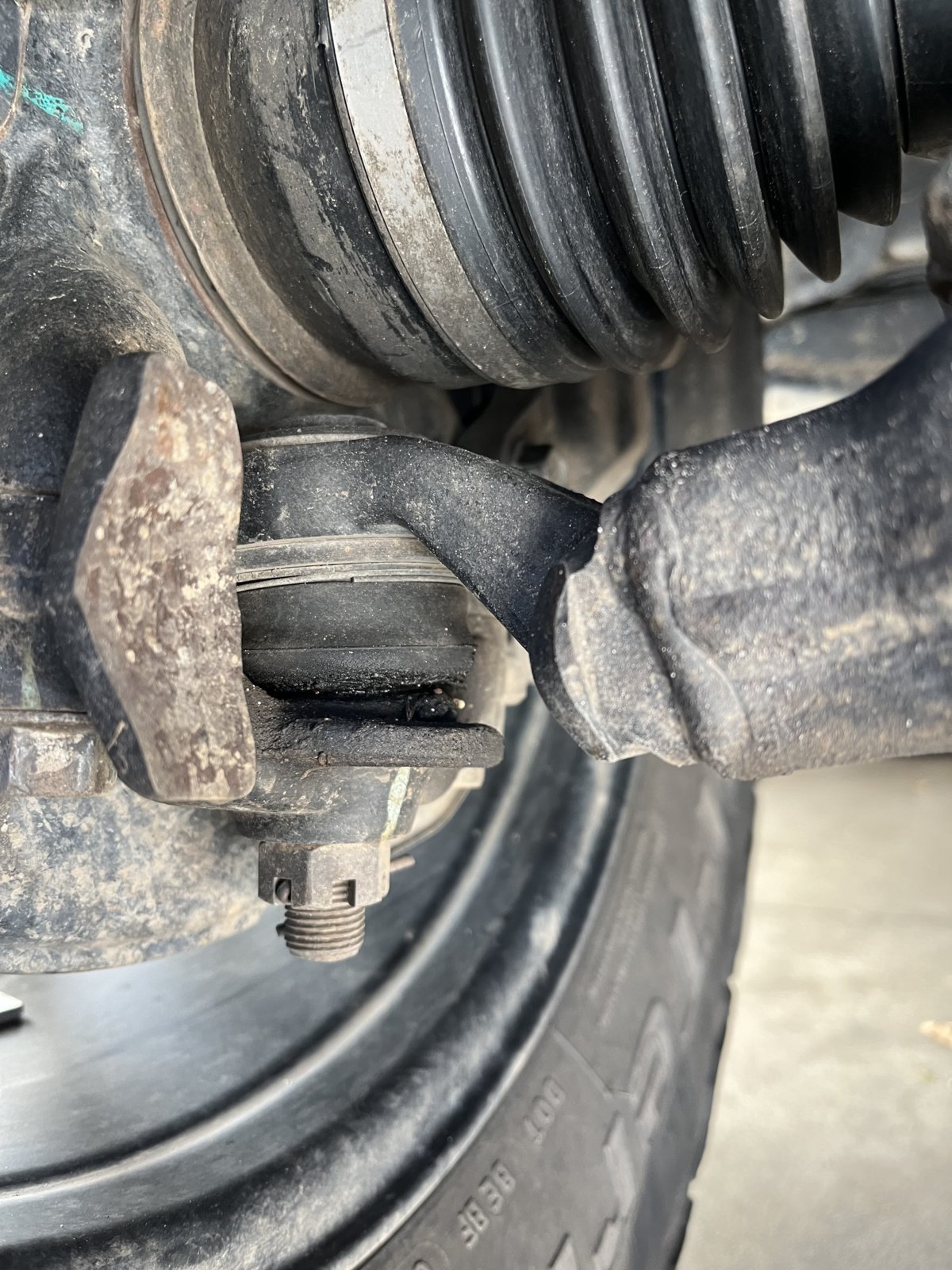

    Got around to installing my new JBA HD upper control arms and some new OEM tie rod ends. I replaced my SPC upper control arms with these JBAs since the SPCs developed play in the bushings at around 20,000 miles, which is ridiculous in my opinion. The new JBAs are awesome - really excited to test them out. The installation was straightforward since I had already installed control arms before, but the driver's side was a PAIN to get the inner washers between the control arm bushing and the shock tower bolt path. I had to use a pry bar to open it up and tap the washer in. Also, I ran into the issue of the driver's side jam nut on the tie rod being so tight that I had to run to Home Depot, snag a couple of pipe wrenches and a propane torch to get it loose. Luckily, it came loose because I had reached a point of no return when I hammered the ball joint out of the spindle and messed up the old end's thread.
    The install of these parts didn't fix my clunk/creaking when turning at slow-to-no-speed or the stiff turning near full lock when not moving. Taking it in for alignment tomorrow at RSG Offroad and having them do an inspection of the steering to see if they can diagnose the issue. I think it may be bad CV(s), something with the steering rack mount, or bad inner tie rods, or maybe bad lower ball joints???
    Old Crusty Stuff:
    In-Progress:
    Finished Product:
