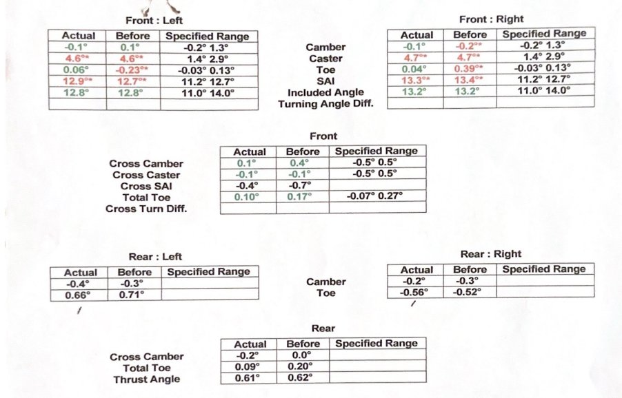

    After the recent trip to Moab, @LunarTaco13 noticed my truck was tracking oddly and that it might need alignment. Specifically, my front was tracking more to the left than the rear was. See below pic:
    When I initially bought the truck I purchased a lifetime alignment from Firestone for like $170, which worked great while the truck was in its stock form, but ever since installing the lift & aftermarket UCAs, they have never been able to dial the alignment in properly to fit the 33s. I have taken my truck to RSG Offroad here in Denver for the last 1.5 years and those boys have been dialing her alignment in perfectly, but I now live across town from them and figured why not try Firestone again since it would be free and much closer to me. I also figured that my JBAs would be easier for them to align since they have no adjustability (unlike the SPCs).
    So I made an appt at Firestone yesterday & took her in. They got her aligned quickly, but the test drive home was comical. The tires rub so bad on the cab mount now that I literally could hardly turn full crank either direction. Backing up was especially difficult, haha. I've got an appt with Tru Automotive, another local Toyota specialty shop here in Denver Friday to get it fixed.
    Firestone isn't a bad company, but I don't recommend ever taking a rig that needs a very specific alignment to properly run bigger tires to them.

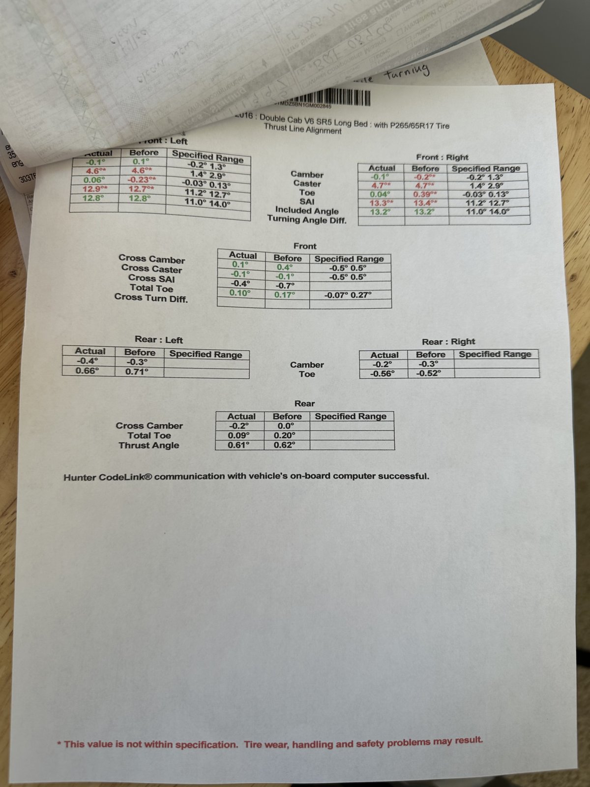

    I can totally relate to the whole spending millions on alignments thing.
    I have all my work done at a shop that specializes in lifted Toyota trucks. My truck has a much less severe version of what you pictured. The owner of my shop referred to it as “dog tracking” and said an alignment won’t fix it because it’s an axle issue caused by the aftermarket lift and how it affects the truck. You probably already knew that but figured I’d throw it out there just in case!
    It is fixable but I can’t remember what the fix actually is, I just remember it’s expensive so I just left it alone on my truck because I can’t even notice it and the truck tracks fine.
    https://www.tomorrowstechnician.com/dogtracking-bent-frame-understanding-the-thrust-angle/

    Thanks for sharing this article! Super helpful. I just went down to the truck and grabbed my alignment specs from Firestone (see attached pic). Right now, my thrust angle is 0.61 according to their measurements, which seems high based on my research.

    Well, boring update... My alignment woes continue. Tru Auto got the rear thrust angle fixed by using a come-along to shift the axle back to 0.03°, which is awesome, but I think they got confused and thought I was only wanting the thrust angle fixed when I was actually hoping for a front alignment too. I picked it up as they were closing Friday, so there wasn't time to ask them to fix the front then, but they are getting me in quickly to add some caster so that I'm not rubbing on the cab mount anymore. It's a bummer that I have to take it in again, but I appreciate them getting me in and fixing the mistake.

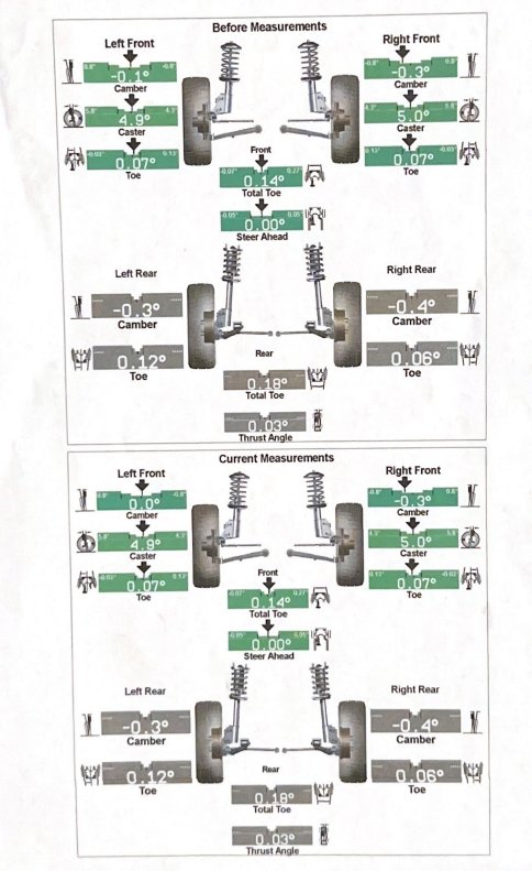

  18. Mar 4, 2024 at 5:27 PM
    #78
    Tenmile Tacoma
    Tenmile Tacoma [OP] IG: tenmile_tacoma
    Mar 19, 2012
    #75182
    519
    Nate
    Colorado
    2016 DCLB TRD Sport 4x4
    F&R locked on 33s
    The alignment FINALLY is dialed again. I guess third time is the charm, haha. Tru Automotive got her aligned perfectly - the thrust angle was fixed the first time around & on the second alignment they got the front aligned to not rub at all during full lock & while under compression (at least on road / going in and out of the driveway). I took some pictures of the alignment specs before & after. I am mostly posting here so that I have an account of the current alignment spec so I can tell the next shop to please align to them.
    Before (Original alignment done by Firestone, thrust angle way outta whack):
    After (After Tru Auto aligned it twice, the first alignment fixing the thrust angle & the second alignment fixing the front tire rub on cab mount):
    MR E30 likes this.
