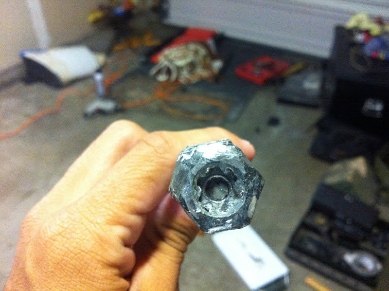

    Yea so one of my bed bolts just didn't want to play nice today. Dremeled the head and stuck a socket on it to get it off.
    To the guys with the newer trucks (2009+), are your bed bolts rusting? I believe it was the 2009 and newer beds with the lighter colored bed bolts.
    Anyways, anybody have the part number for the newer bed bolts (not the older ones that were dark colored).

    Same thing happened to me. That thing was locked down! I finally had to cut it the way you did! Got a new one at the stealership for $12!

    Would it be possible to heat them before removal? I would think that there would be some type of thread locker on these bolts. Just a thought. Might save someone a little change in the future.

    ^^ i think so... my friend is a mechanic and he had some powerful cordless torque drill thing.. impact wrench??
    cant you also spray some clear coat to help prevent some rust in the future as well?
