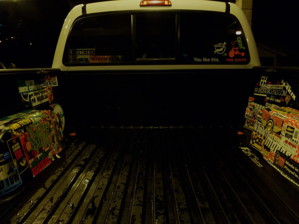

    08's came with the silver painted bolts too. mine started rusting too. so i painted them orange. Bedstickers_a2040f7ee5fe7687a7a2e4b8c2a166ad2337ad0d.jpg
