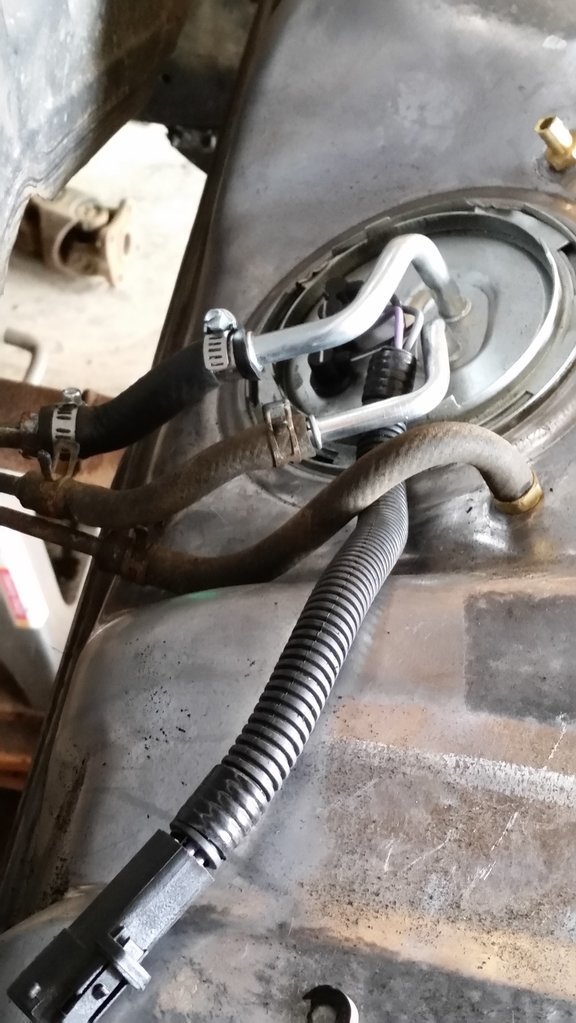

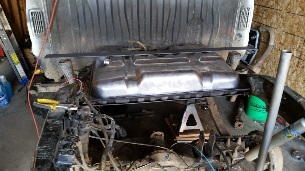

    You can locate the tank differently than I did but the sane ideas apply for plumbing/wiring. Just hose clamps from the hard lines to the Ford pump/sender and splice the wiring in. Add a couple of barbs for the stock evap and you won’t get any codes. The pump even came with a wiring diagram. Bend the float arm 180* and the gauge reads mostly right too. The Ford fuel gauges read resistance opposite of Toyota gauges.
