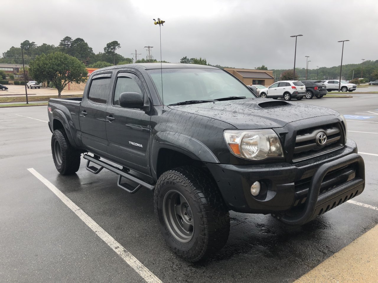

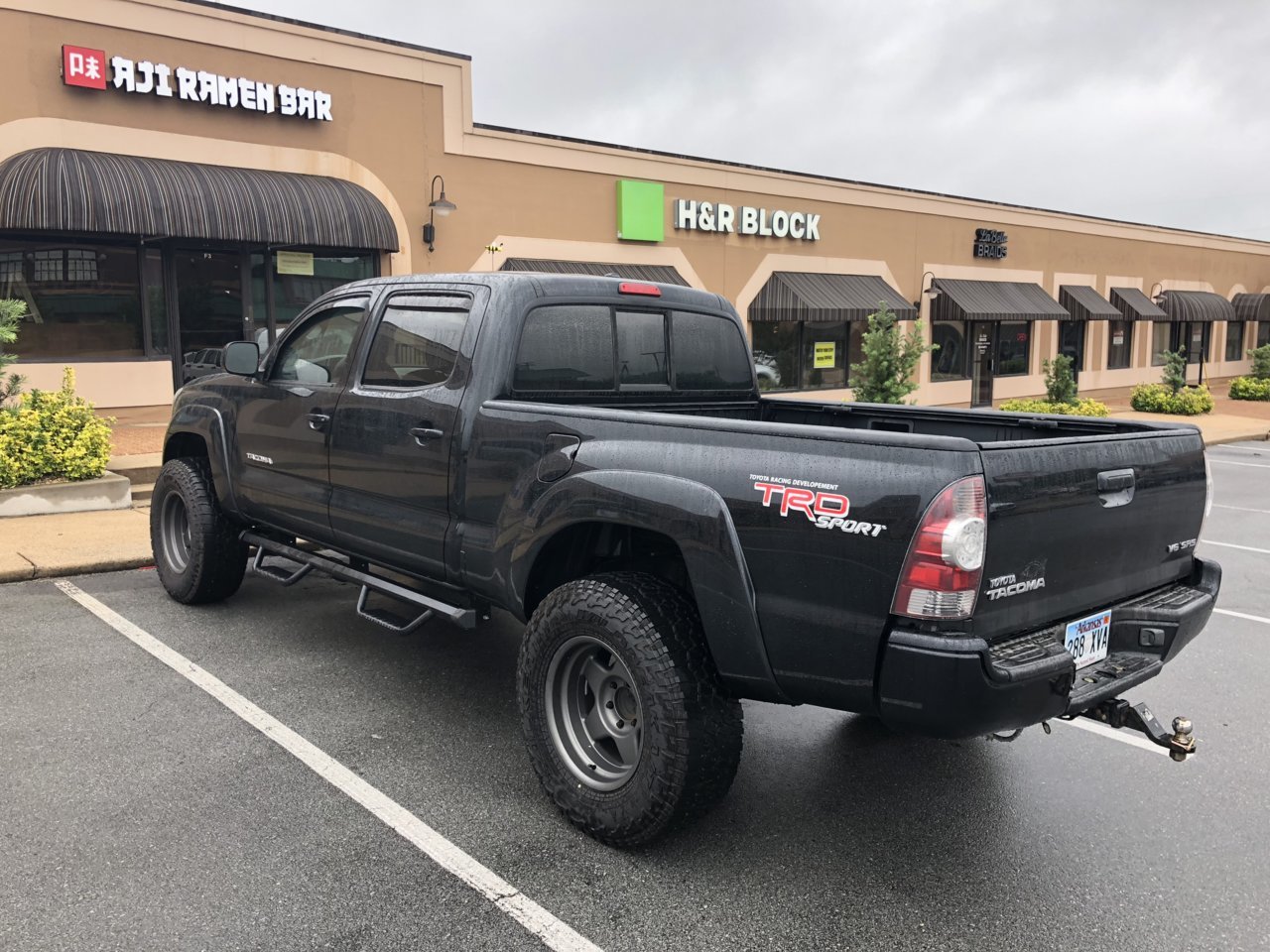

    F5 17x9 -38 rub like crazy
    I have 2.5 leveling kit spacer but still rub.
    How much lift i need to do in order to get full turn without rubbing?
    I do 0 offroad just all paved driving
    Really dont want to do uca upgrade or diff kit

    Lots of cutting. Dont think more lift is going to do it.... new uca will definitely help.

    Cut the inner fenders, cab mount chop, and try to get more caster from your alignment to push the wheel forward.

    Looks awesome! Did you trim the bottom inner corner of the plastic fender flare.
