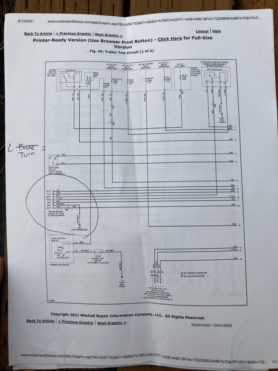

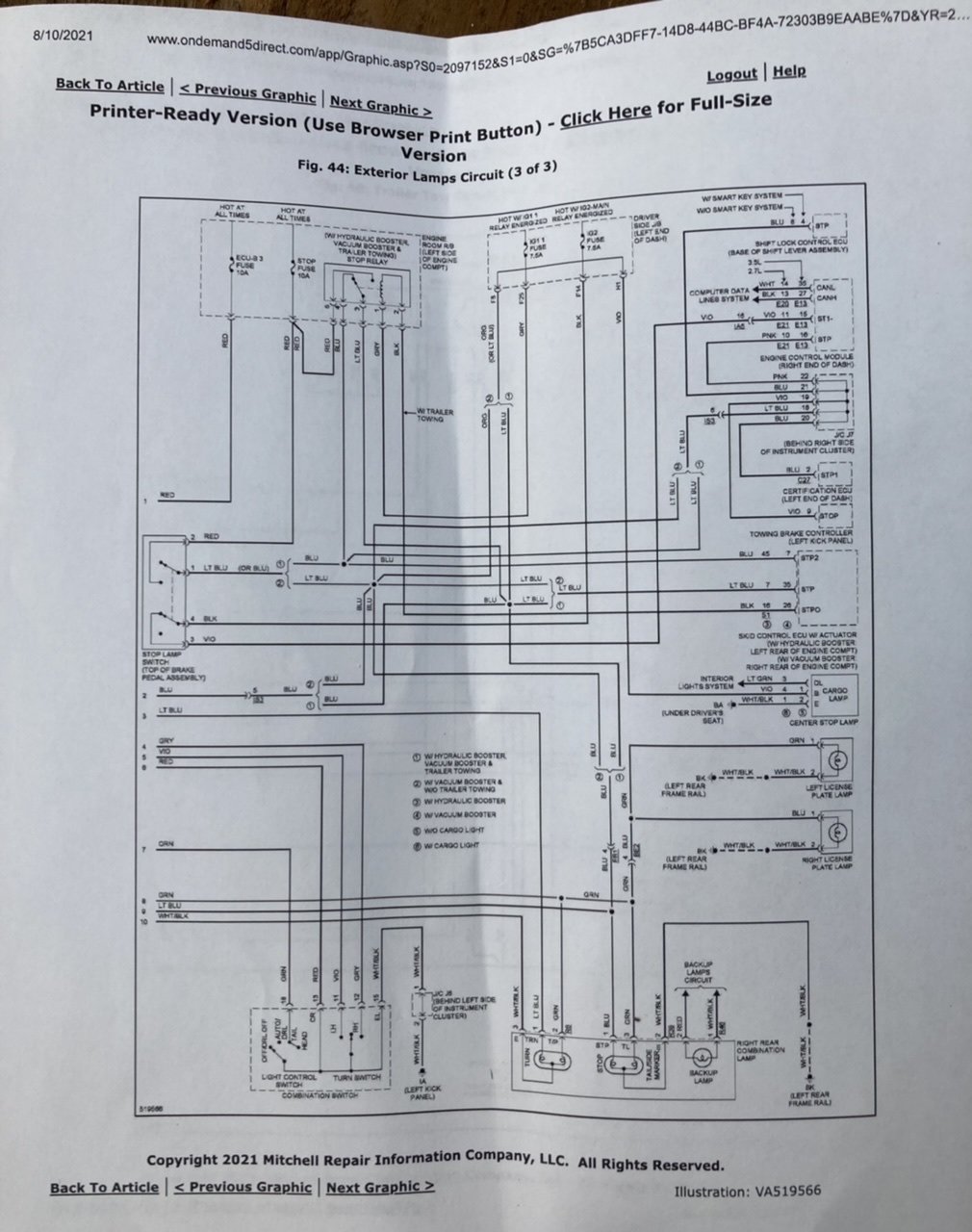

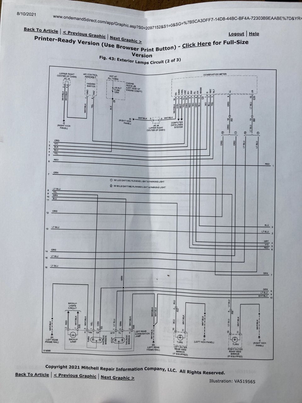

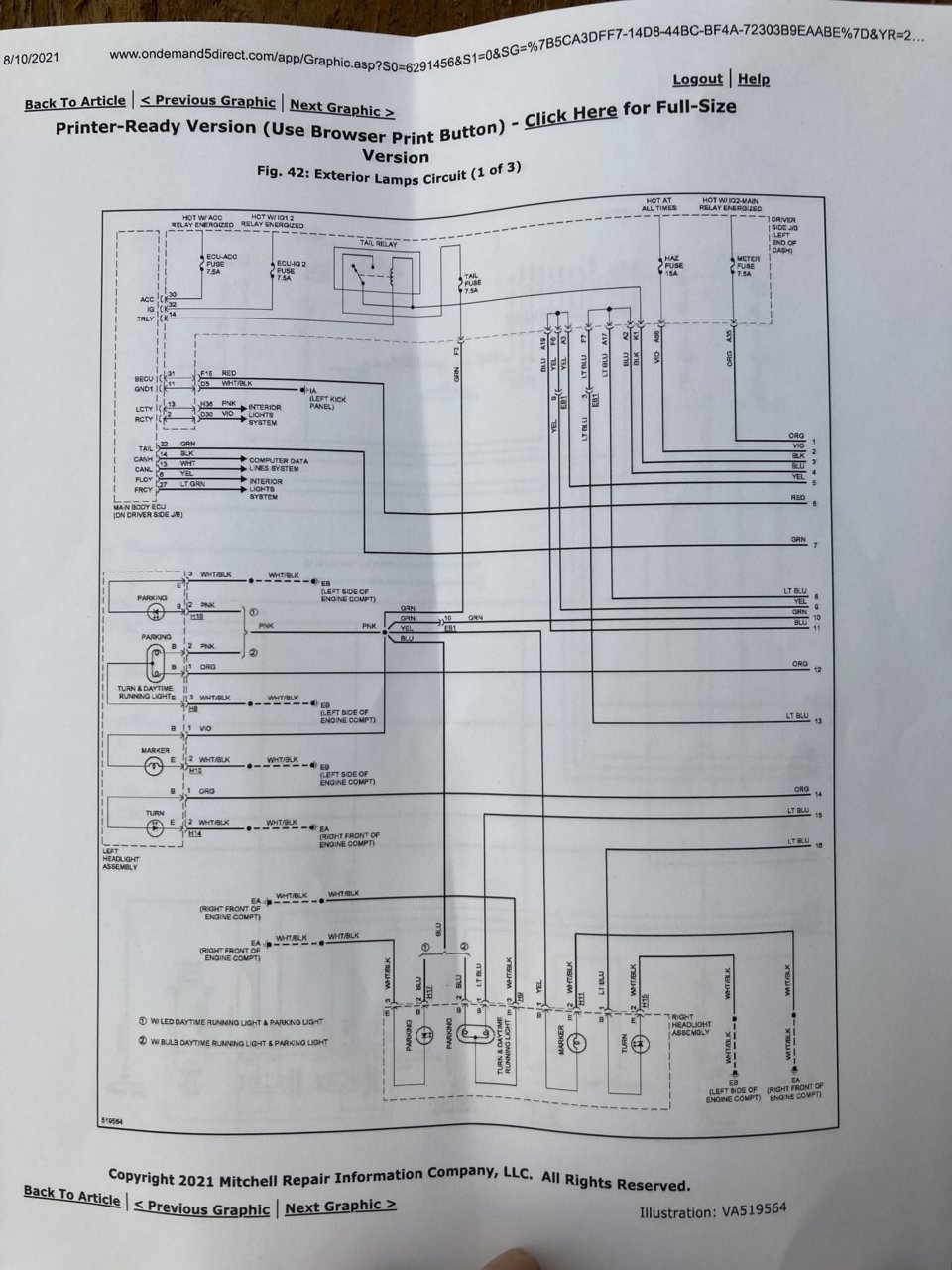

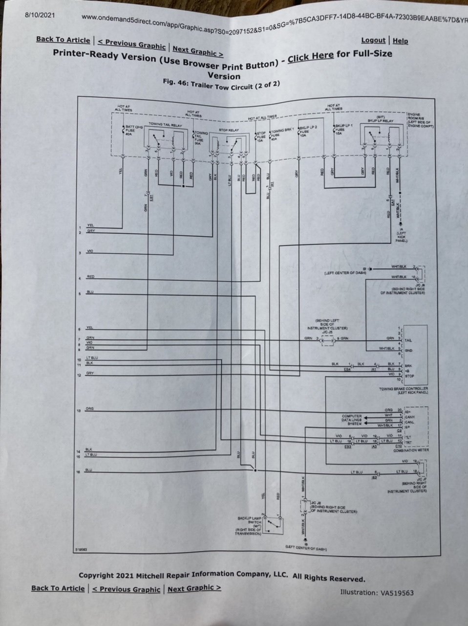

    Here are some wiring diagrams a smarter dude at Napa dug up that apply to recent Tacomas, depending on the manufactured stock trailer (wiring) options. I was able to splice each wire from the new harness (attached) right into the existing truck’s wiring. Thank you for those who contribute to these threads. Hopefully these diagrams will help contribute in return.
    Cheers and thanksA4216DCD-6A6F-4ABC-B4F9-0AE92FED1B59.jpg 29F91B10-78ED-44BF-A10A-6C7590213F67.jpg B1623753-5292-4C62-A64B-BD0B9D839673.jpg 0176BF2E-4E63-4FCC-9814-714A10714720.jpg BF22DCBF-28AB-49E9-A29B-CEE4342A4765.jpg 492DC758-CCC1-44FA-AD27-3E1EC59B3C8D.jpg 998DC9AB-143C-4F7E-83FF-CE26A3B5D14A.jpg .
