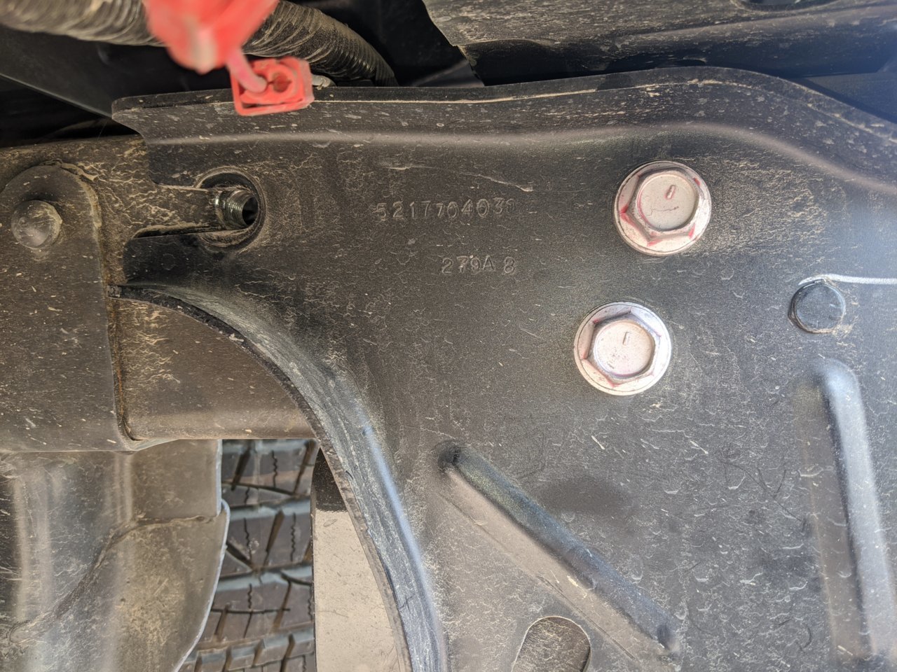

    ....even though Fab Fours website and 4WheelParts.com website says it does. Please save yourselves immense frustration and do not order this bumper until they have created brackets that accommodate current models.
    The bolt configuration on the stock receiver is not the same as the the previous years (2016, 2017 and 2018) and therefore do not fit. 2019 SR model has 2 bolts on each side instead of 3 in previous years. IMG_20200228_151318.jpg See photo below.

    Looks like you've got a bolt missing in that pic? Just below the red thing.

    @Culturekid is this a picture of the new bumper mount or old number mount?

    Good eye, looks like it fell out recently (based on the surrounding dirt)

    The bumper brackets typically have a short pin on each side. Your supposed to leave the bolt that is missing in the photo loosely threaded in, slide the bumper in at slight incline angle so the brackets accept those loose bolts, then drop the bumper to rest on the small pins. That holds it in place to get the other two bolts in. That way you don't need two sets of hands.

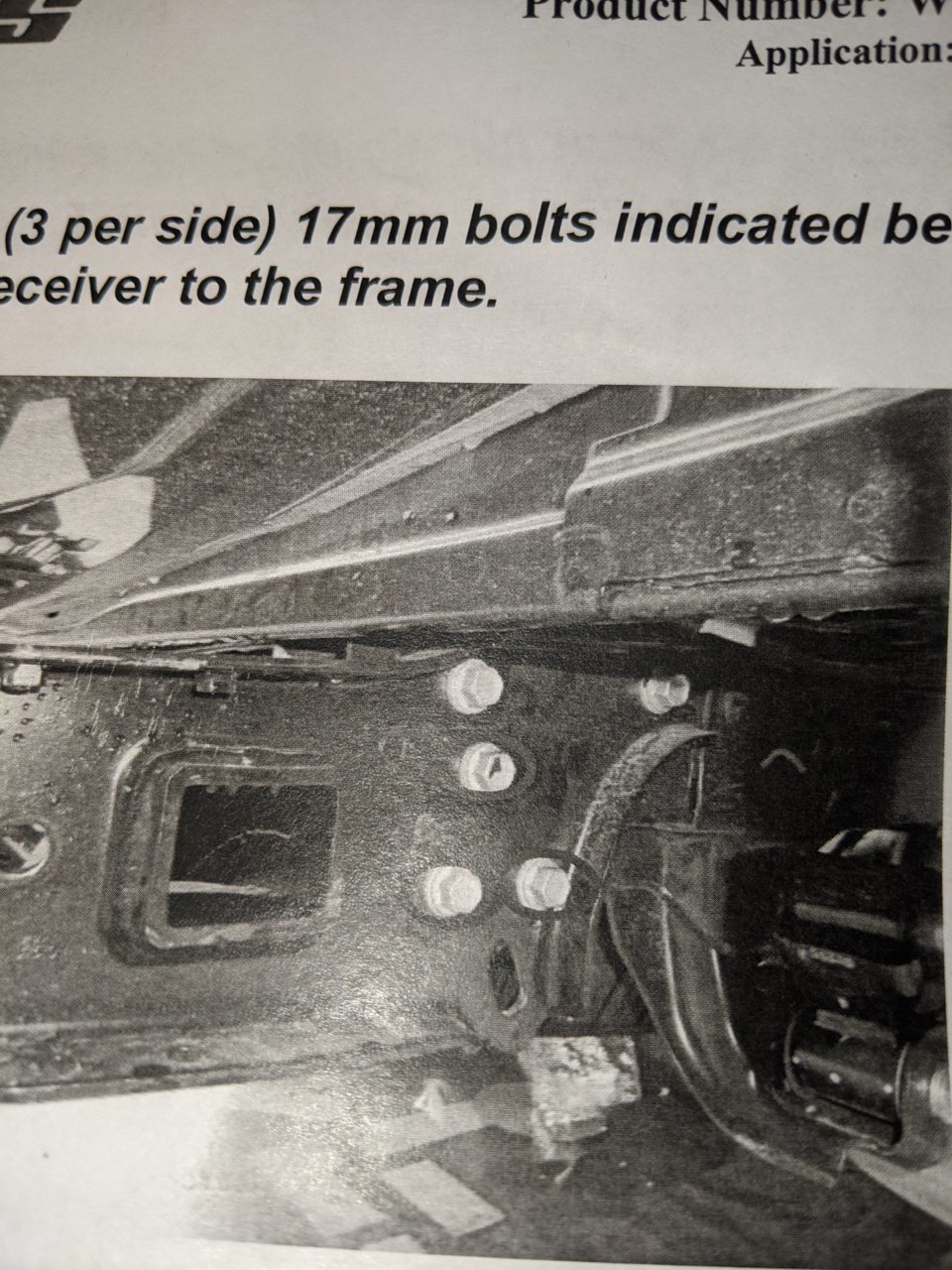

    Yes...I took out all three bolts and only put 2 back in before taking photo...notice that there is only 2 bolts in the above configuration cluster and 3 in this one. Below is the photo from the installation manual for the bumper that shows a 3 bolt configuration cluster! WTF?

    Yup...theoretically this would work if the bracket sent with the bumper had 2 holes and not 3.

    ...... Don't don't use one of the bolts?
    ...... Drill the 3rd hole?

    Having a hell of a time getting that bolt back in BTW. Any suggestions?

    Did you tighten the other bolts all the way down?

    Spacing in the configuration does not match....cant just drill hole...it would need to be threaded too.
