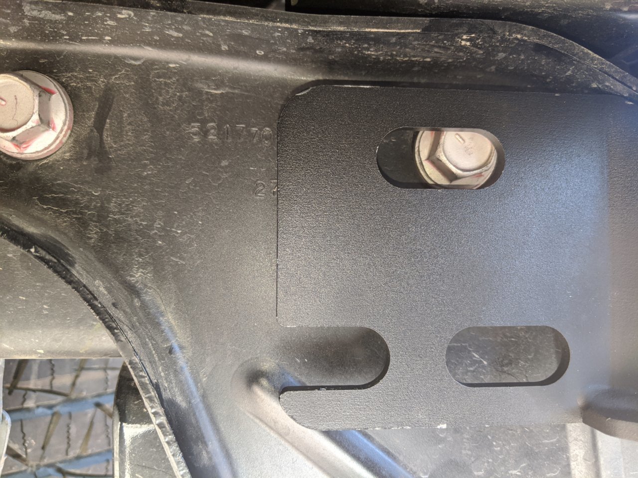

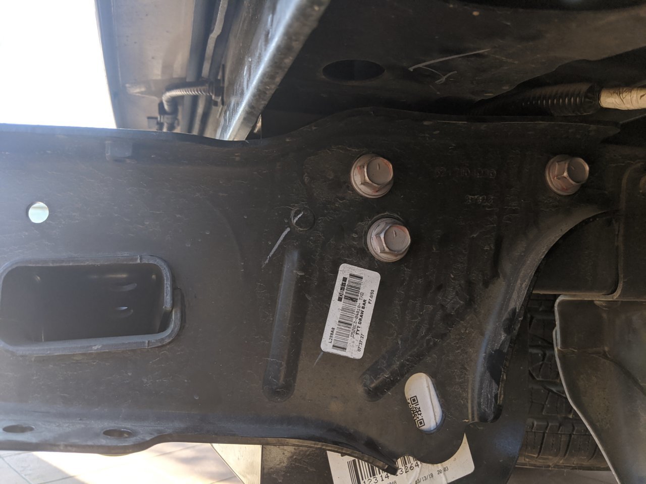

    So...here is a better shot of the the component in question IMG_20200229_091414.jpg
    Here is a shot with the Fab Fours Bumper bracket held up to this component:
    the bumper bracket requires this configuration:
    The bracket would not even sit level if I could use the top bolt hole with my component. It appears that the factory tow package replaces this whole component and would require different, threaded bolt holes in the frame. I do not believe that it would be worth the effort/money to install a factory tow package.

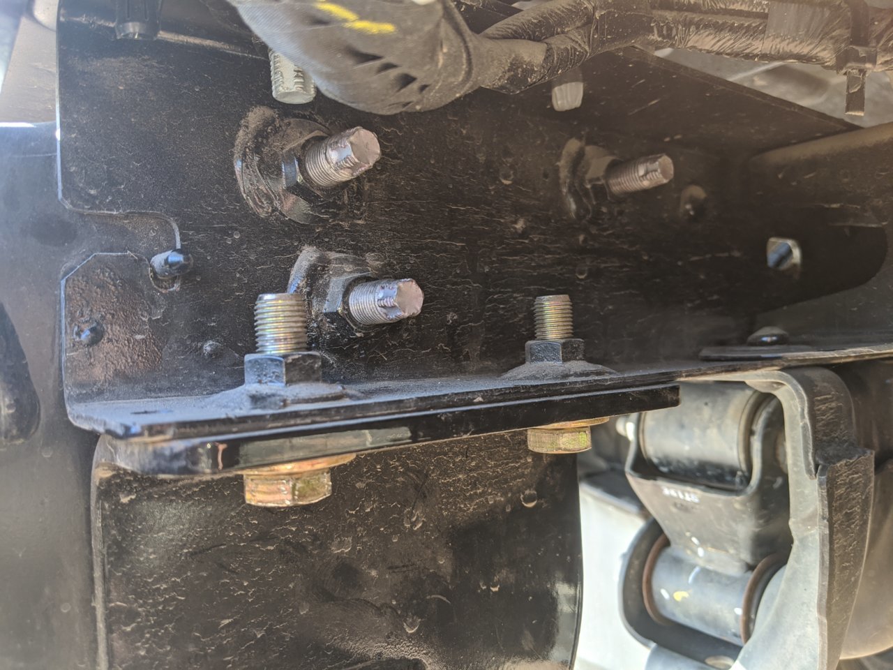

    Below is where my CURT reciever hitch connects to the frame:
    Removing it would not help me with bolting bracket to frame.

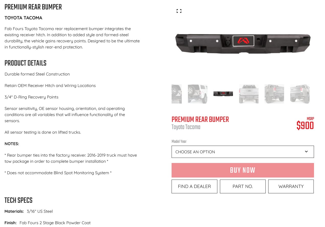

    SOLUTION: I need to buy a rear bumper with an integrated hitch...assuming that it will not also need the 3 bolt configuration that the Fab Fours bumper needs. I am very open to hear suggestions...othewise, it's back to shitty, shatterable when barely touched, plastic stock bumper :(

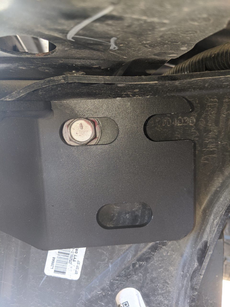

    Here is a picture with the bracket right side up on the right side of the vehicle...still makes no difference. IMG_20200229_100354.jpg

    the weld is on the bottom in the photo in post #70

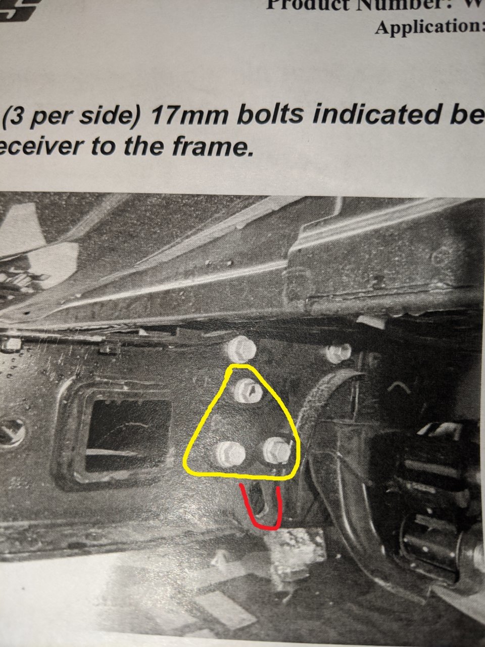

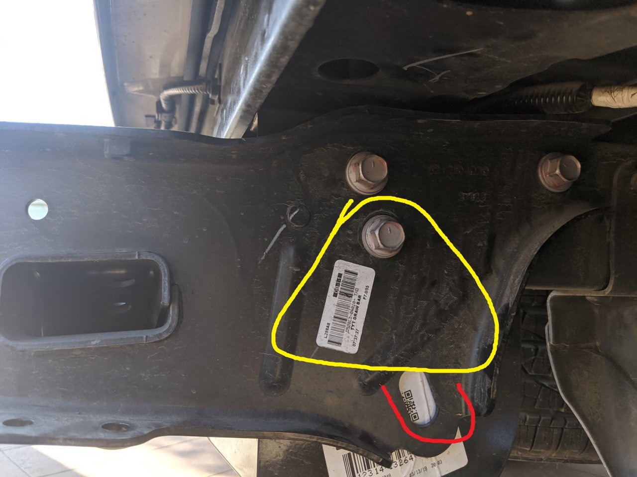

    @Culturekid
    Are you using the right bolt to line up from?
    I highlighted the same area on both your truck and from the instructions; but it seems you're placing your bracket on the upper bolt, completely ignoring the space below where the correct placement is.
    I'm not familiar at all with 2nd/3rd gen trucks, but is that hitch/bracket/etc. black plate removable? I'd bet you already have existing holes there to match up your bumper bracket.

    unfortunately, it appears it is the right bracket for a Toyota Tacoma that HAS A FACTORY TOW PACKAGE. I now suspect that Tacos with a Factory Tow Package have a different frame component, not just the hitch and receiver, than one that does not.

    Yep...that is a stock component of my truck...not the fab fours bracket.

    Kwikvette
    Feb 27, 2019
    #284735
    81,414
    Fresno County
    4 run, 2 don't
    I guess what I mean is, the top picture I posted...that's your truck.
    If you remove whatever part that is that I drew over...would it reveal the 2 holes you state you're missing?

    Almost SURE that this will fit any Tacoma with the factory tow package.
