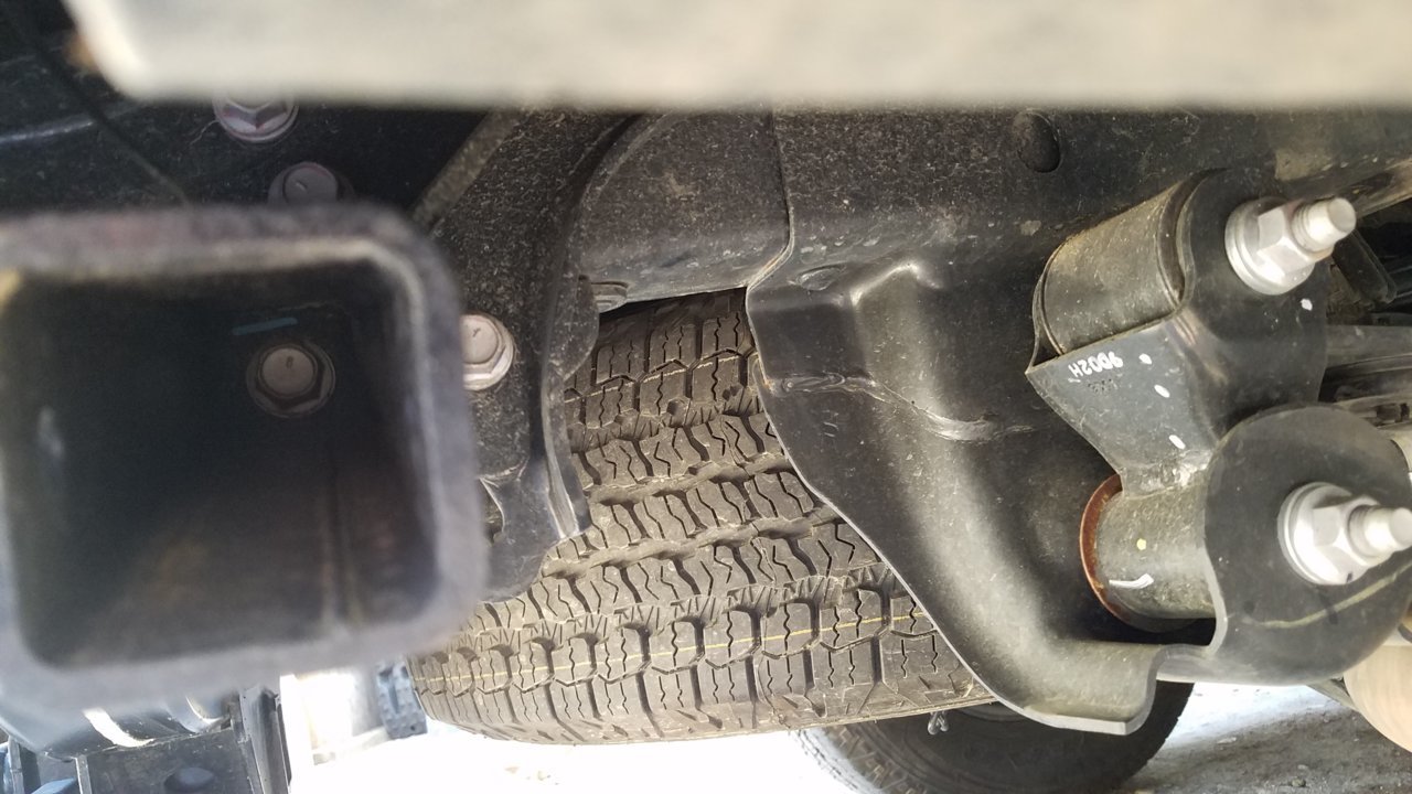

    I meant on the fab fours box... it may have been packaged in the wrong box.. tundra product in a tacoma box.. are there numbers/stampings on the aftermarket bumper?

    Culturekid
    Culturekid [OP] Well-Known Member
    Mar 10, 2019
    #286146
    93
    2019 Tacoma SR 2wd 4 cyl
    Nope...here is a photo of the other side of that part...no threaded bolt holes:

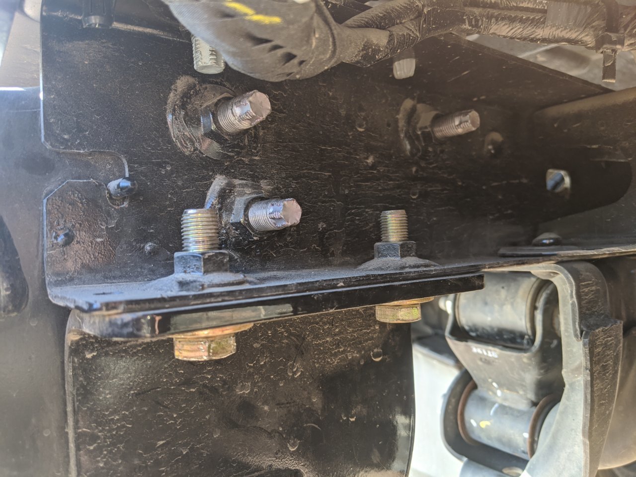

    Where did you find this pic again? Because that's not the factory bracket there. If you look closely, the two bolts that are parallel to the ground are not factory. Those look like grade 8 replacements. I can tell because of the tip of the bolt as well as the washer on there.

    I took that pic...yeah...those bolts are from my aftermarket hitch...those aren't the bolts in question though...

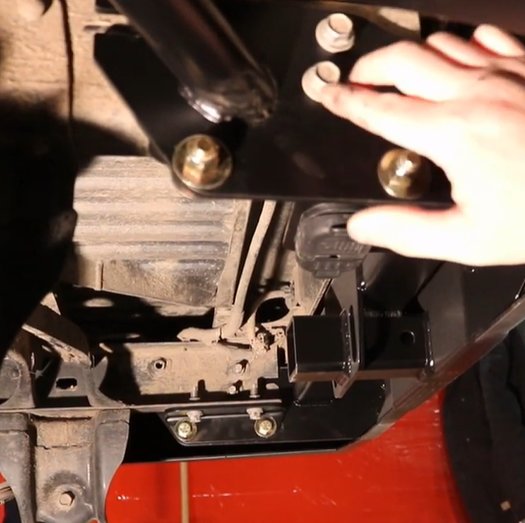

    Bet it looks just like this:

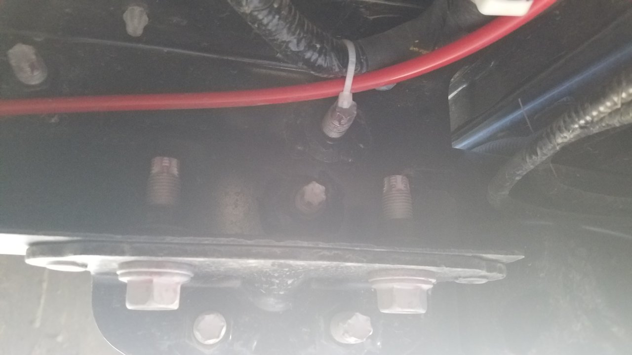

    Not sure if this helps, but pictures of a 19 with tow package, passenger side. My camper brackets are in the way, so I couldn't get a good pic.

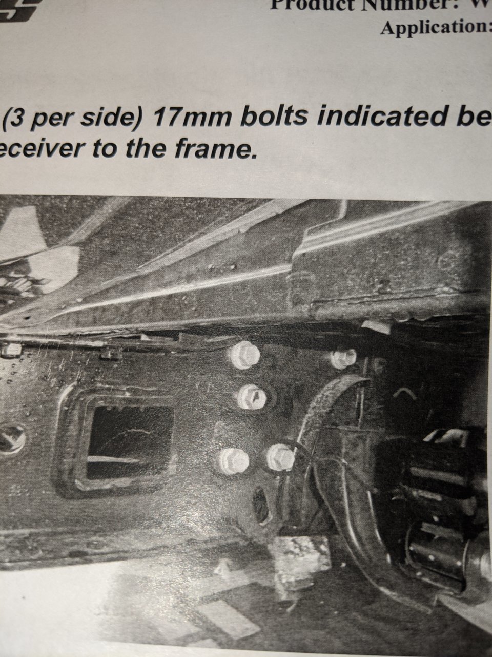

    Hopefully, I can clear things up. On all the trucks frames right there, there are the 3 threaded holes. There are also the two perpendicular threaded holes on the bottom of the frame.
    Trucks with the factory tow hitch had an additional bracket. It's a simple 90-degree bracket that bolts into the two perpendicular holes.
    These two holes are the bottom two holes of the triangle you're seeing in the install instructions. This is the root cause of why their bumper will not work on your truck.

    How can I be sure that it will not need to utilize the same triangular bolt configuration? That is my only concern. I bet they all do...
    Mar 10, 2019
    #286146
    93
    My truck's configuration does not appear to have those two holes...look at my earlier photos. Sorry if I am just dull and can't understand what you are trying to get across.
