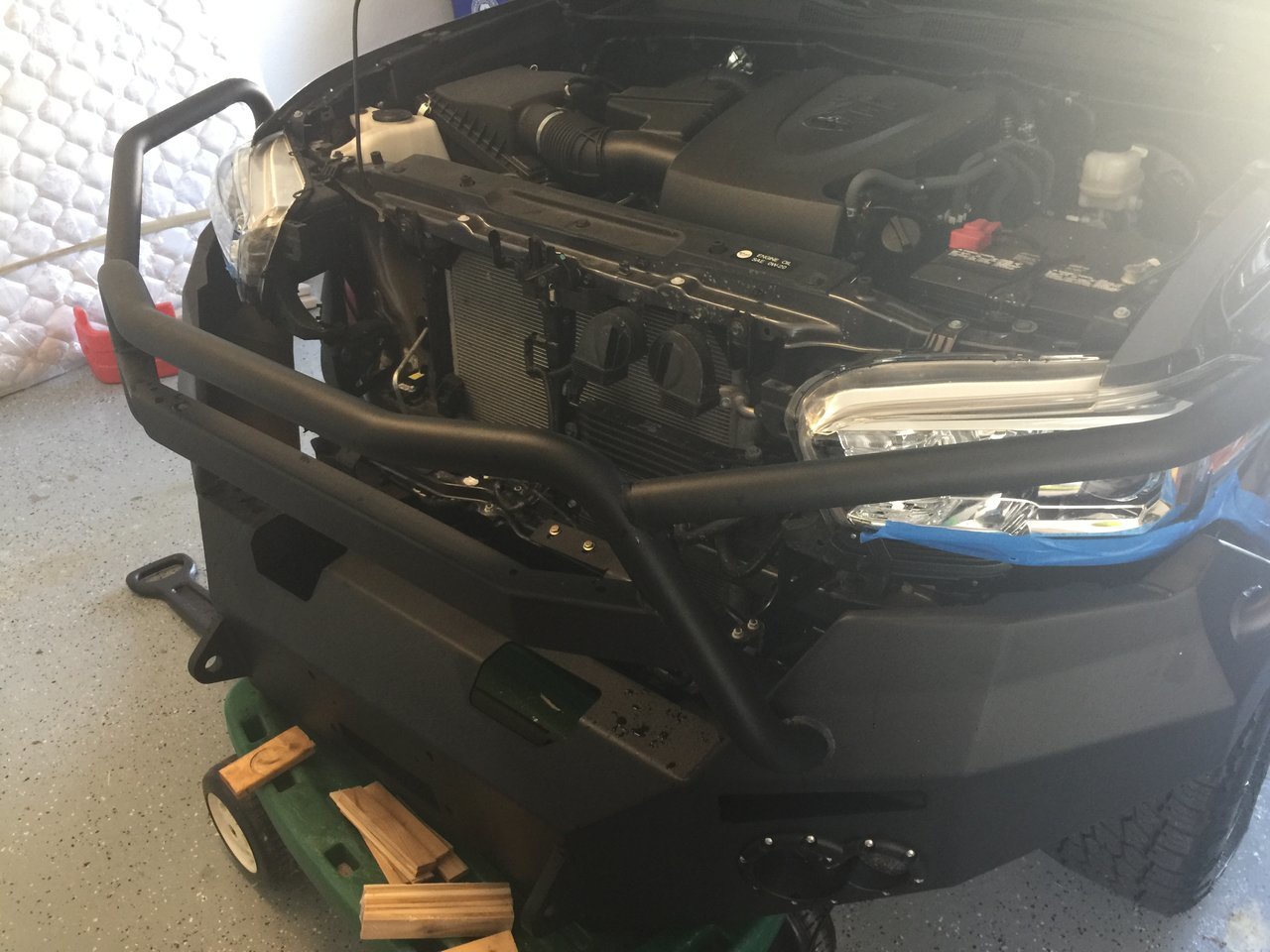

    Had the past couple days off, and got a chance to install my new fab fours premium front bumper (full guard).
    Stock hub to fender:
    Front - 21"
    Rear - 22.75"
    6733D987-7C4C-4D5B-92F9-B023E3090351.jpg Started in the evening and had it completely torn down, dremeled and drilled where needed, and started plasti dipping the gap areas mentioned in directions. Dipped the grille and badges while I was at it.
    IMG_0419.jpg For the most part, the install was easy. I found a 4th bolt underneath while attaching the frame brackets (directions say 3), my brackets would sit properly until I removed it. I ended up having to call someone with small hands to install the bumper bolts, while I held the bumper up and into place on each side during final tightening. I initially fit it with wood shims, but bumper kept moving. Also, the supplied fog lights' plugs fit perfectly with factory harness , so no need for the included wiring kit for them. Haven't wired up the turn signals yet. Had to trim the fender lining as well, used heavy duty scissors and went fast.IMG_0422.jpg High Measured day after adding it on stock suspension

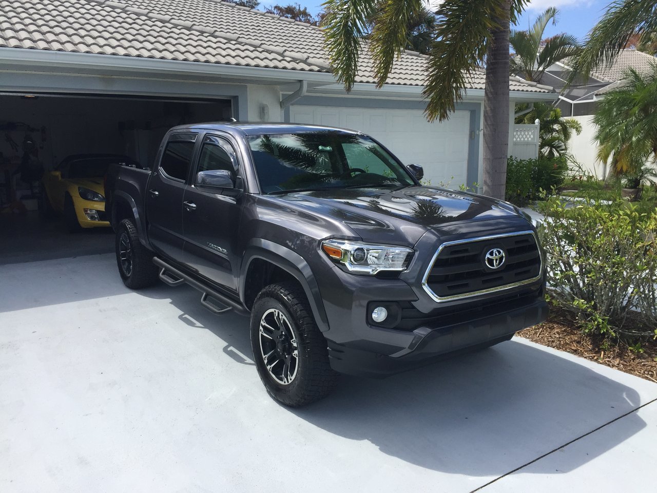

    Front: 20.25"
    Rear: 22.75"

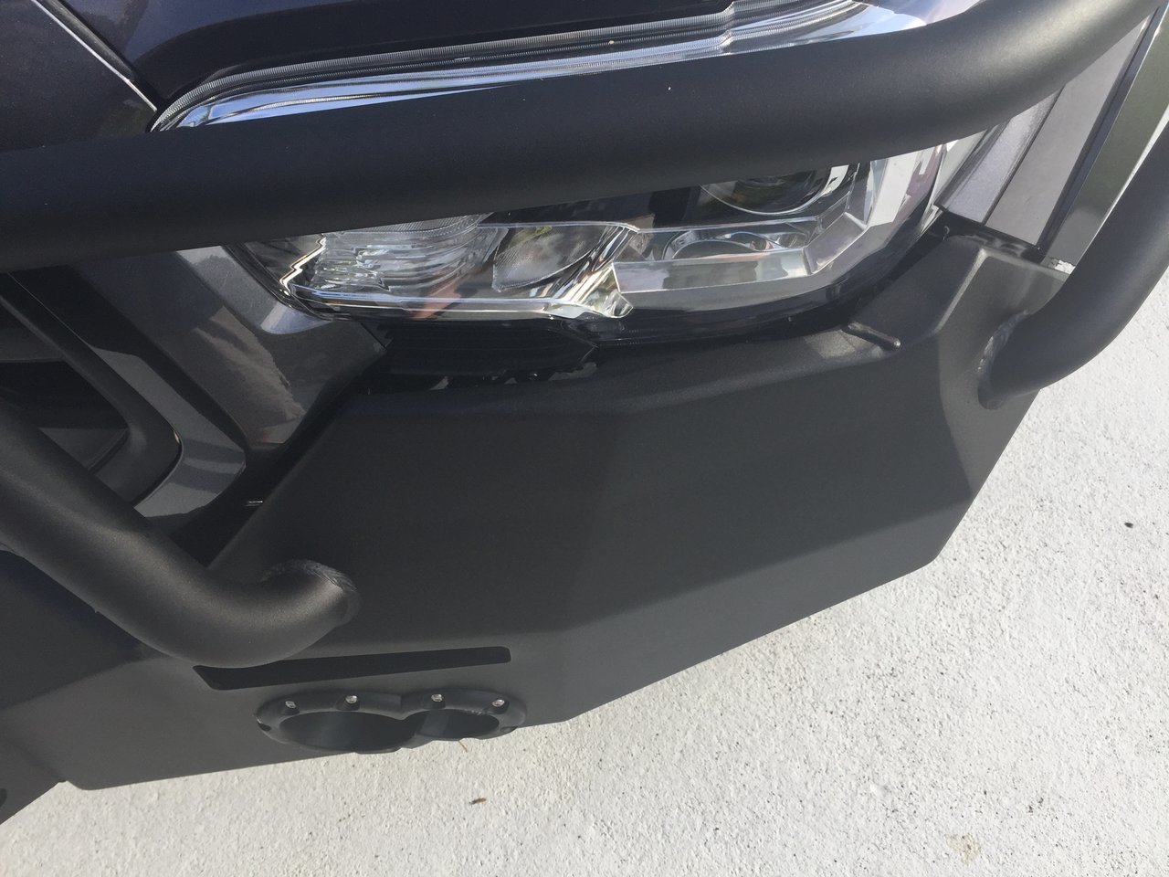

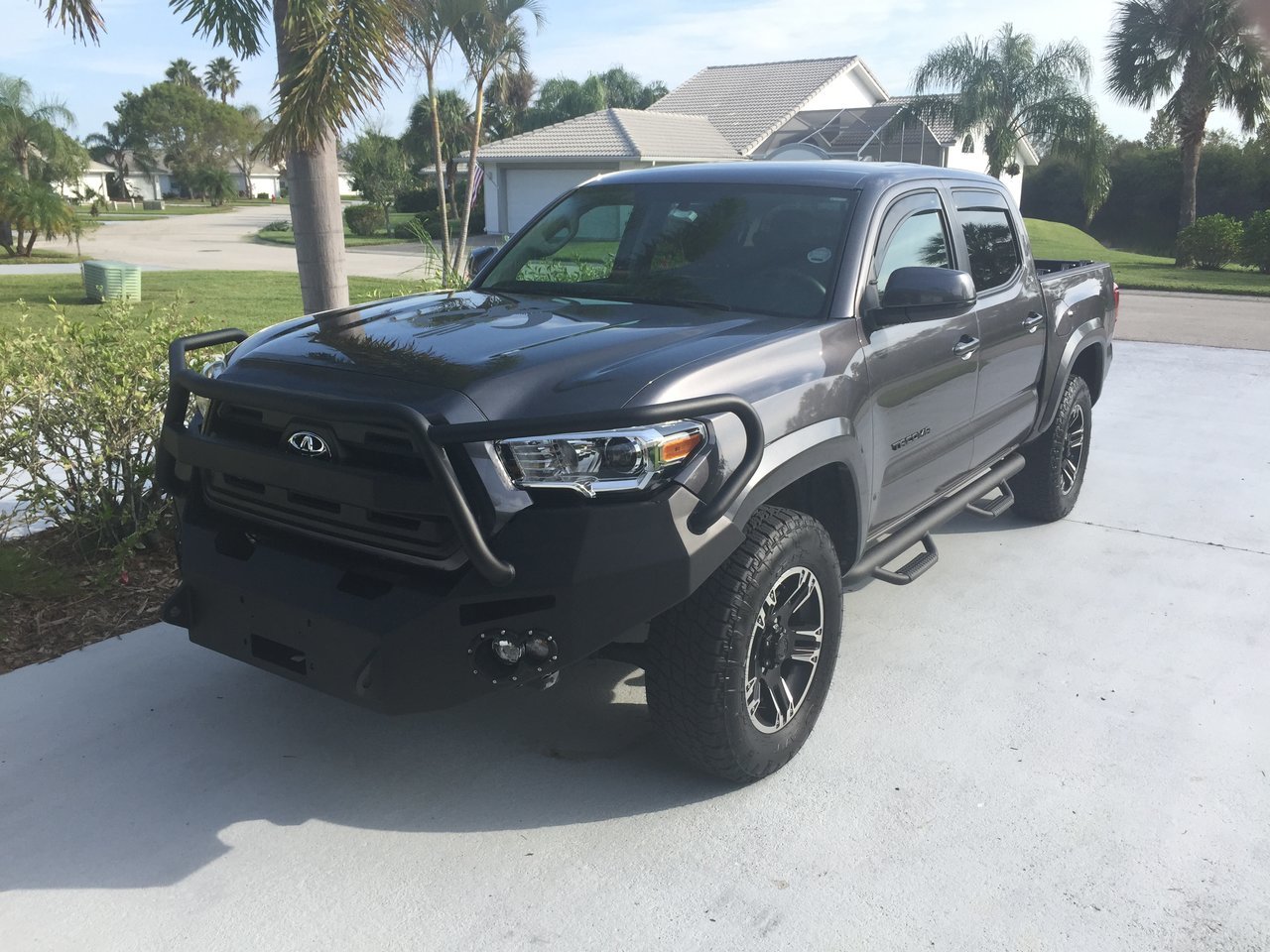

    Initial review is Im happy with it. Gave me the aggressive look I was hoping for (I don't mind the chin), and suspension is next so it doesn't look so out of place. The gaps between bumper and truck are more noticeable than the factory pics or other that I've seen show, I may try to adjust closer. Giving it a week or two while I order parts to let it settle for post weight fender heights.
