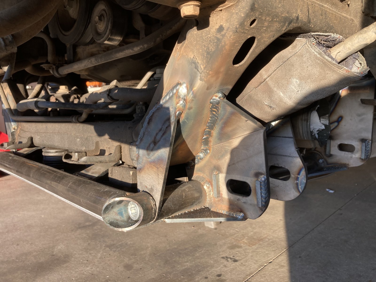

    Figured I’d share the updates in here. Bryan had the truck shipped up here last night. Arrived around 9pm last night.

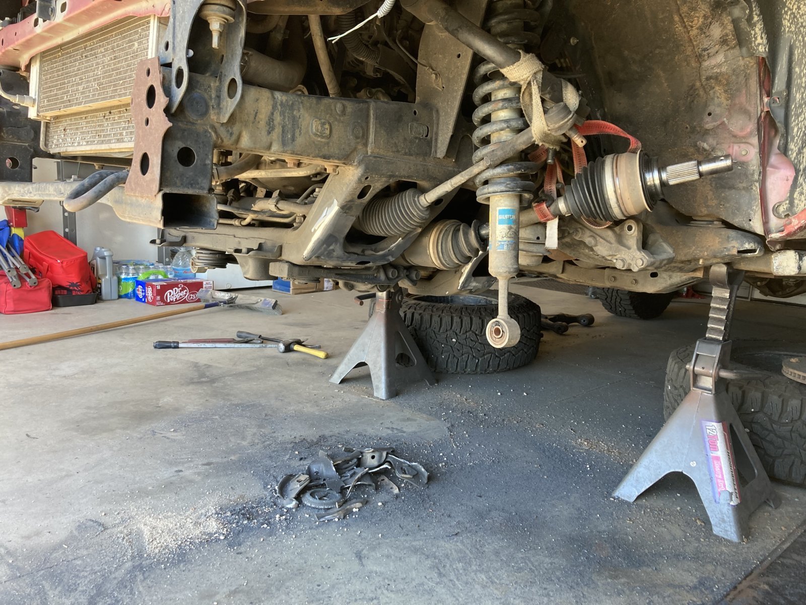

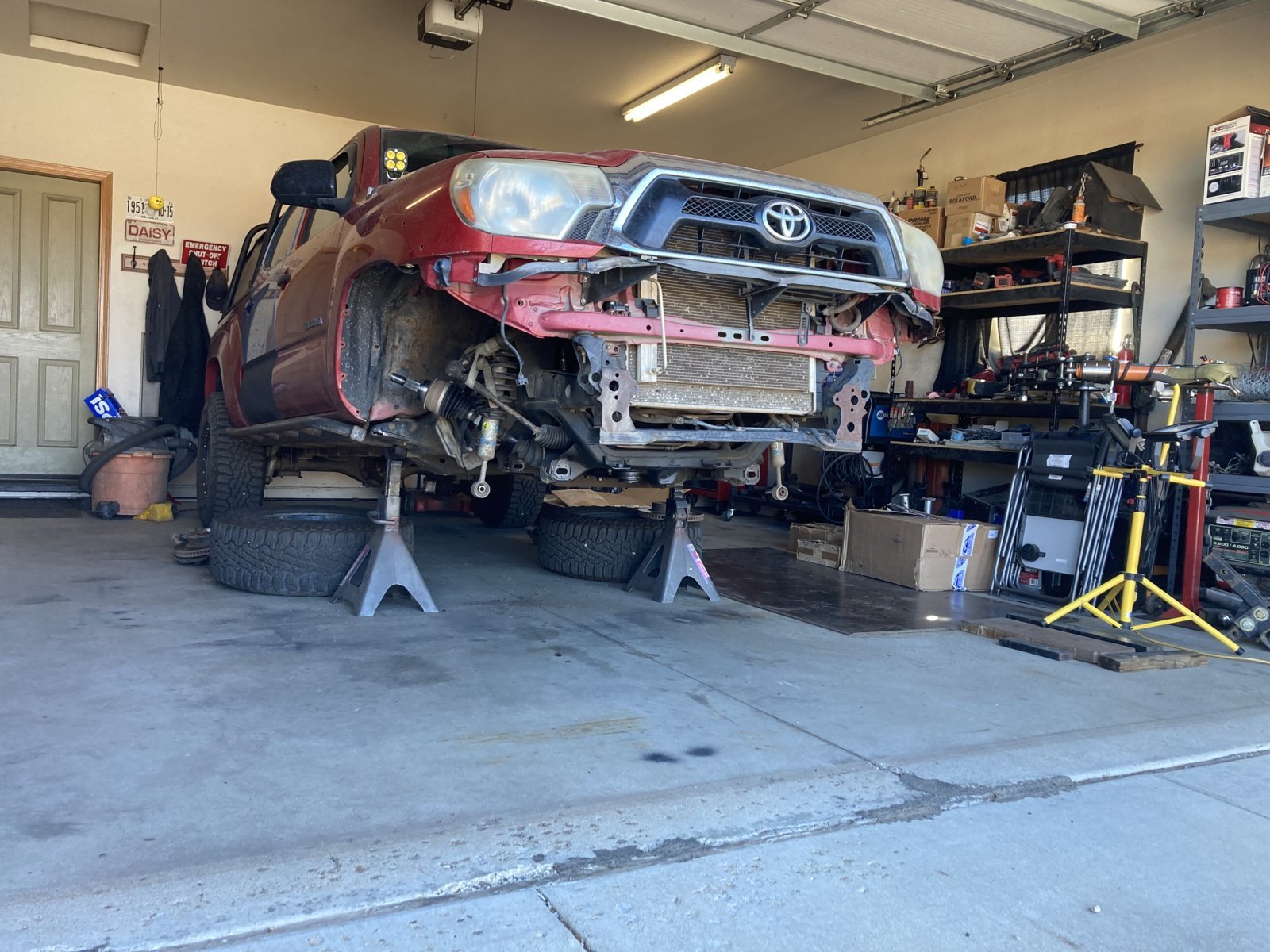

    Got started this morning around 8:30 with the tear down.

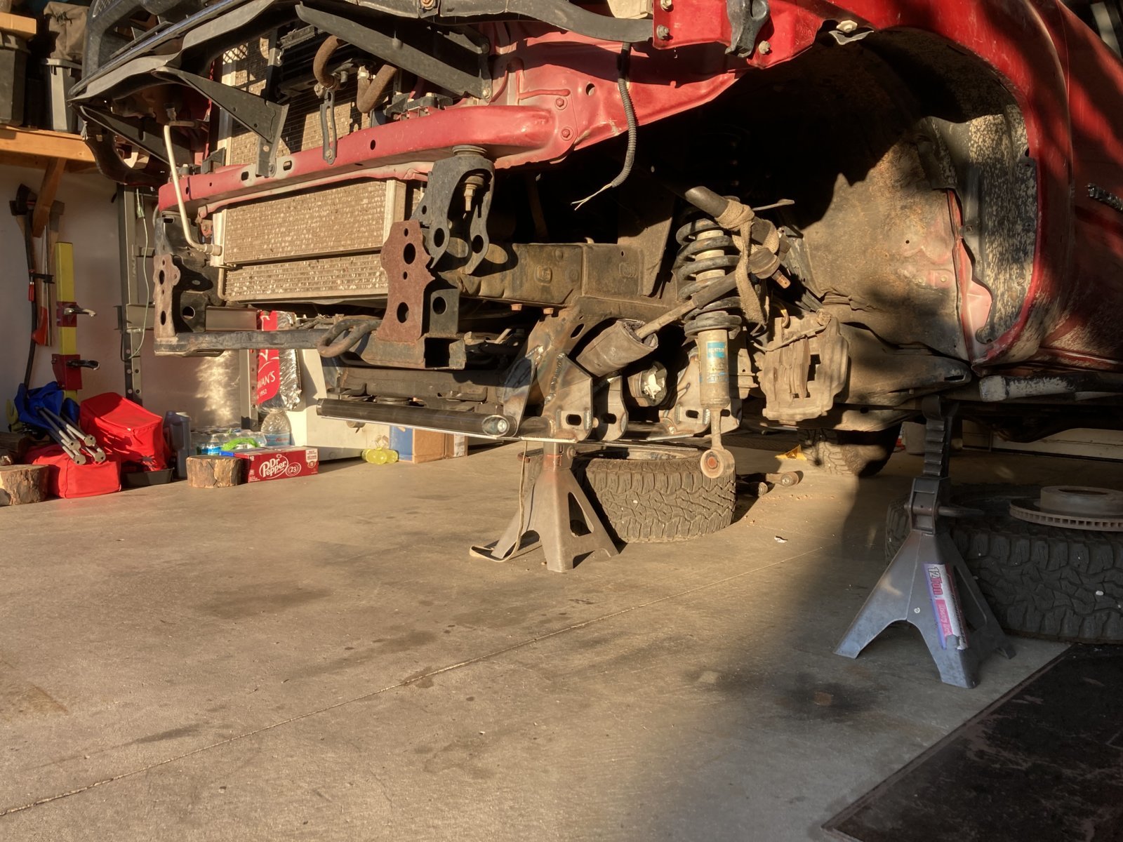

    Then the always worst part ever. Cutting off the old mounts and cleaning things up. Actually got this done in record time today.
    Jd fab kit massaged to meet the frame.
    And all welded up and done for the day after 8hrs straight.
    Tomorrow we have to weld the mount for the front skid on, massage the lower skid mounts so it bolts up nicely, paint and start some maintenance during reassembly.

    Well then original time estimate of 12-15hrs was pretty good. Probably could have been done and on the ground today if it weren’t for a few things. Like adding doing cv boots, and finding a bent spindle keeping me from assembling the driver side. Probably would have been spot on at 14hrs. But clocked out at 15hrs today. Waiting on a spindle to assemble the driver side. Skid is ready to bolt up was just letting paint dry. And then need to make a quick bracket to weld to the cross member so the trans skid has something to bolt to since the jd skid doesn’t adapt to it.
    Would have been nice to set it on the ground today but not the right call with how bad the spindle is. Still with frame being a little tweaked adding time, cv’s, spindle, and trans skid adapter gone be right around 20hrs or less.
