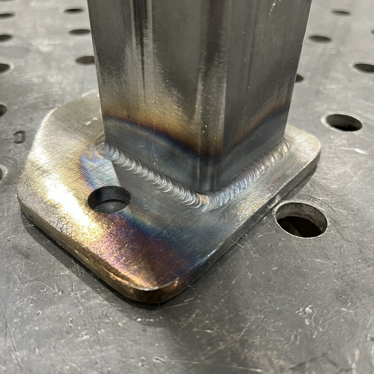

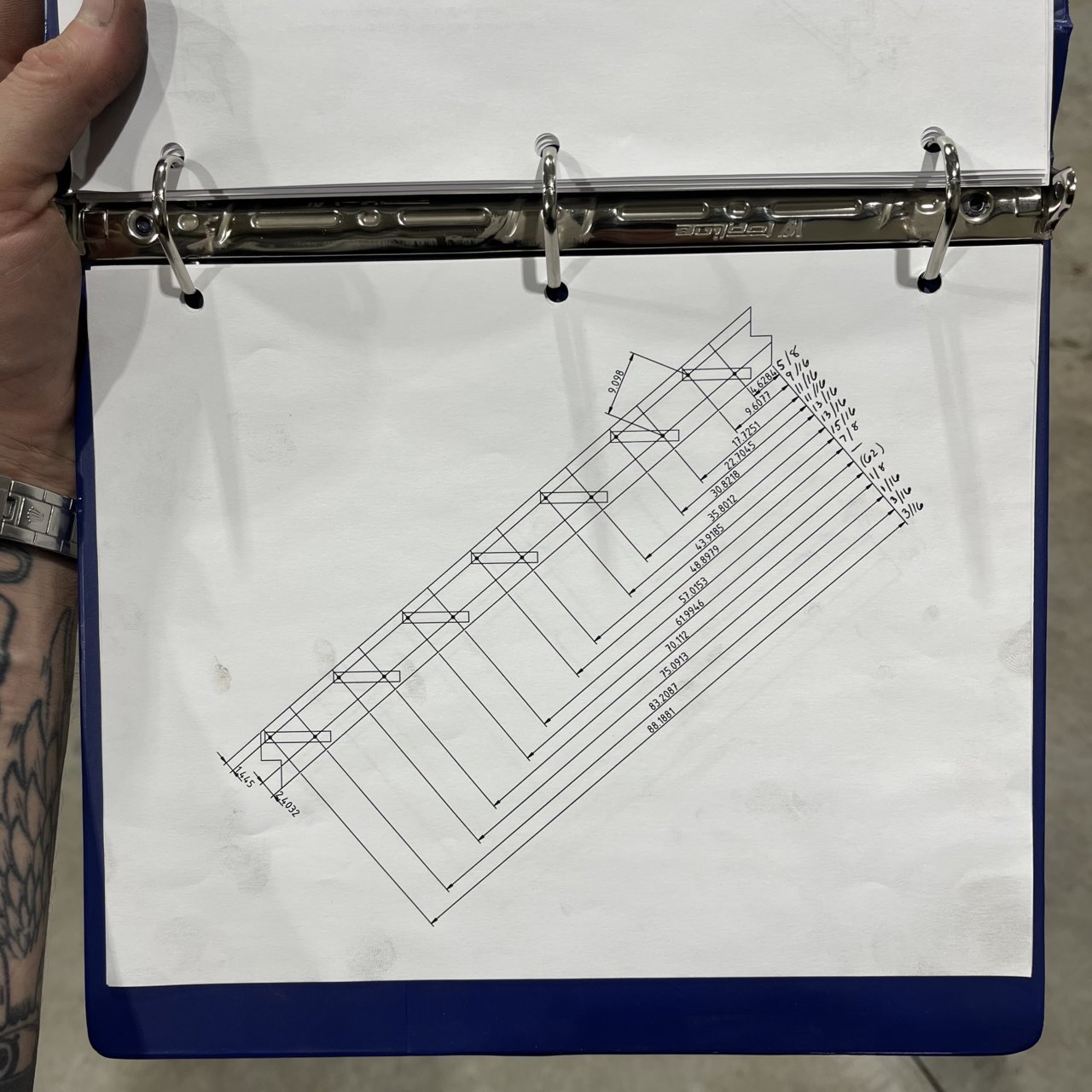

    64FA919F-C10C-4829-80EA-41847AF71FBF.jpg 24E732AE-D46F-4D28-ADAD-3A9E58BC0312.jpg 5D8C83C3-55AE-4D10-9DA1-F7A4EC711B82.jpg EB60A404-E062-4D0C-8186-E8B391A5B832.jpg 4D440DB2-4934-4749-B745-A9625F16C826.jpg FD813AFD-CBBD-4F71-BCD0-CE60D699FCC5.jpg

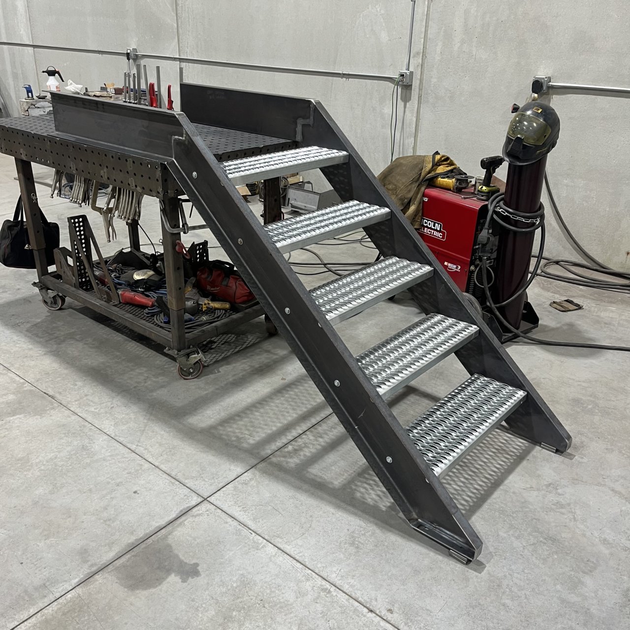

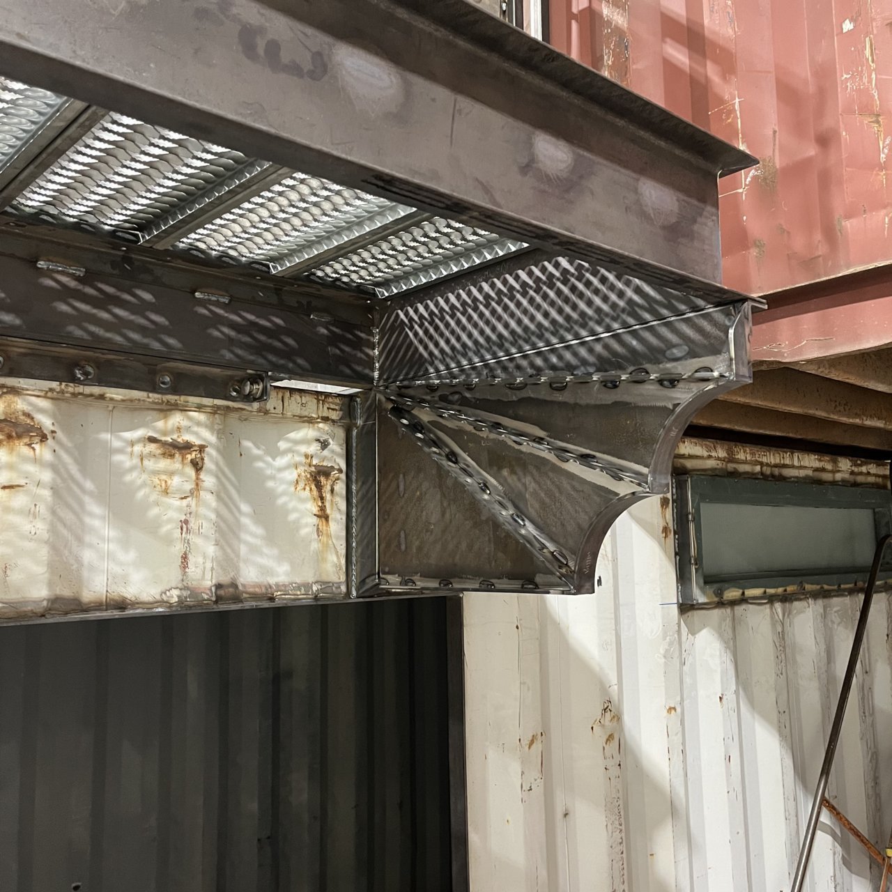

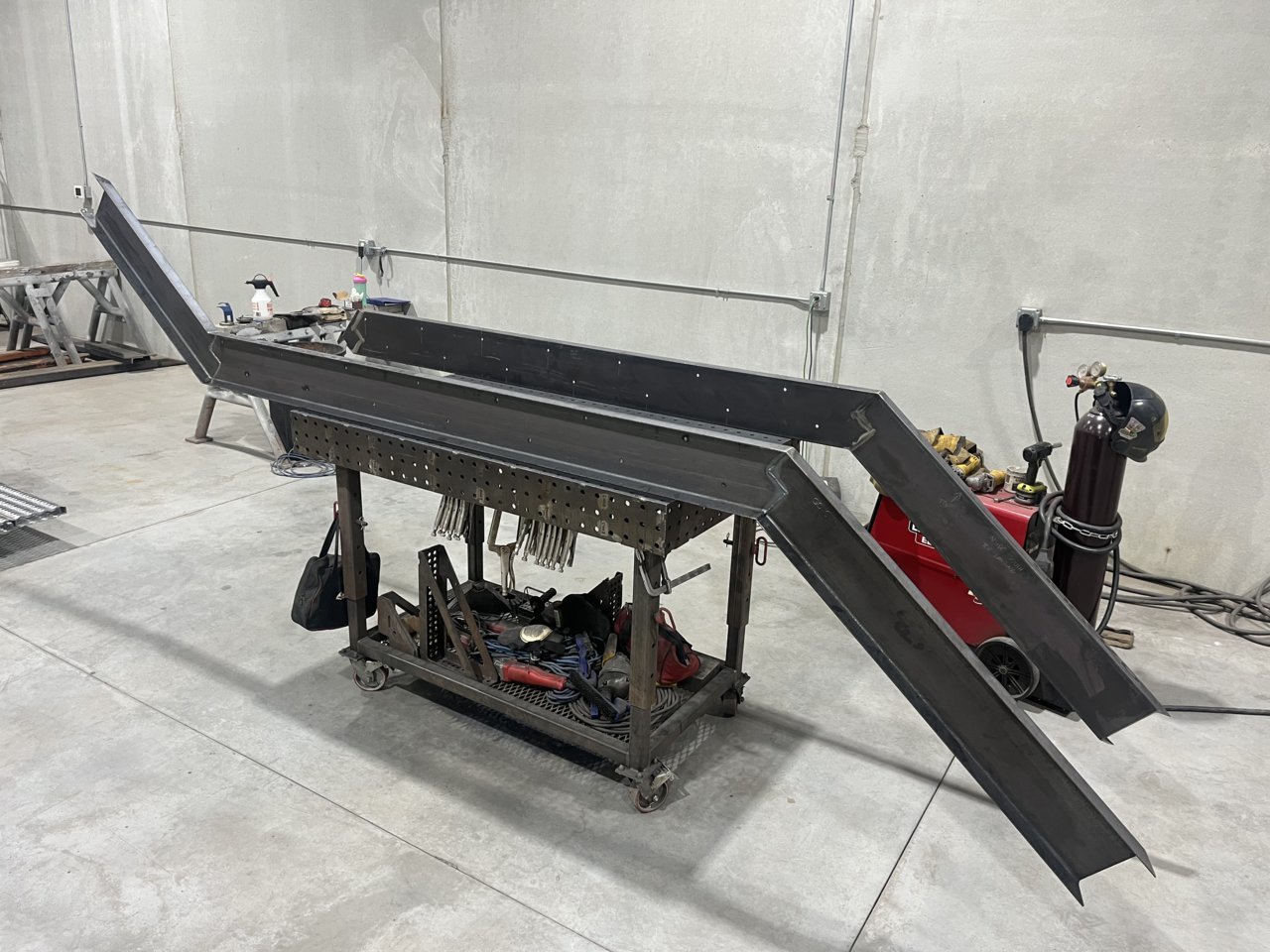

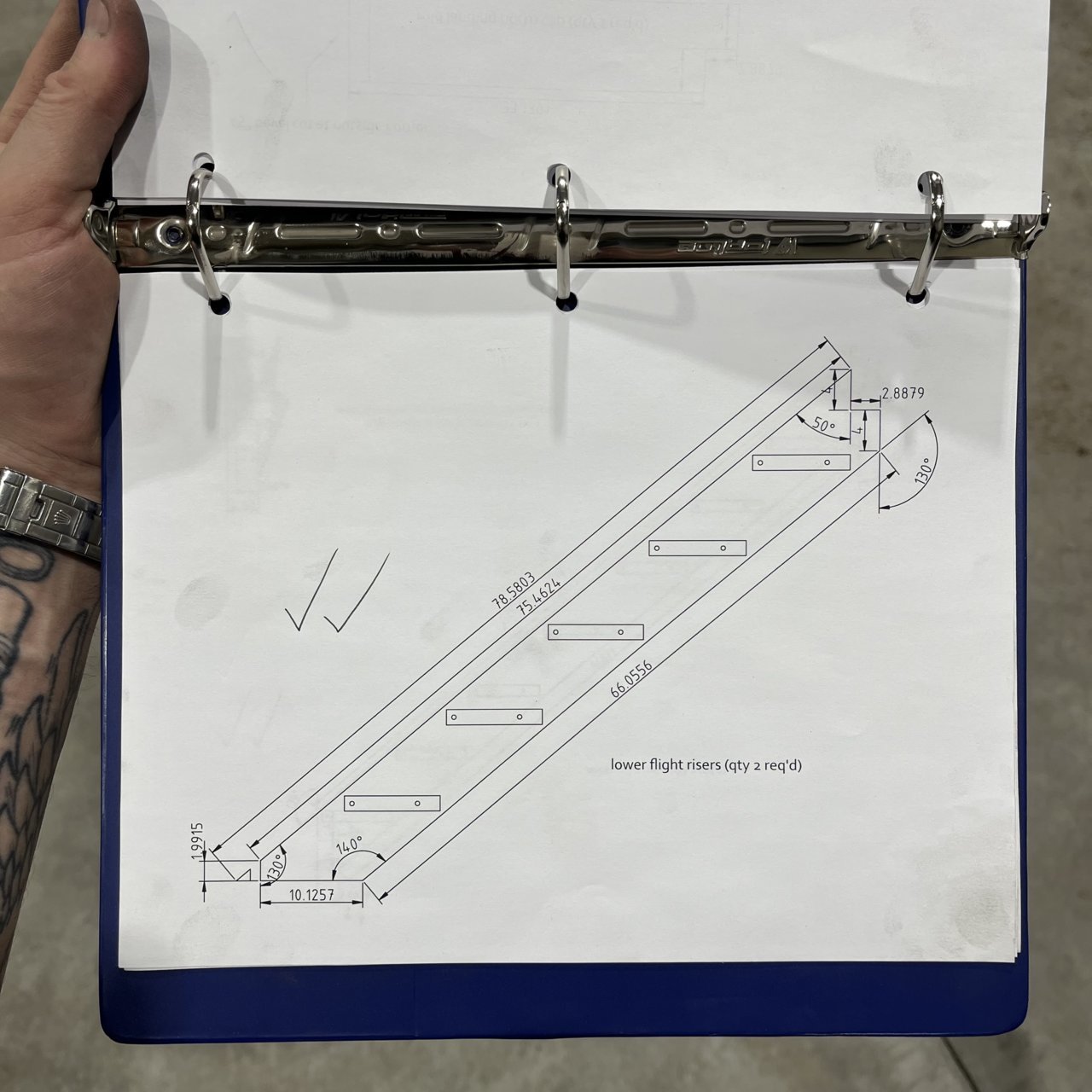

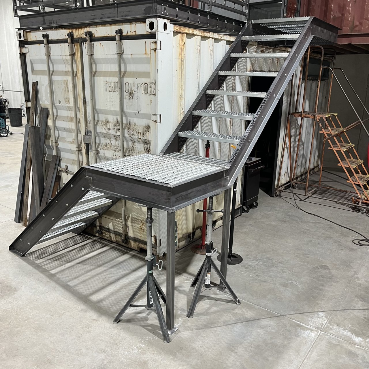

    Just finished building a staircase for my shop office build. Never designed or built a staircase of any kind before... real head scratcher. Lots of fun to assemble it without a helper, too. :rolleyes:

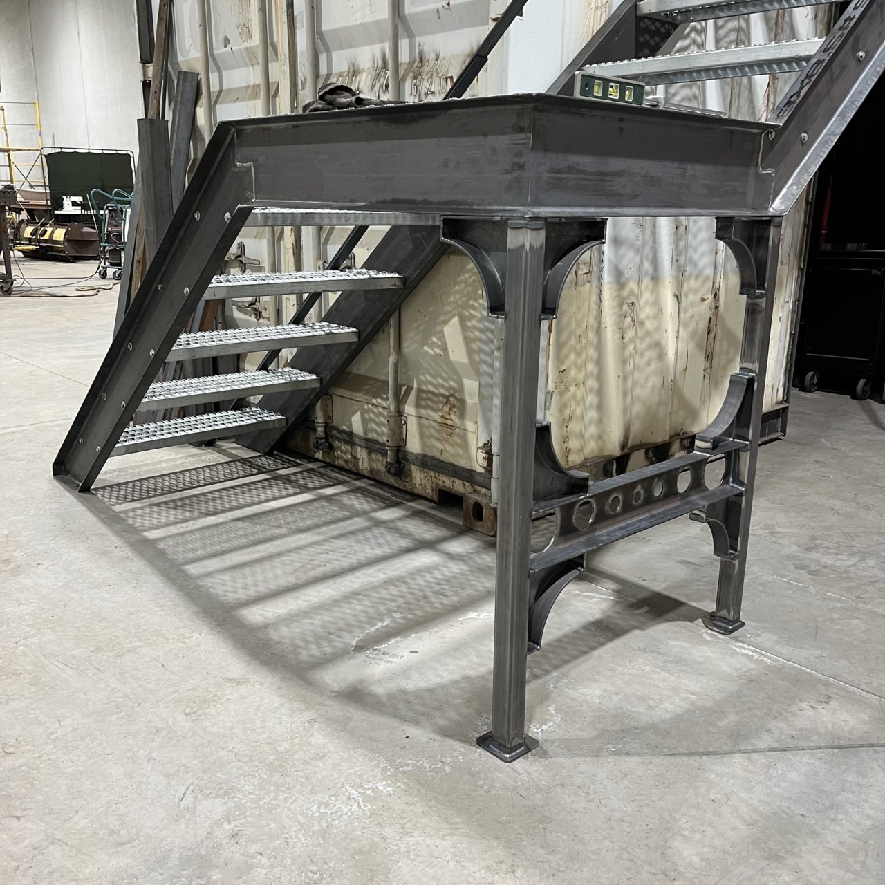

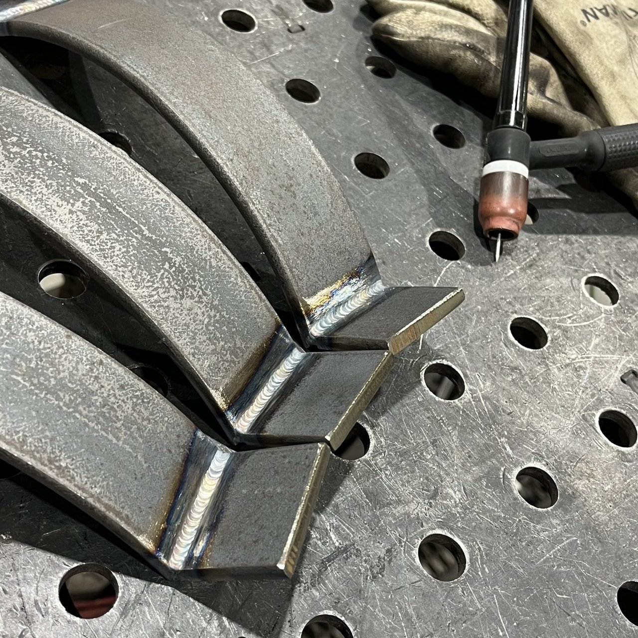

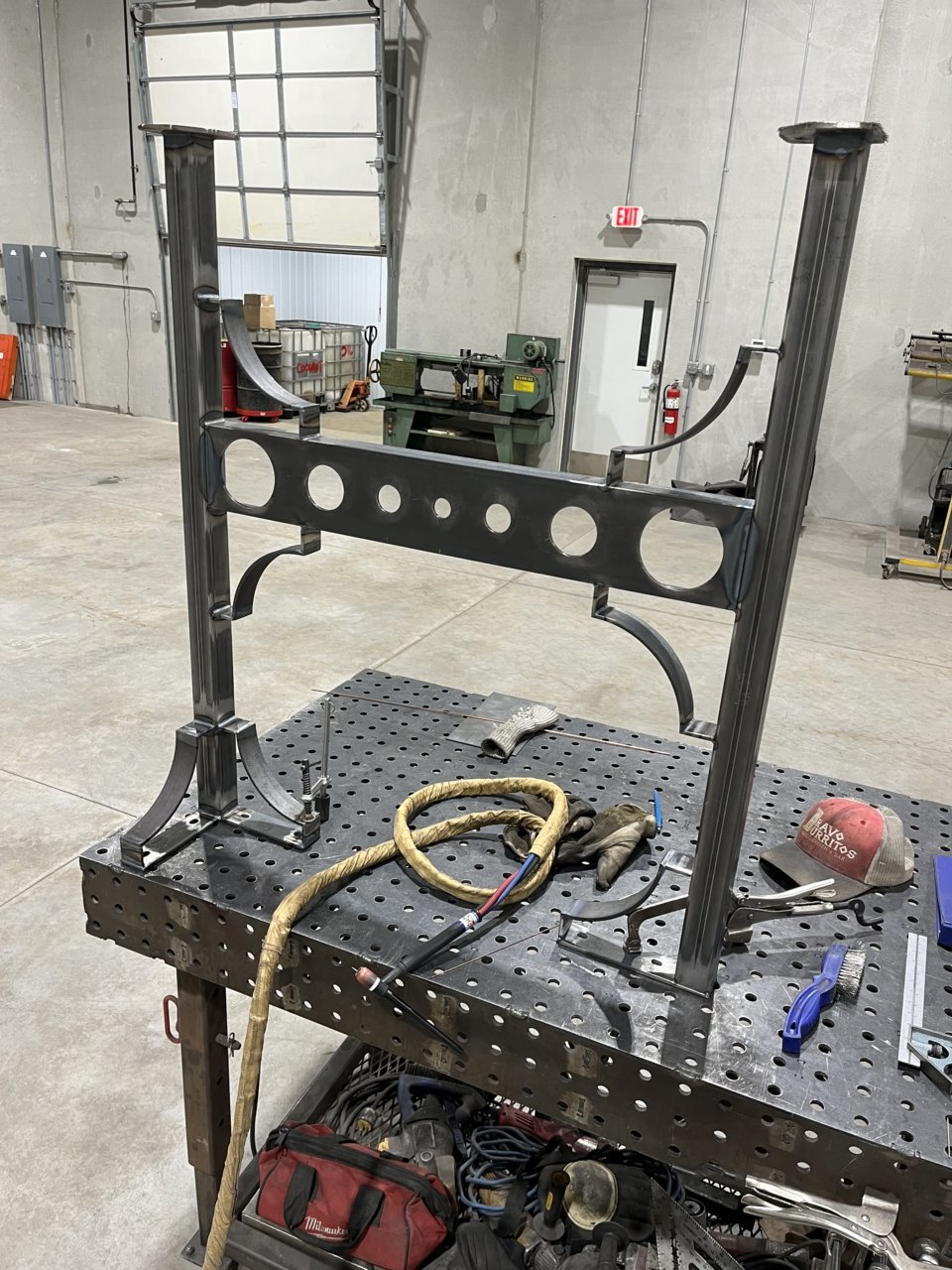

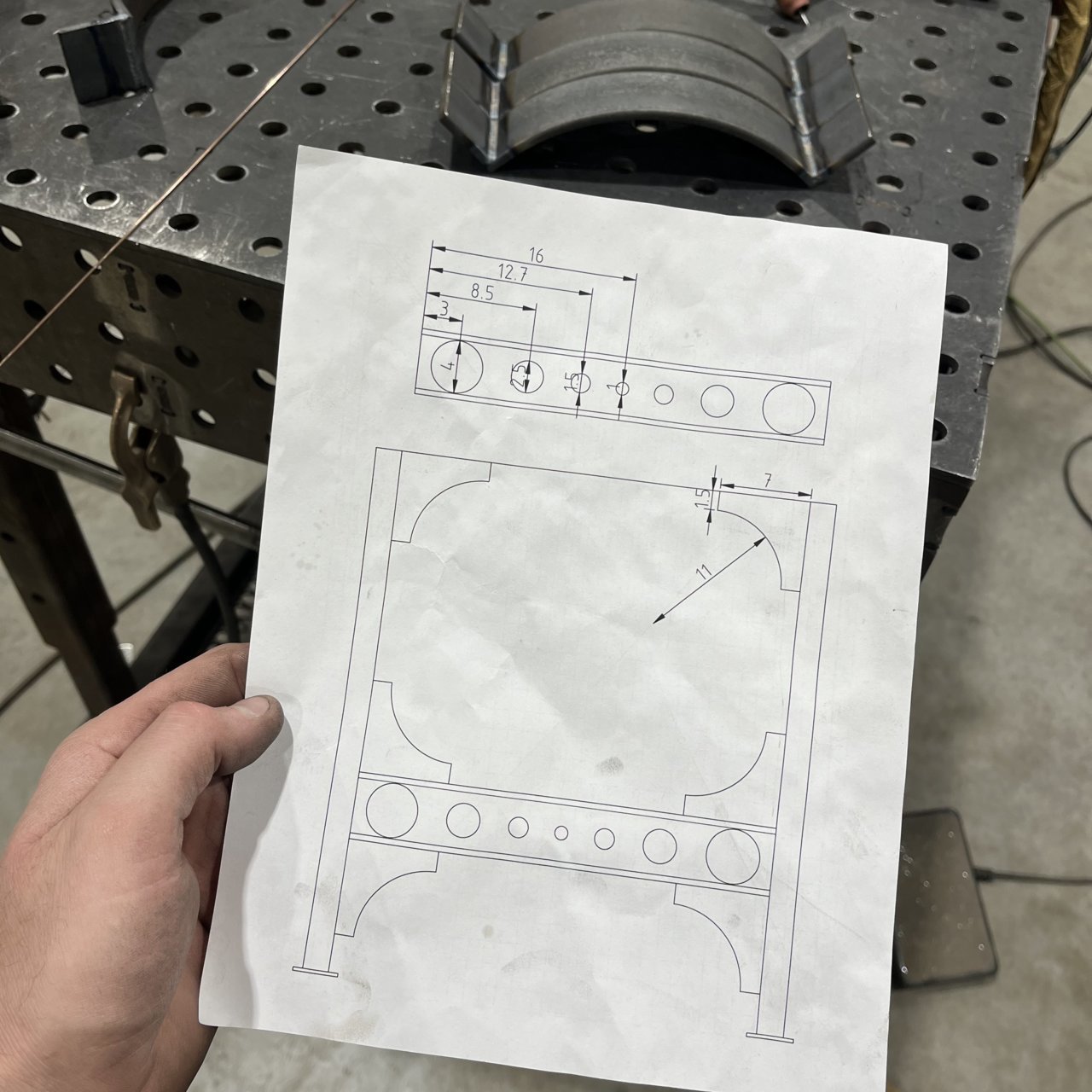

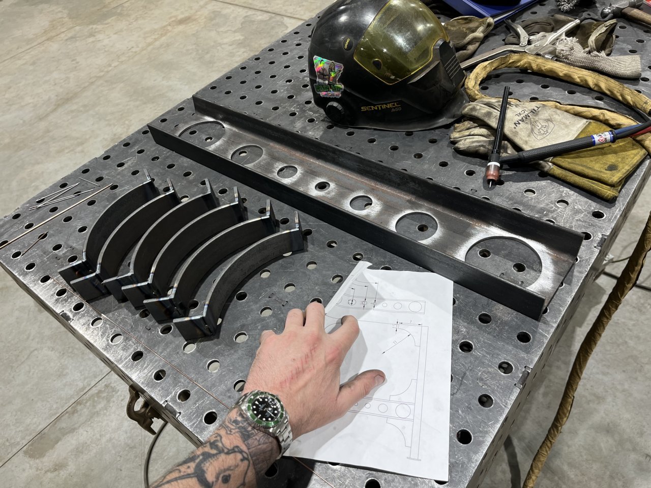

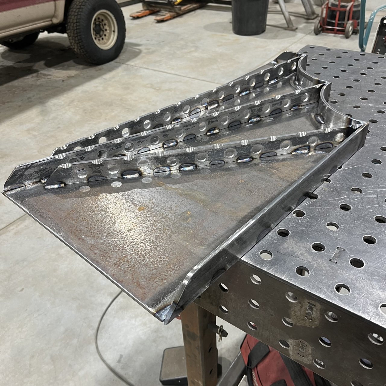

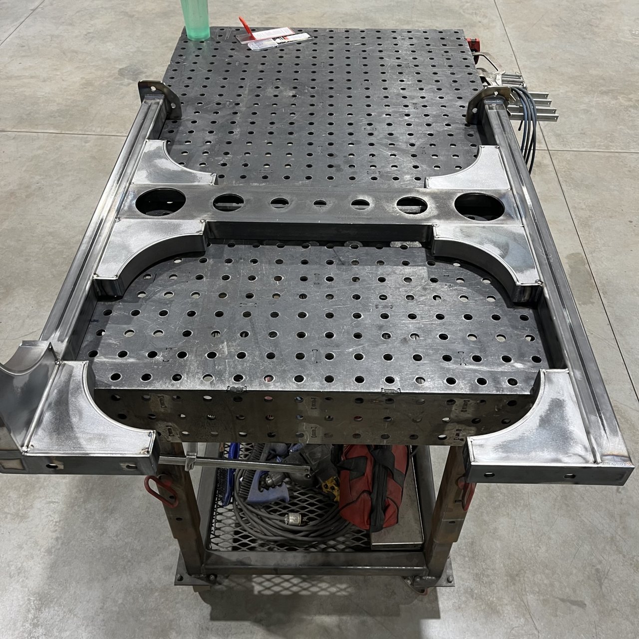

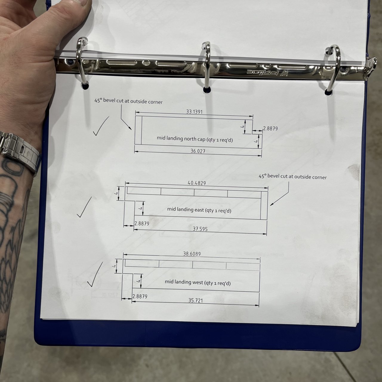

    F6EC1E03-A395-4A8D-93A9-A5D3569F8694.jpg 3A546CDA-B469-4D4E-B484-808604798760.jpg 211E9F2F-3E51-4BA1-B8AC-4990055A8BA3.jpg

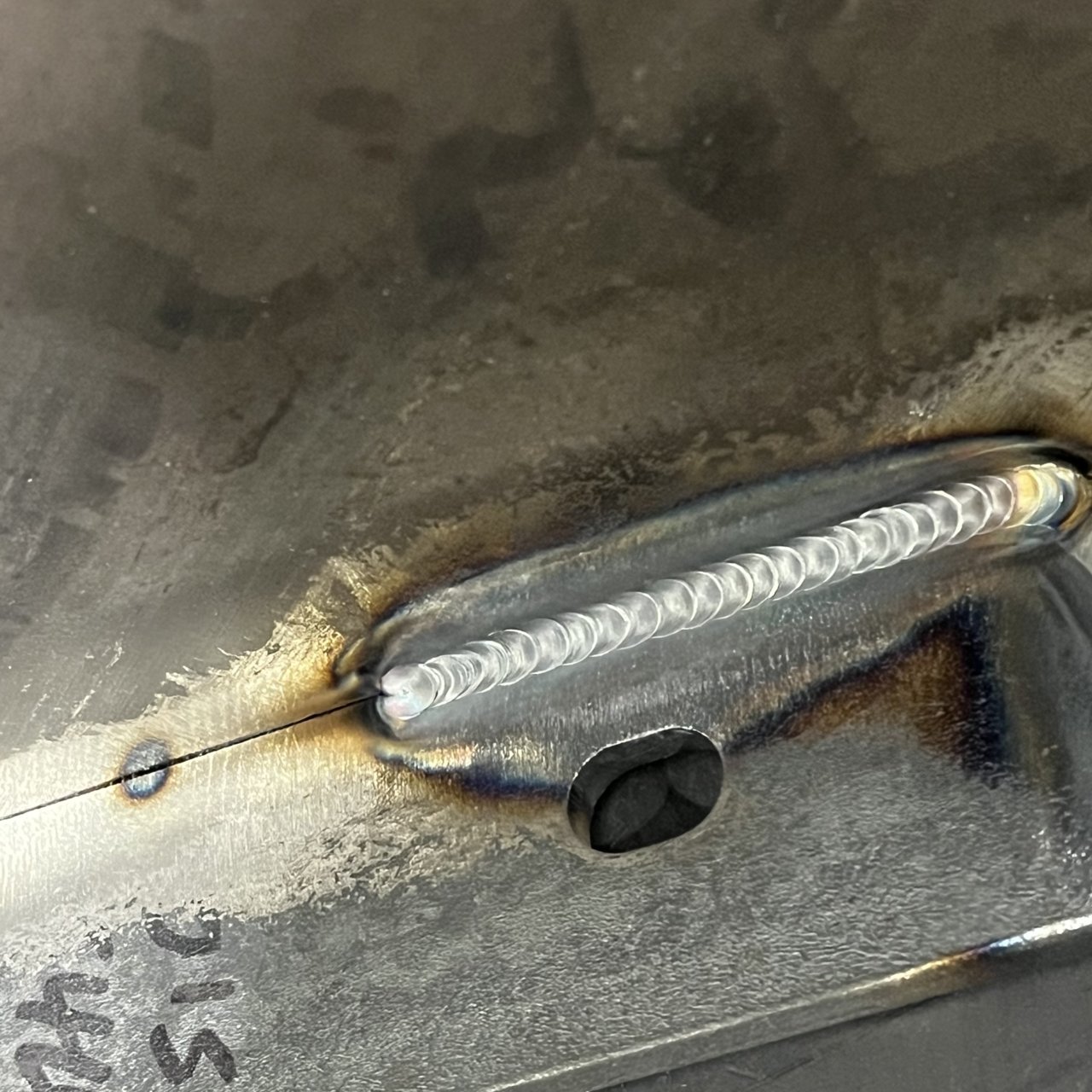

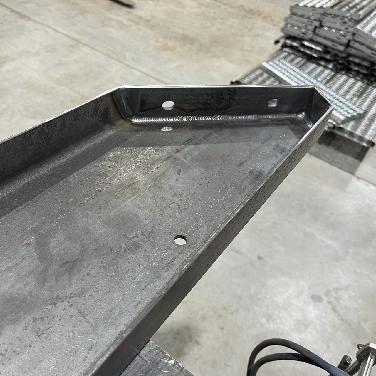

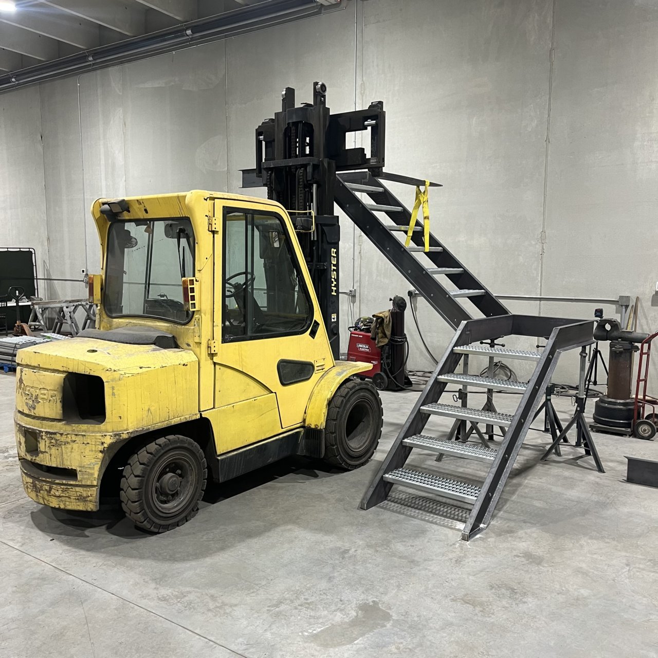

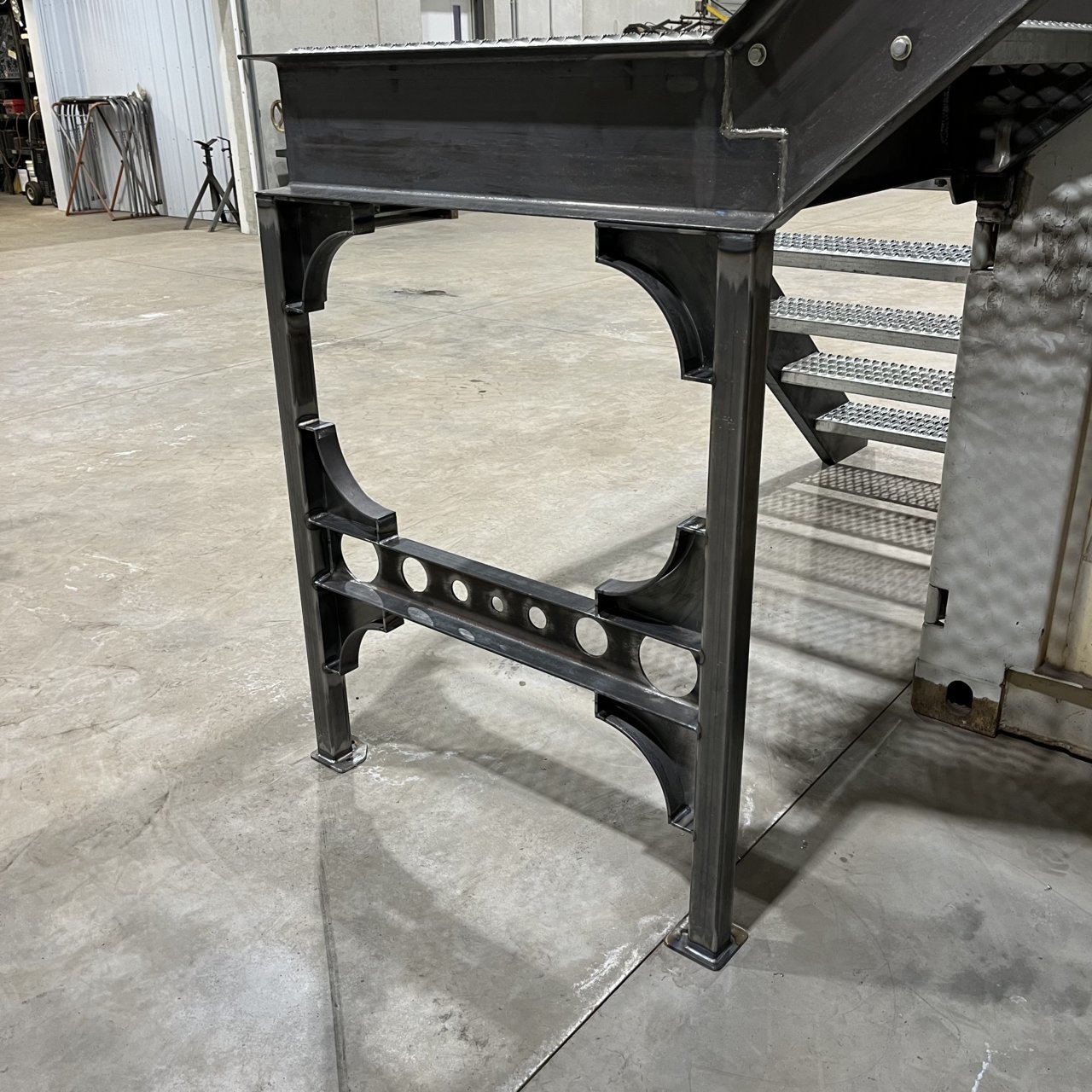

    Lazy Sunday today, building some staircase landing legs for the magic kingdom. Almost out of argon, definitely out of talent.

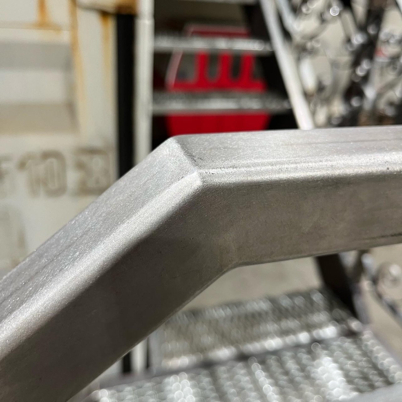

    FF3F79B3-4A44-405C-8A6A-90157E2A6065.jpg 49D12CDE-CD63-44F8-B666-D219A9149B0A.jpg 3C2F6DF3-D778-4735-84E4-1D6FED00EC1F.jpg

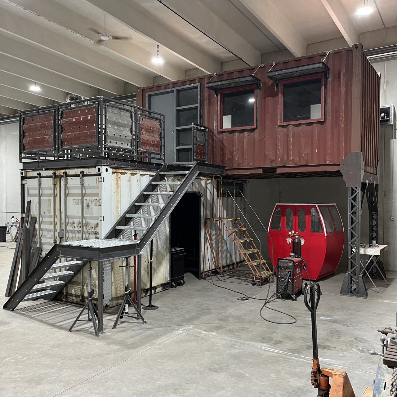

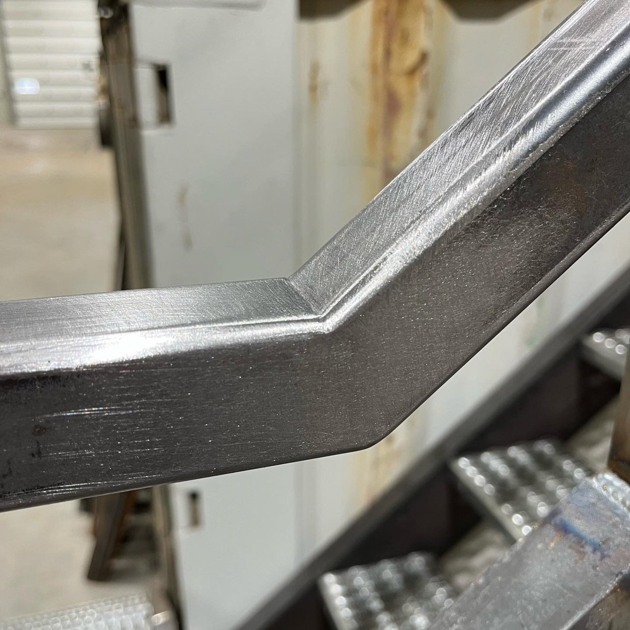

    Top staircase gusset ended up looking like the main sail on an eighteenth century Chinese junk. Gotta build a scroll bender and get going on railings next.
    Maybe I'll repair that right front fender on the Tacoma and get this thread back on track someday. o_O

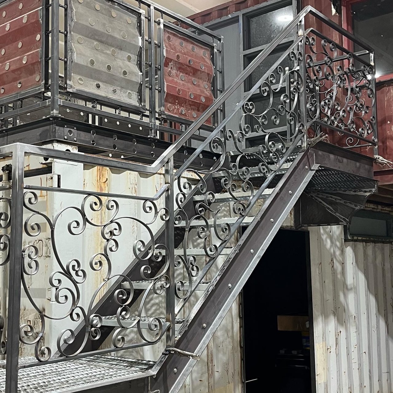

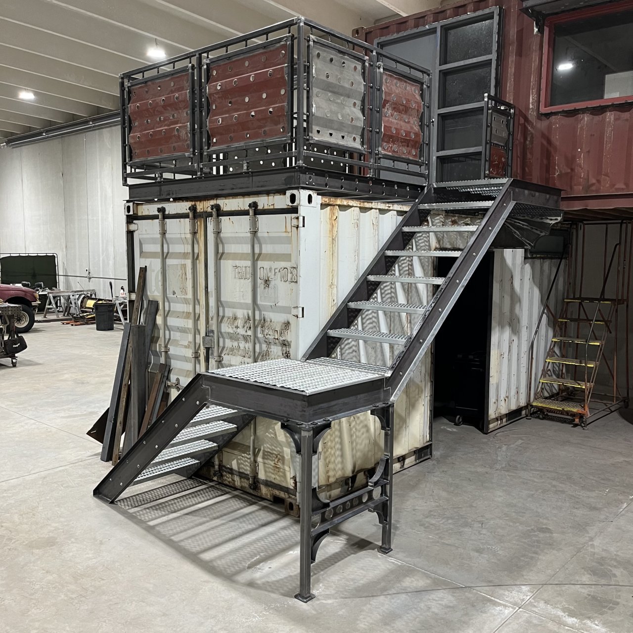

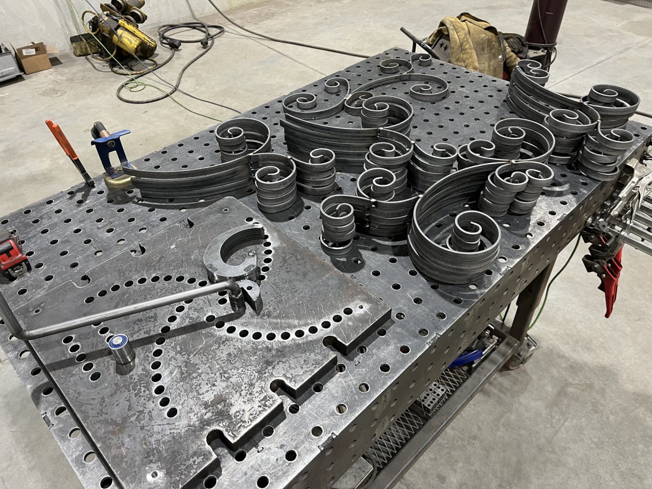

    1A0CA94B-46B2-453D-BFDC-B31B543480D7.jpg E52988C2-A7C1-4CF8-89CA-088662F29642.jpg
    79A9B491-3BA1-4775-B581-ADDAEE8648FB.jpg 038449CD-650D-4928-A291-ED83C660BF87.jpg

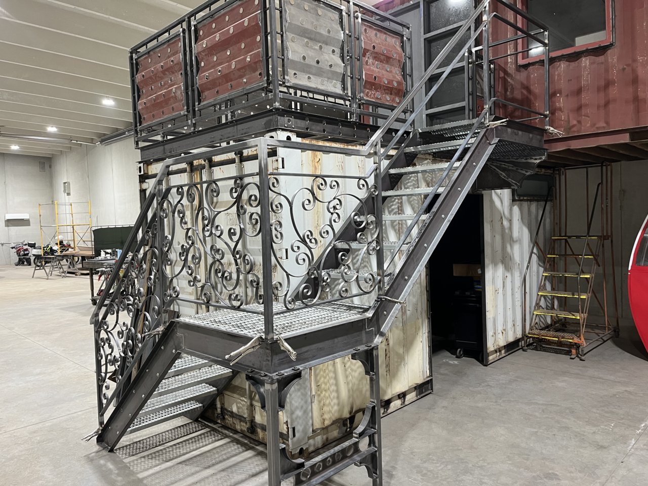

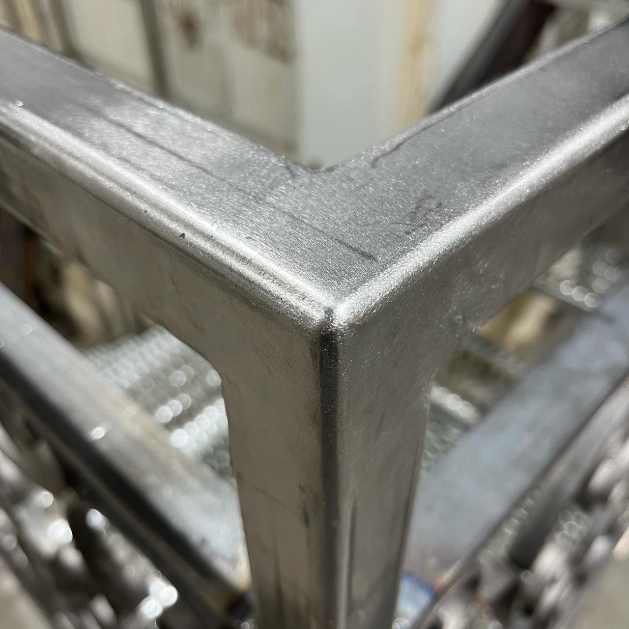

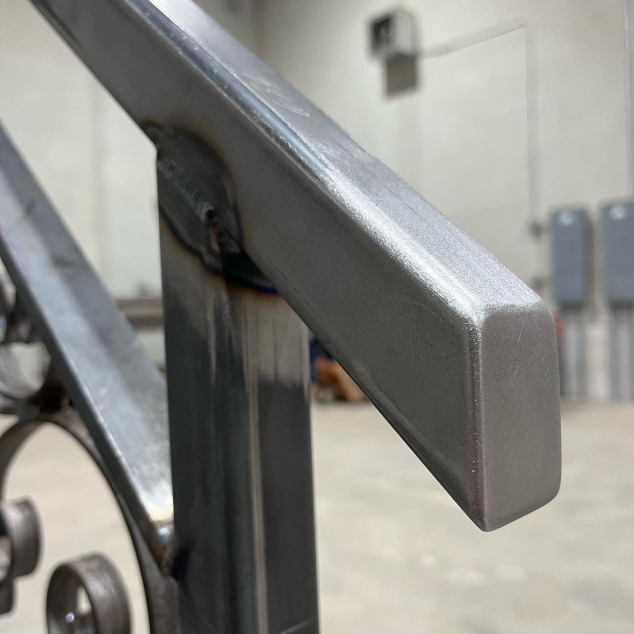

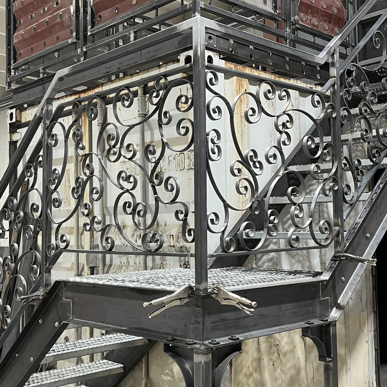

    Railings are almost done, just waiting for the steel supplier to get another ~200ft of flat so I can finish the decorative scrollwork. I blasted a bunch of 5/8" holes in a plate of 1" steel I had in the shop and used some plasma cut laminated dies from an eBay seller to make a simple manual scroll bender. Works pretty well.

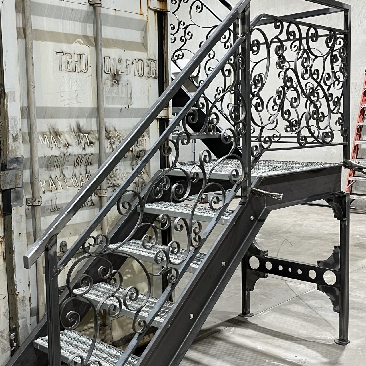

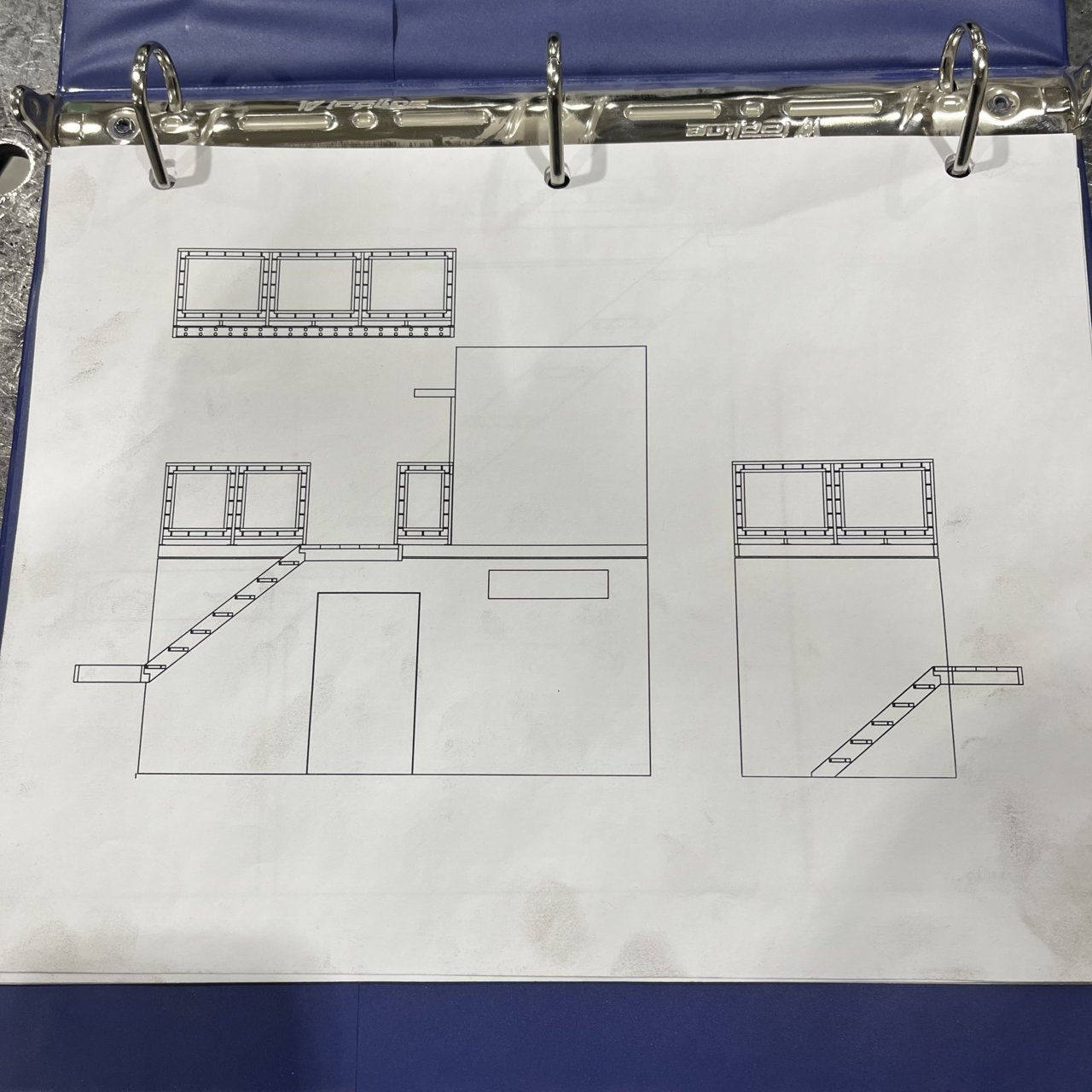

    1E10E220-4339-4932-972D-FB5C198F66C9.jpg D36FF105-D711-4F70-9A49-CA3ABD34B8A3.jpg C7C862A5-F534-4D1F-A6AF-42F9D403E1B0.jpg 31AC52DA-C069-464A-A2B0-860D83B000F0.jpg 218BAF11-6580-4F7F-ADF4-E62D173D5997.jpg 58C7AC77-89EB-4F54-8C6E-0639E040A12B.jpg 89A39E20-AC47-4900-8610-A5D893174552.jpg E7206E7C-E8A7-4871-ADF0-E6486611D2C5.jpg 7DC79B6E-10CE-43F5-863B-7B5A1C0CF945.jpg

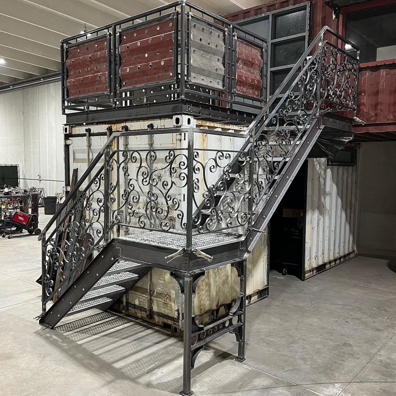

    Got my railings done. Not perfect, but I'm pleased with the results.
