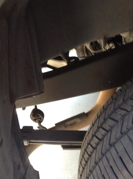

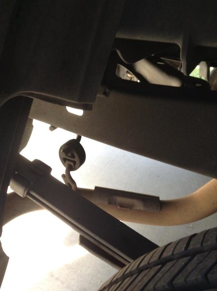

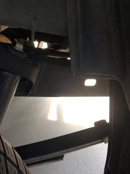

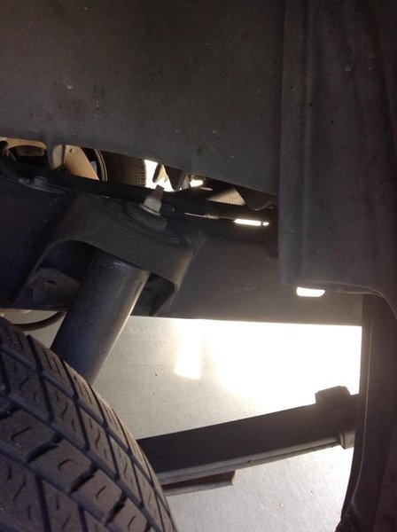

    My friend as an 07' Tacoma access cab and he wants to know if he can shorten the overall length of his truck by getting new leaf springs and relocating the leaf spring shackles to just behind the rear shocks.
    In other words, He wants to relocate the leaf spring shackles right next to the rear shocks so that there will be no rear overhang when he goes off road.
    Since the bed is composite, he wants to convert his truck into a flat bed and here are the attached photos of his trucks leaf springs in its current form

    Anything's possible with enough skill and/or money. Who would be doing the work?

    What's your buddy's budget? It won't be a cheap mod. Aside from cutting/grinding/welding/etc to move the springs, you're looking at relocating the shocks, shortening the driveshaft, converting to a high-angle U-joint to handle the increased driveline angles, etc.
    It's a good time to just link the thing rather than move the leaf springs.

    A 3- or 4-link setup replaces the leaf springs with a set of tubes that locate the rear axle. Coilover shocks and custom shock mounts are required to make it work, but if everything is being cut off, moved around, and replaced anyway it's not a bad option.
    One commercially available kit that would work on the 05+ Tacomas:
    http://giantmotorsports.com/content/view/89/109/
    Another option is to buy the components and let your shop deal with the tubes and stuff on their own, or just have them build something from scratch.
    http://www.ruffstuffspecialties.com/catalog/3LINKKT.html
    http://www.ruffstuffspecialties.com/catalog/4LINK-KITS.html
    Your buddy will still need to deal with all of the driveshaft modifications and stuff.
    Lots of work, but lots of options too. Leaf springs or links, this isn't a project to be started without lots of research and an understanding of how much work and money will be involved.

    If your buddy truely wants no overhang, you need to ditch the leaf springs. Leafs will have just as much overhang behind the axle as in front. I agree with MJP, link it!
