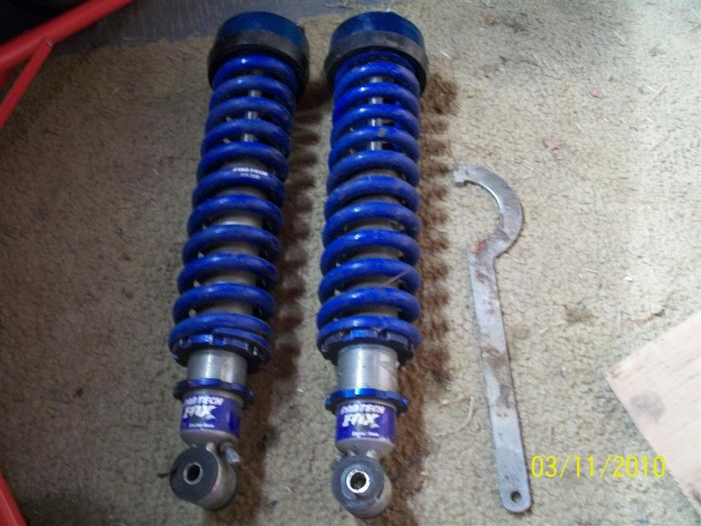

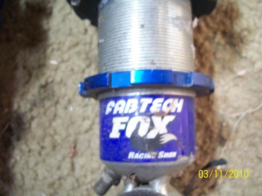

    i found a set of fabtec coilovers on craigslist for 300 bucks and i was wondering if i should get them for my dad. he just got an 03 prerunner and is wanting to lift it a little, they say fabtec/fox but they have an air valve on them? does anybody know anything about these?

    that valve is for the nitrogen, if you buy them take them to a off road shop and have them check for nitrogen. If they are empty they will blow your seals, hell if you buy them have them rebuilt.
