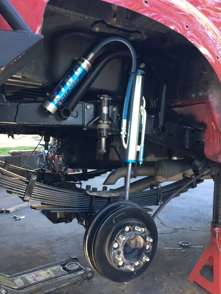

    Another question. What if I wanted the mother of all rear shocks on there? Could I be helped out with that also!!! Dude you are a wiz kid with this stuff

    Oh you mean like this :anonymous:

    Yeah something like that!!!!! Brilliant!

    Oh such a beautiful sight
