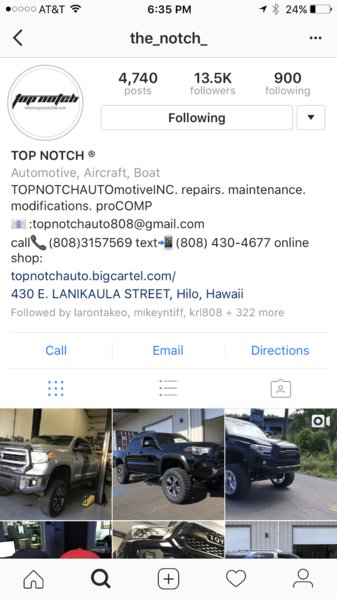

    I've had king coilovers on a fab 6 truck. If you call them, and tell them you want kings for a fabtech lift, they will put a longer rod on a 2.0 coilover. I know Icon also makes a coilover that fits fabtech lifts for 95-04 models. A lift shop down here in Hawaii, has made a a full length bilstein coilover for fabtech 95-04 as well. Lmk if you want to get in touch with them. They ship world wide and it's the most affordable. $950 for a full length coilover. Versus Kings which will cost you $1200+

    I'm not sure on the part numbers. Here is Top Notch contact info. They have a better break down of it for you. To me the bilsteins can keep up with your style of driving. For sure IMG_2409.jpg
